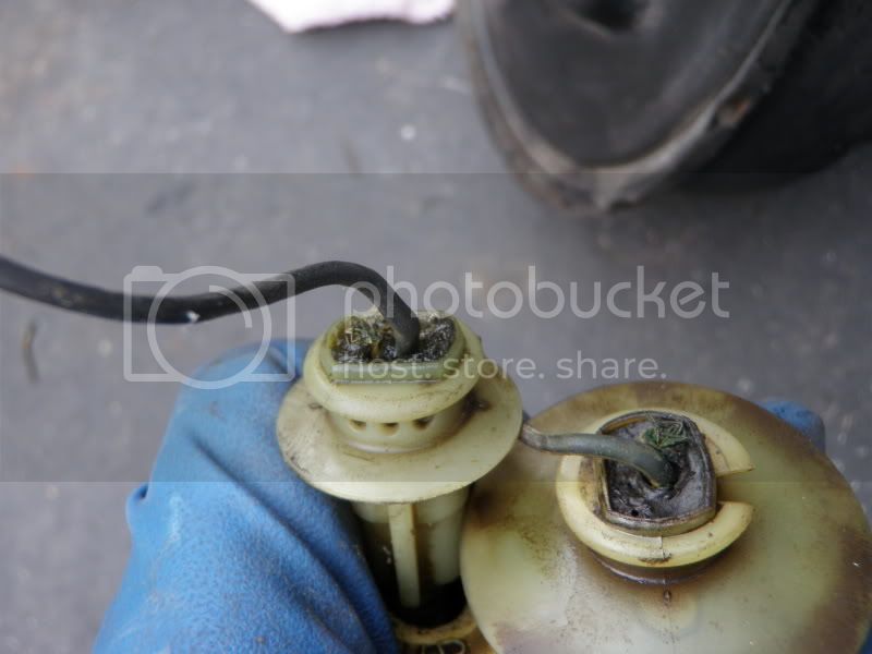

What are the extra two wires coming out of the side of this T100 master cylinder reservoir?
Looking at the FSM wiring diagram I see only two wires which trigger a warning light if the fluid level gets too low. These wires and switch are not the ones coming out of the side. The factory switch is integrated into the top cover. Both my old top and the new top I grabbed off a FJ80 in the junk yard broke as seen in the below picture.
Can anyone explain the wiring and extra switch in the 1995 T100 reservoir?
Can I somehow not use the top stock switch since I broke it or do I really need to get a replacement to be safe?

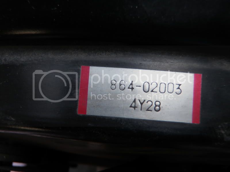

T100 Master Cylinder Part Number

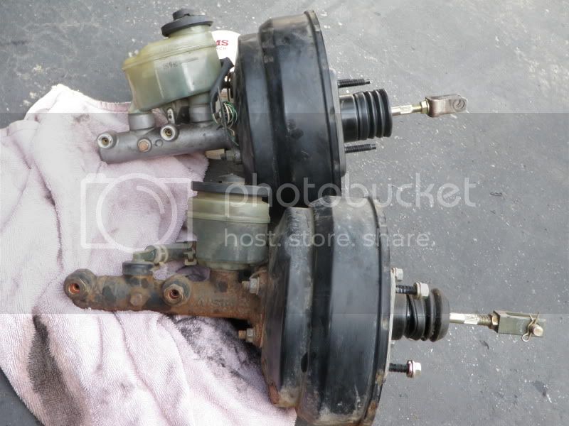

Obvious volume increase between cylinders

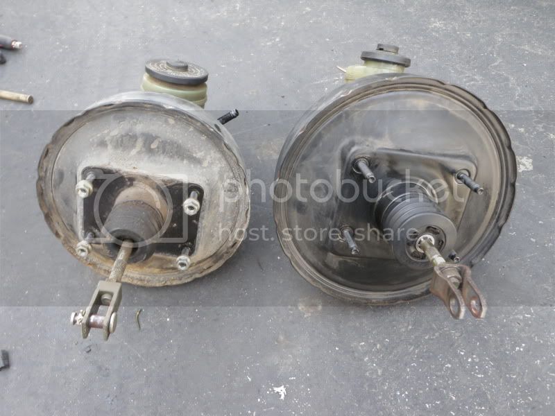

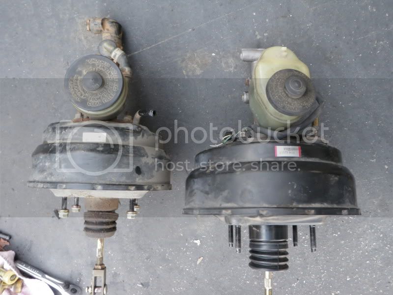

Another View
The master cylinder will bolt up to the booster ( black base ) no problem. You'll have to bend the outer brake line slightly to make it fit but you shouldn't need a tool to do so. Bending slightly by hand is fine.

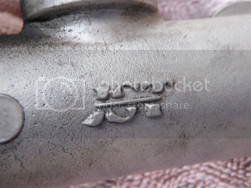

While we're talking master cylinders; anyone know what this brand is? It's on the side of the casted T100 master cylinder:
