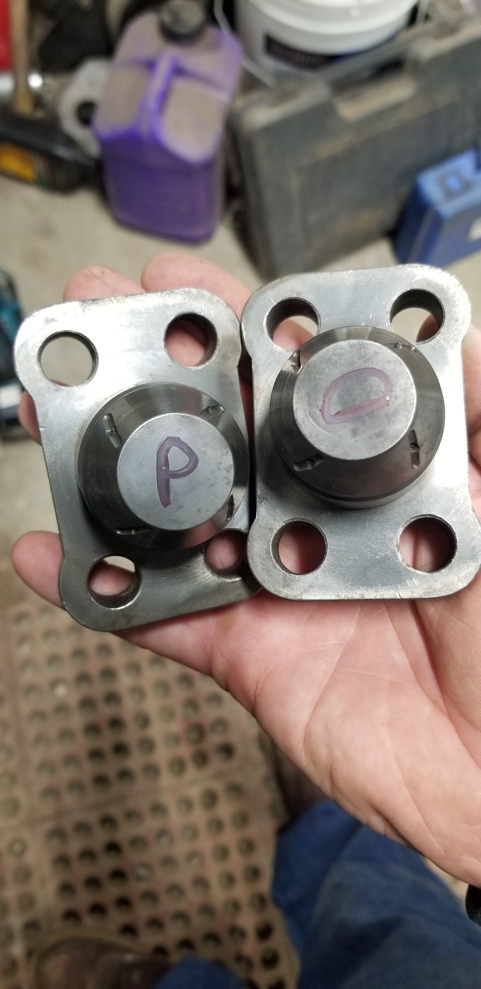

My buddy has these for sale. I think it seems like the most bullet proof upgrade as there is nothing to fail. Shameless plug below
Thats a pretty hardcore option. Dunno if I'd daily those. Robust, but not sure about how they'd wear, if you'd be chasing preload, if the steering wheel return to center would be stiff. You'd have to be one with the grease gun for sure.
One of my local wheeling buddies has them on his 85 Xtra Cab. He has had zero issues in many years. They need to be set up properly just like the bearings do. Get it too loose or too tight and you'll have issues.
