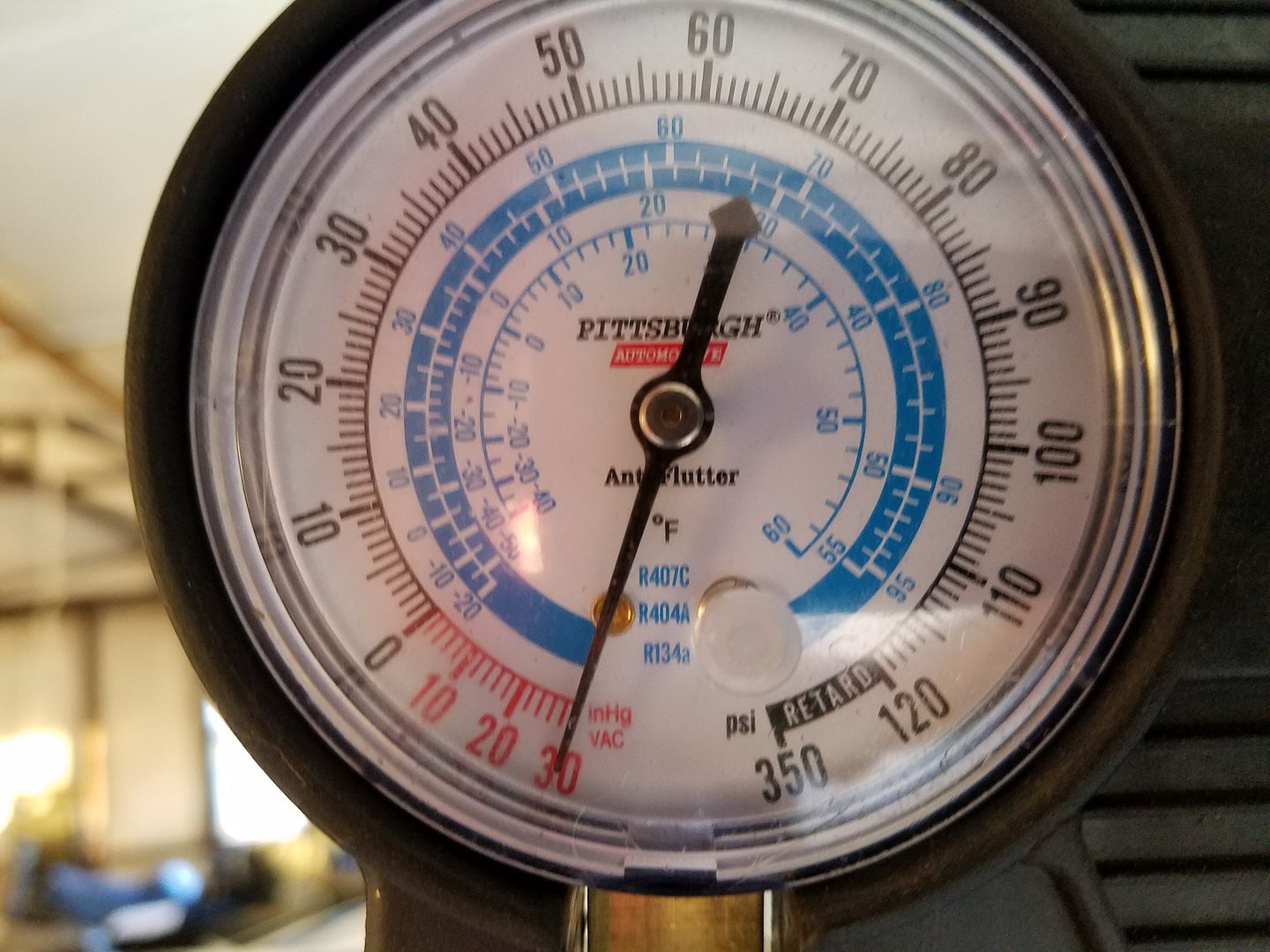

AC Lines… I got ready for summer by getting the AC operational on the LX450.

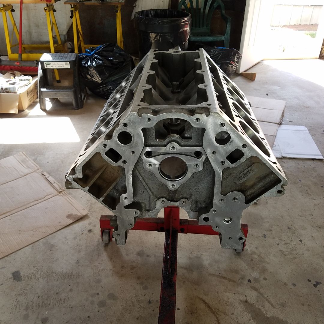

Had a spare L33 laying around and decided to rebuild it.
Back from the machine shop..

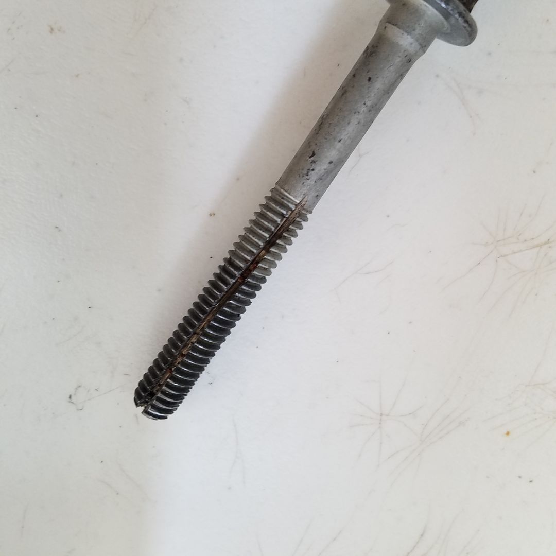

Reworked an old head bolt to chase the head bolt threads.

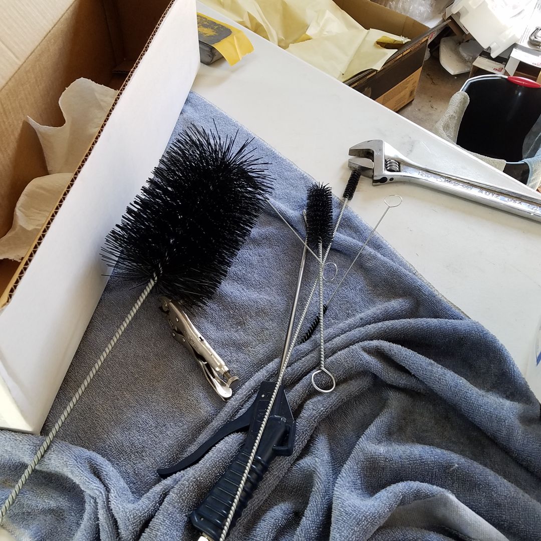

Cleaning tools..
