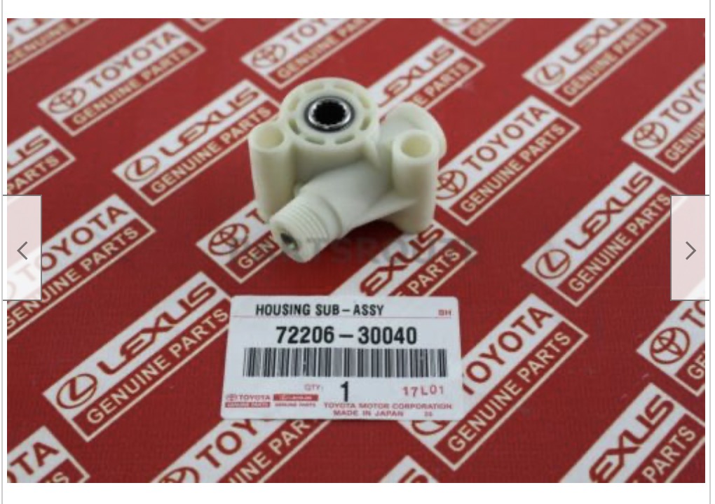

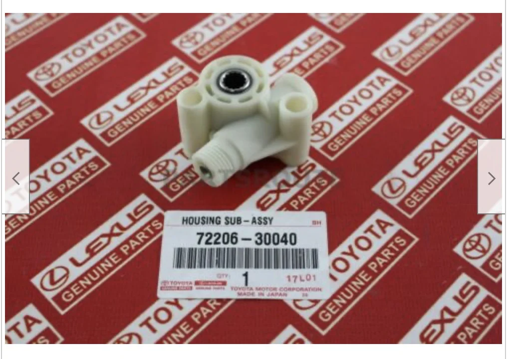

I have just developed the power seat problem on the passenger side of my 96 80-series. The seat is stuck in the forward position and will "try" to move back with the outter rail working and the inner rail kind of skipping before it fizzles out all together. I need to replace this, right? But what's the gamiviti part that is mentioned?

I have just developed the power seat problem on the passenger side of my 96 80-series. The seat is stuck in the forward position and will "try" to move back with the outter rail working and the inner rail kind of skipping before it fizzles out all together. I need to replace this, right? But what's the gamiviti part that is mentioned?View attachment 2891567
... I'm still not clear as to whether I need the Toyota "housing sub-assembly" shown in the picture OR if the Gamiviti gear replaces the gear inside the sub-assembly I already have. Thanks again.
Scroll all the way to the bottom of that web page and you'll see that Tim put together a video that shows you how to replace them. There are also instructions that he has included. This might give you a better idea of what you need.
