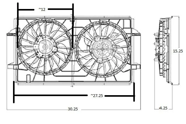

One of the fans I came across was the 2008-2012 Chevy Malibu V6 FAN. Its overall size was a pretty close fit 27.25 Wide x 15.25 Tall, and the mount points looked good. I’ve heard that TYC products can be a bit bad but ignoring my own better judgment I ordered a TYC 621790 Cost ~$95 shipped. (http://autoplicity.com/products/4469546-tyc_621790_products_cool_fan_assy.aspx)
The FAN was received with damage due to the crappy internal packaging by the manufacture. Autoplicity had nothing to do with this, in fact they gave me a no hassle full refund. While I had the part here in my shop I decided to take a few pics of it and I chatted with a few folks on the Malibu owners club. They gave me a handy wiring diagram. From the diagram I found out Fan 1 needs 30 AMPs and Fan 2 -15 AMPS but they could not tell me the total CFM of the fans. Currently I’m guessing them at about FAN 1 2500-3000 and FAN 2 1000-1500 but I have a CFM meter on order and will gauge them soon. According to the wiring diagram the fans run in series for low speed and then independently for high speed. For now here are some pics and I’ll post up more information later.

I got a good look at the Malibu FAN setup and it would not be possible to swap the slower fan for a faster one. The mold on the shroud it made specifically for the fan it is intended for.

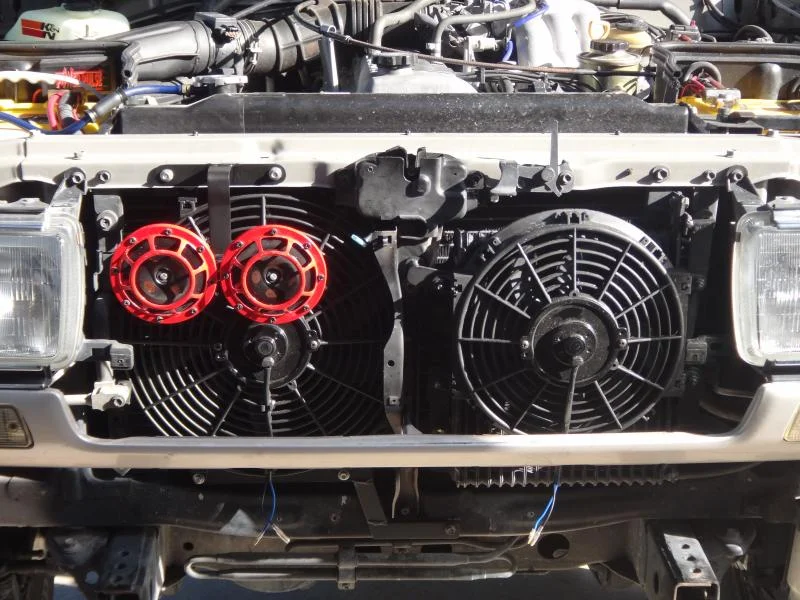

Billy - Nice PICS on the other front FAN setup

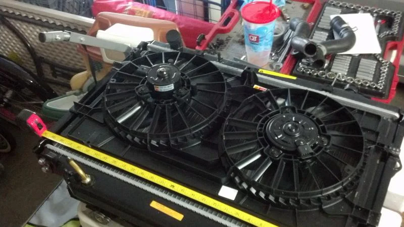

Thinking about this a bit more I believe I am going to go with a custom shroud with SPAL fans... but we'll see...
