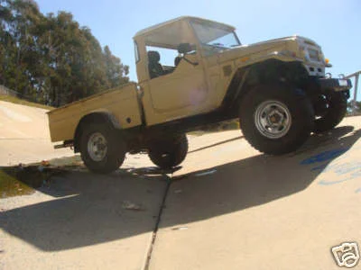

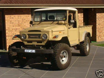

what about 60 series diffs under your 40 or 105 series diff under it if you can get hold of them .The track width tricks the eye because it has the aftermkt wider front fenders on it
that is a great looking cruiser, where did you get an after market wider fender? i am gonna need one after i do my conversion. also i am thinking of an 80 series because it is wider, did you mean 100 series, do you know anyone that has done this conversion? what is the difference in the wide and the location of the differential between a 80 series and the 100 series... thanks

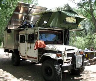

thanks called him left him a message. Fj404life posted a picture of my cruiser above (thx fj404life) as you can see the rear of my cruiser is 80 inches wide, i am trying to get my wheelbase to match that wide. which mean i also need to widen the axel front. my front wheelbase is currently 4 inches wider than the rear and i want to keep it that way. which mean i will need to widen each of my axel shaft and housing by 3 inches. with my tire wide included this will get me to 80 inches wide in the rear and 84 inches wide in the front.
with this set up i will also need to widen my front fender by 6 to 7 inches
thank you all, very helpful :bounce::bounce2:
here is the new look of the Nulla, as you can see the pop top now open from the front with an all new aluminum "camper shell". we plan to get rid of the roof ten once we are done enclosing the pop top, we realize that it is not really needed for two people the pop top is sufficient for now. it is a very comfortable tent and has served us very well.
we are now focus on widening the track and this tread has been very useful thanks :bounce::bounce2:
