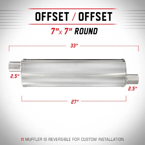

I was doing some mud research on a MF exhaust setup and found your old post. If I'm not mistaken, I think the muffler is the Magnaflow 13746 XL Stainless Steel 2.5" Round Muffler. What do you think? This is what i'm going to go with and have the piping rerouted over the frame. It's the largest MF muffler body that I could find... I like to hear the music instead of exhaust drone but I also enjoy the audible throttle response during acceleration. Would you be able to post an audio clip for reference?
-I had a Flowmaster Cat-back System with the 70 Series muffler on a 4.0L V6 T4R and it actually sounded great for a V6 but still a little much at cruising speed. I'm still going back and forth between the two options.
T4R FM Exhaust clip:
MF Muffler info...
PART #:
13746
DESCRIPTION: Inlet/Outlet Size: 2.5in./2.5in.
Body Shape: 7in. Round
Core Size: Dual 2.5in.
Body Length: 27in.

I'm not sure if that's the muffler. I can measure it this weekend and get back to you.
It's pretty good and sounds good, I think better than that video clip.
But there is drone at freeway speed. My wife doesn't seem to notice or be bothered by it.
Not significant but louder than stock.
It could also be because my tailpipe is cut short of the body, so the sound is bouncing under the truck, instead of shooting directly out the side. I plan to extend the tip to clear that up.
