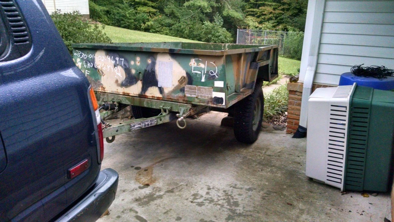

I've owned an M416 that was in pretty decent shape (but had some issues) for a while now. However, I was getting to the point that it was just too small for me. I would have loved to have kept it, but I don't have room or a need for two trailers.
So, after a few weeks of looking I found a guy about an hour from me that buys and sells a lot of military trailers as a side job. We worked out a deal and he ended up with my M416 and I ended up with one of his M101A2's (a 1990 model). Overall, it's in great shape, only rust is a little surface rust on the nose of the trailer, but there isn't a trace of rust anywhere underneath, on the suspension, or through the bed. Tires are almost new, parking brakes work great, surge brakes work great, front and rear factory landing legs are in place, and basically everything that it was built with in 1990 is still attached.
I already rewired it to run on a 12 volt 4 flat plug and was able to make it look pretty original by reusing factory mounts. Other than that, I don't really have any special plans for it in the immediate future. It will be used for general hauling purposes and I'll be taking it as a base camp setup on wheeling trips.
I'll use this thread to keep up with what I do to it and as a place to ask questions.
It's been raining non stop for 3 days, and it supposed to rain until Friday. I hope to be able to pressure wash it and get it cleaned up next weekend. My dad has a sandblast booth at his shop, if I ever get fancy and decide to paint it...

So, even though the tires looked good, one was original to 1990 and one was 8 years old, so I went ahead and replaced them. I went with the 10 ply trailer tires in the OEM size. The reality is this trailer will be used for hauling on paved road, the farm, and fire roads 90% of the time. The other 10% will be on easy 4x4 trails and then get dropped at a base camp.
Yes, they are Chinese tires, no I don't care. For $200 out the door I'm not that concerned and I will have a spare with me. My brother in law has put 10000 miles on a set of these on his 47 foot horse trailer with living quarters. I figure they will age out before I have any issues.
