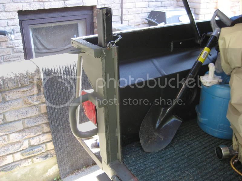

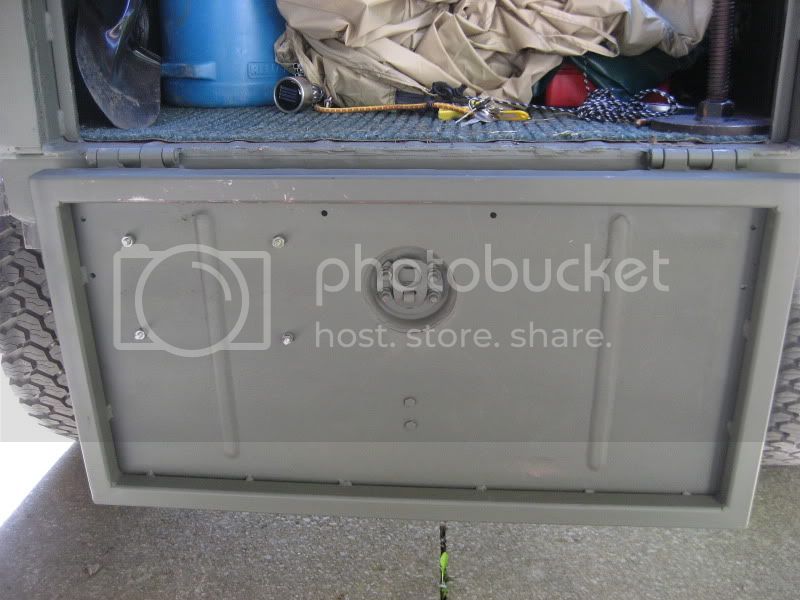

Hey Swampman,
Do you have any pictures on how you cut in the trailgate? It looks real clean, do you have chain to keep it from falling down? How do you keep it up? Latches... Does the top keep it up when closed. I like it alot!

Hey Swampman,
i got a couple of pics.. no chains i have a stick to keep level when open or drop it all the way down .. whichever i need at the time, it is held closed by the lip on the lid . it keeps the rain out too the tailgate is framed with some square tube.. the opening is framed with 2'' sq tube cut thru the floor and welded right to the frame as well .. then my support legs are inside of that
