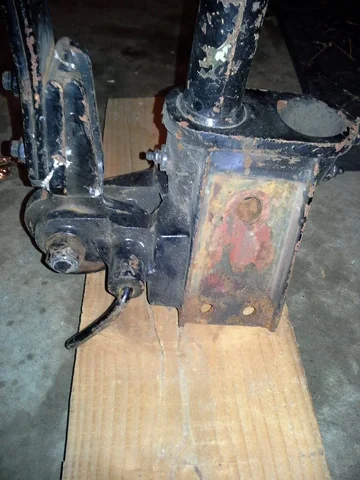

I have available the full coupler assembly (lunette/casting/landing leg) together and ready to be bolted onto either an M100 or M416 (I think it's the same bolt pattern). When I replace the axle, I'll also the axle/springs/hubs and two wheels available. I'm trying to decide whether to sell each of these as two assembled packages or part it all out.

I'm on several forums related to this project. There's a lot of conflicting information regarding M100/BantamT3C/M416 part compatibilities. I've done a little internet research including various forums, supplier websites, ebay, craigslist, et al. Parted out to private parties, the assembly pictured here would bring around $585. I'm asking $450 cash, you pick it up and part out what you don't need. That way, you can confirm it's the right unit before paying and that's best for everyone. You get what you expect and my reputation as an honest person remains intact. If you want it shipped without personally inspecting it, we can talk, but the risk is all yours.
