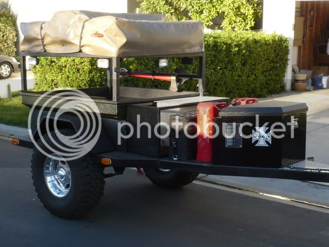

Bought some 33's on rock crawler wheels, added rancho shocks, put new led lights, painted frame, NOS springs with all new shackles.

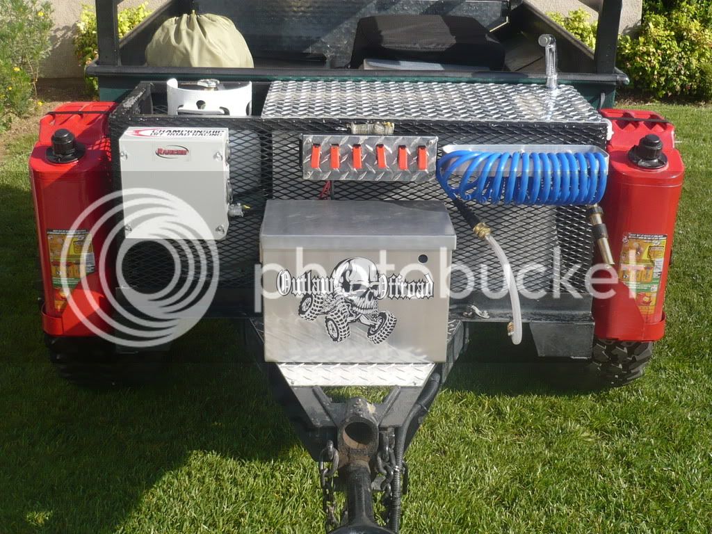

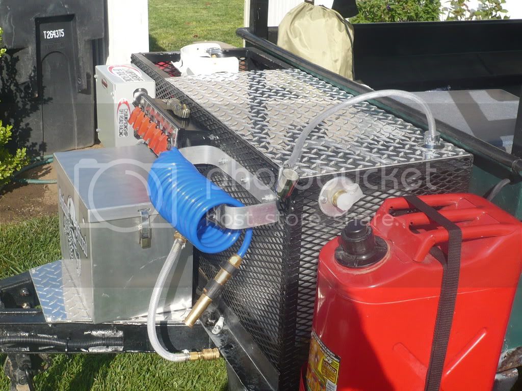

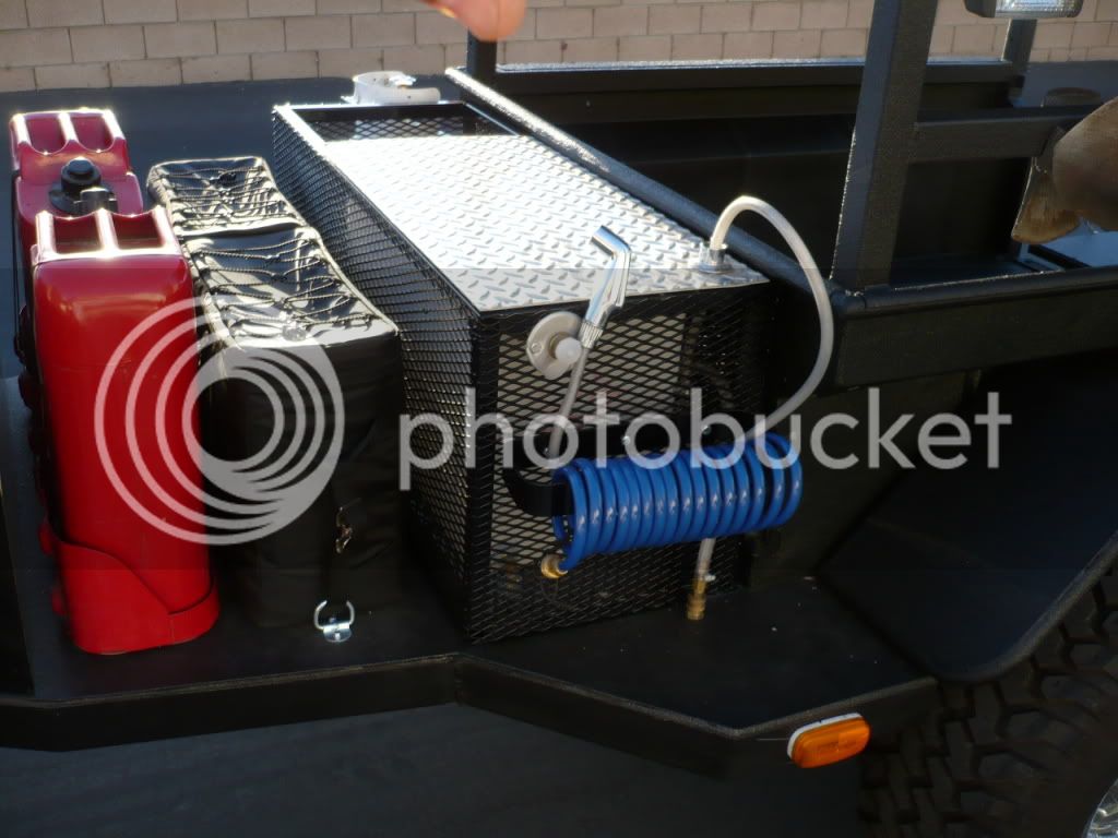

Here are more recent pics of the trailer. I rearranged the front box and put a water tank, 2.8 gpm pump, faucet and hose. Also wired 6 lights and put a switch box in.

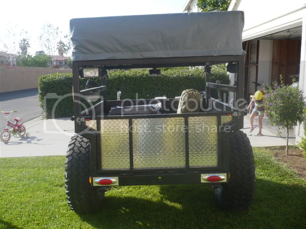

Almost done with this build. Here are some recent pictures. Here is a list of what I have done thus far:
- 3500# axle with electric brakes, 5 on 4.5 with matching jeep wheels
- Wired all trailer lights with reverse light on trailer.
- Tub sand blasted
- Added Tradesman Tongue Box
- Pre-wired Blue Sea 6 switch board (4 perimeter lights switches, 1 water pump switch, 1 stereo switch.
- Junction Box for trailer wiring
- AGM battery with separate disconnect for switch panel
- Battery charger with shore power
- Tongue Jack
- JP rectangular cooler
- 19 gal water tank with Shur-Flo pump, pressure hose & faucet
- Propane tank
- Line-X on all surfaces (top if tongue and side steps, fenders, inside of tub, outside of tub to match jeep green, tent rack & back of tailgate.
- Had front box that holds water tank powder coated.

Does the battery charge off of your Jeep while it's hooked up...and then how many battery hours do you have once it is unhooked from the Jeep....Sweet lookin rig...where did you get the water pump from....have you thought of making a seperate intake line where you could put it in a stream or hook it to a water supply and have your outdoor shower....thanks for the info
It will charge off the jeep, but it is not hooked up yet. I ran all the wires for the jeep to charge the trailer battery, but I am waiting to buy a good isolator before I hook it all up. I bought the 2.8 gmp shurflo pump on e-bay. I have not thought about that, but it can be done easily by adding a seperate intake like you said and maybe adding a valve. Good thought, I just may do that.
