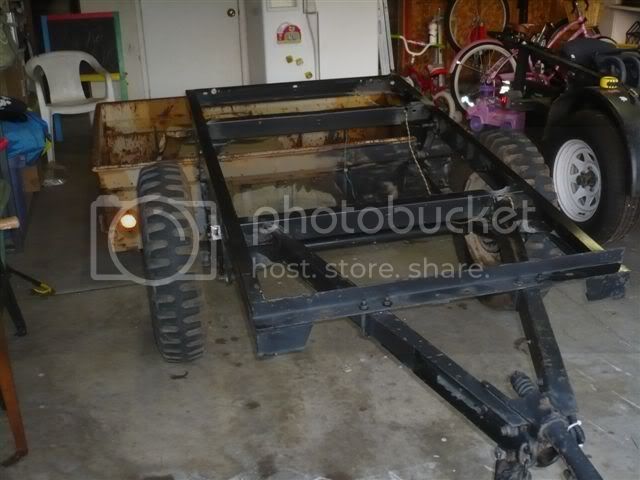

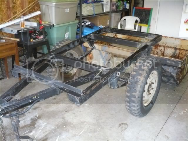

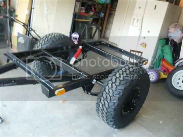

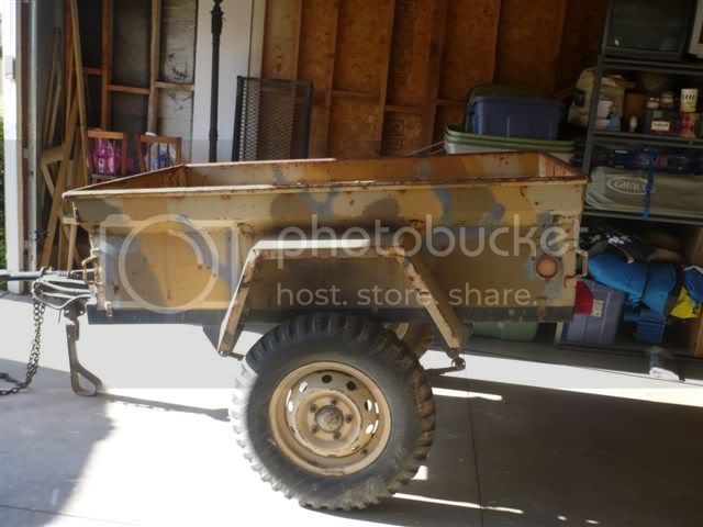

Here is a M-416 build my cousin and i started a few months ago. It is still in progress. I purchased the trailer for $300. I got most of the ideas from this site. Here are some pics of what i have done.
Bought some 33's on rock crawler wheels, added rancho shocks, put new led lights, painted frame, NOS springs with all new shackles.

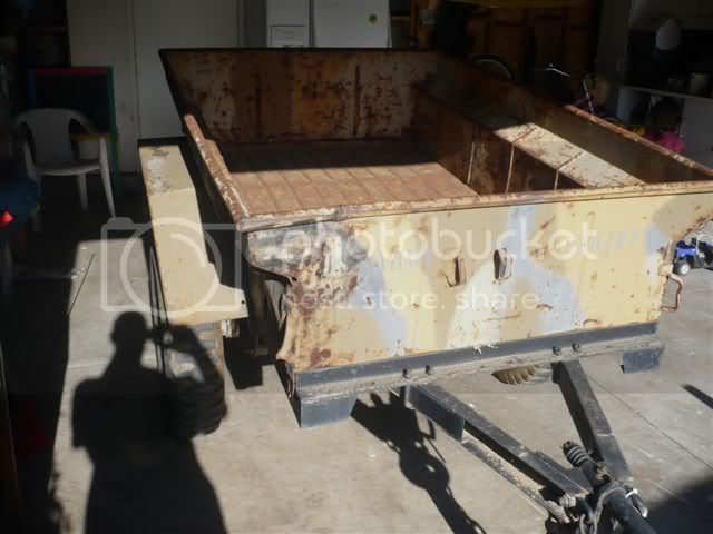

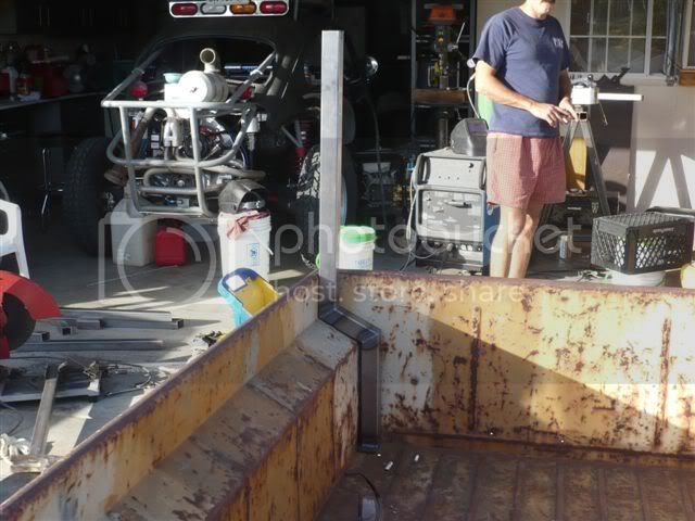

Yes, it is a jeep :). Focus on the trailer. Here are some pics of cutting the tub. There was some damage to the front of the tub. So we decided to cut about 16 inches from the front, rotate it 180 degree's, and fab a tailgate and storage box for the front.

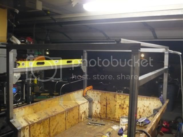

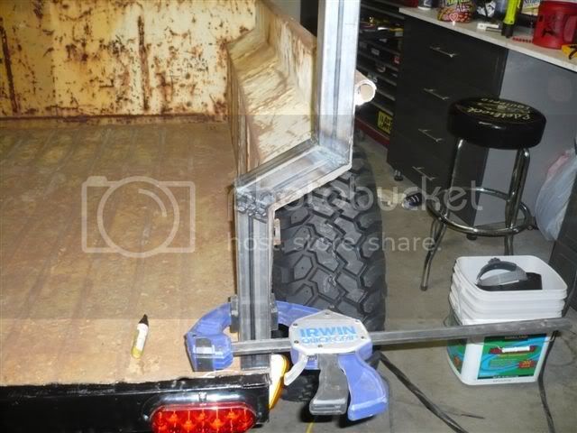

I bought a roof top tent so we decided to mount it on a 1 3/4" square tube rack. I also put some tubing to hold a shovel and axe. The tubing follows the contour of the inside of the trailer. We did this because we needed to support the flimsy tub and have a place to mount tailgate latches.
Man that looks great! And GOOD on ya' for gettin' your boy involved. Love that pic of him with the hood on!:D
I really like the idea you have of adding a box up front, and your method of how you are going about it is really, really cool!
Sweet rack too! Keep it up and keep the pics coming!
Drew
Thanks. That is my cousins kid and he is actually showing my cousin how to weld. We changed the rack after the last picture because it was way to high with the tent on. So we decided to lower it. I will add more pics this weekend. It is painted and the tailgate and front box is complete.

great job, but aren't you afraid of the topweight??
I saw pictures of a 'normal' M416 that turned over in the desert just because one wheel felt in a hole.:whoops:

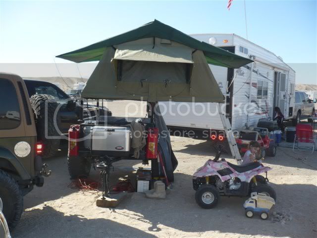

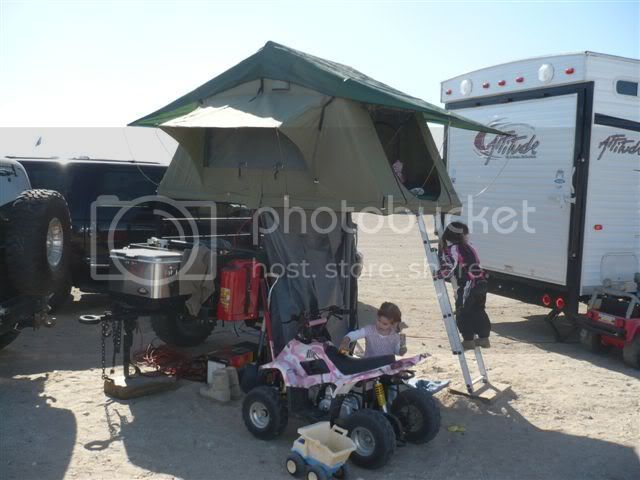

We ended up lower the rack after these pictures. The top now sits where the middle cross-bar is in the picture above. I did not want the hassle of having a closed lid so I would have to lift the tent every time I wanted something out of the trailer. Also, my daughter's quad fits nicely under the rack.

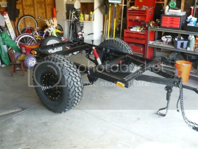

Here are some pics of the trailer. The fenders are still in progress. I put a AGM battery that adventure trailers recommended. Also, I wired a battery charger with an external plug and 4 -12 volt plugs for accessorries, it is that grey box in the front. Mounted two jerry cans. I am still going to wire some flood lights all around the trailer,line-x the inside black and the outside to match the green jeep. I am also trying to figure out a way to mount two propane burners and a bar-b-q.

Are those feet to support the trailer on the rear on the last pic? I don't see them on the trailer pics when it's hooked up to your receiver. How are those mounted and do they help? Do you have front ones too?
They are removable stabalizers that are just placed under the rear bumper. They have a rachet strap that connects to the landing legs and pulls them together. I got them for the rear only and the they work good. The trailer does not move much when inside the tent.

There was some damage to the front of the tub. So we decided to cut about 16 inches from the front, rotate is 180 degree's, and fab a tailgate and storage box for the front.
Brilliant! I love the "inside" and "outside" storage idea.
