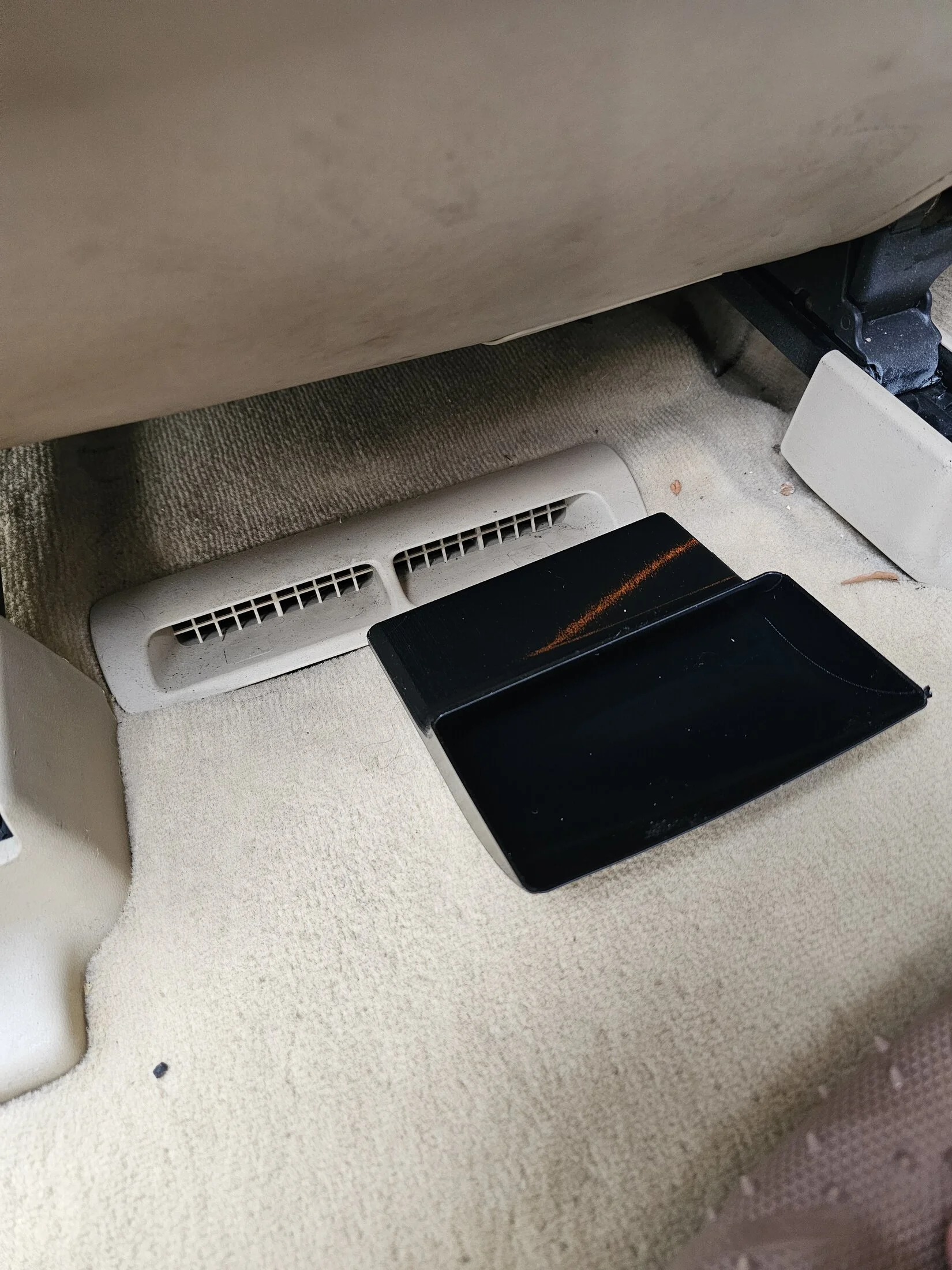

Bringing this post up from the past, but I came across this randomly today and I'm curious if those who've dug into the seats would think this might work in our 200 series?
Here's another one for the GX460 on Etsy, shows how it might work.
"With Dust Deflection" 😄
I guess a simple look under the seats of my 2010 probably could have saved me the trouble, but definitely not close to the same size. Concept is interesting, and I'm sure someone could create this easily with a 3d printer in a size that would fit.

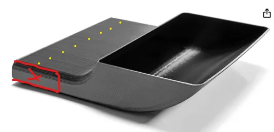

Just a thought, if you got it for a decent price, what do you think about trimming the sides like below? Is there room underneath the existing vent to slip it into place? I envision doing this, and blocking off the remaining air vent area, possibly drill/rivet it into place to keep it there. Or use a heat gun to soften the portion above the cut section and fold it over underneath to enable it to lock on without rivets?
Is the direction of the air flow with this in place positioned well enough to align with the seat fan?
The way it's setup it's way too small. I believe the cover is divided to direct air in different areas, but I think it's just one duct underneath there. To install I believe you would take off the cover and replace it with the unit. I could probably find a way to make it work/fit, but I think I'd look for one that's a better size first.
