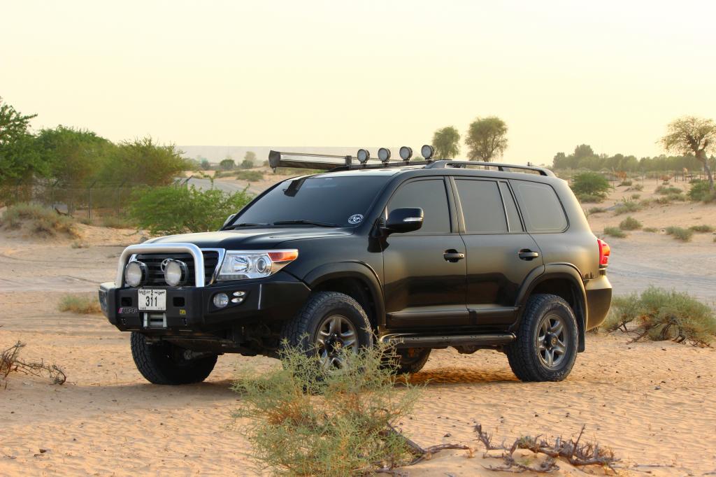

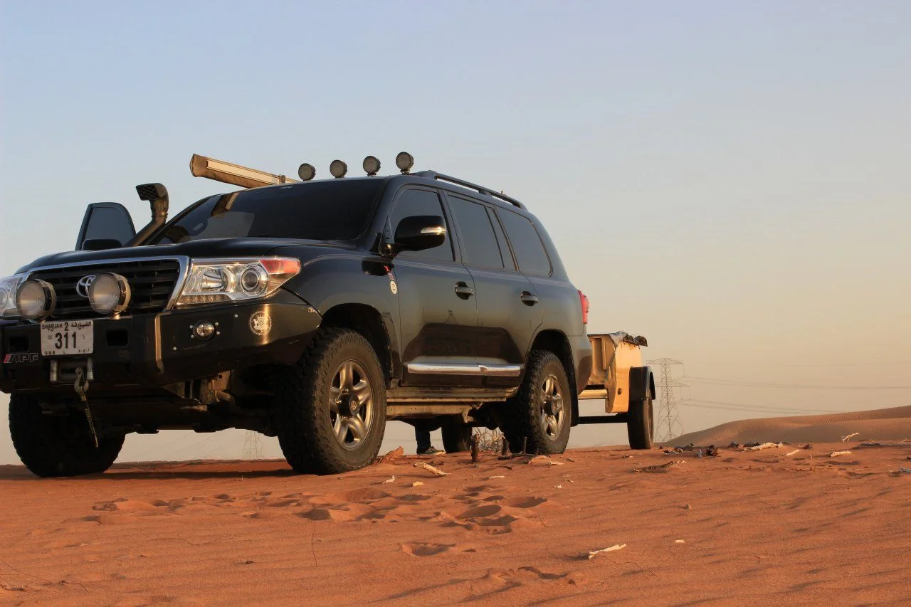

I wouldn't really call them body panels, the gcc cruisers we get here has the moulded side steps that the lx have, when I removed my side steps I had to order a pair of rocker covers that were approx $300 - $400.
1st pic is of the moulded sidesteps, 2nd are with the steps removed and 3rd is with the rocker cover installed.
Ok, so I understand. You need the LC parts to cover where the mounded steps come up on the fender wells. That makes sense but is still a bit of a pain, when the sliders will easily be a grand by themselves. Plus you then need to color match the new LC parts to the faded LX color to look right. I can see this option adding up fast.

When I checked the US prices I was a little shocked as it was around double the price I paid, I only did a sidestep delete and months later put on the rocker covers which is why I didn't have to think about the cost.
What you could try "unfortunately works better with black" is unbolt the side steps and see what it looks like, if the exposed panel doesn't look too bad you might be able to slap a slider on and leave it like that.
