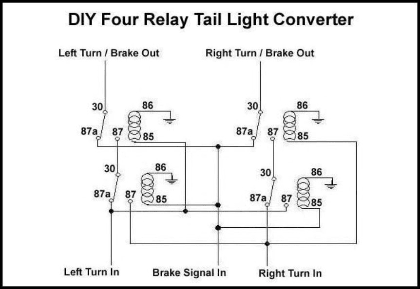

The light does look bright enough, but I have been trying to think of a way to incorporate my bullet LEDs in the bumper as turn signals as well. I know I could set up a 5-pin relay as normally closed with a power source to them, then run a line from the turn signal to the relay coil to turn it off when the turn signal flashes on, making it flash in reverse with the marker light turn signals.
The only problem is I don't know what wire to run to them for always-on (with ignition) power. Any suggestions? Currently the bullet LEDs are wired to the marker light circuit so I guess I could just always drive with headlights/markers on..
I am no electrical engineer nor electrician by any means. However, it sounds like you want the front Bullet LED's to act in a very similar fashion to a trailer tail light converter. The brake light will act like the running lights and the signal lights will take precedence over the brake light and actually flash when you are signaling. You might need to replace the turn signal relay with one that compatible with LED's so you don't get hyper-flash syndrome. Will this work? Hopefully somebody else "in the know" will chime in.
The relay I have is a lot like this one:
Wired thusly:
Always on power (currently marker lights) --> 30
87a --> LEDs
87 --> unpopulated
Turn signal + --> 85
86 --> turn signal -
I'm not sure there's a better option for ignition-on power in the area. Running lights are off with headlights on, and headlights are off with running lights on, so nothing up front is always on -.-
