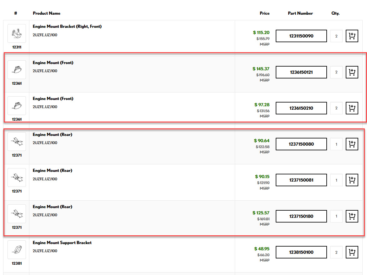

Hi, I was looking for engine mounts and transmission mount on Bell Lexus and there are slightly different part numbers and different prices. Are they different because they're for different years? Have a 2007 here.
Use your VIN and you should only get one part number.
