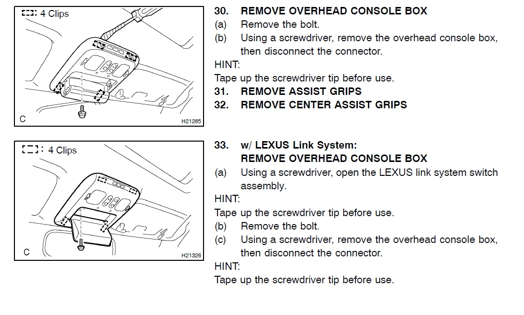

2007 LX470. I have water leaking out of the overhead console today. Wanted to open it up but could not get it out. I got the 4 clips popped out but it still will not drop down. What am I missing?

On 98-02's, there is a screw accessible under the Homelink button panel.

I installed the newer overhead with homelink and sunglasses holder on my 98 and it still uses the screw it’s in the sunglasses holder compartment. But that’s all there is. Some wires are short the plugs for various electronics. But that’s it. 4 clips and one screw.
