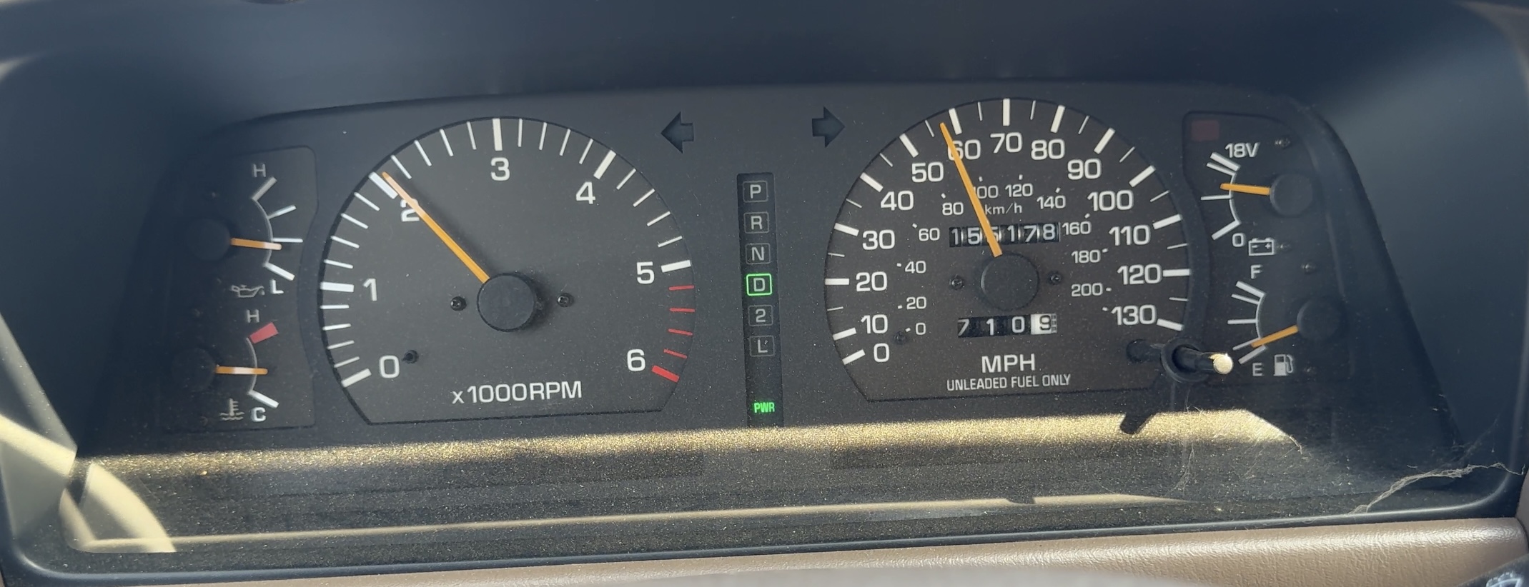

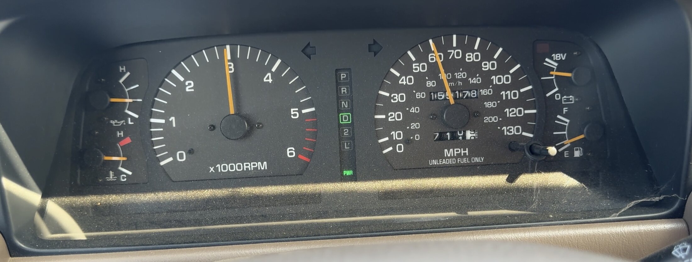

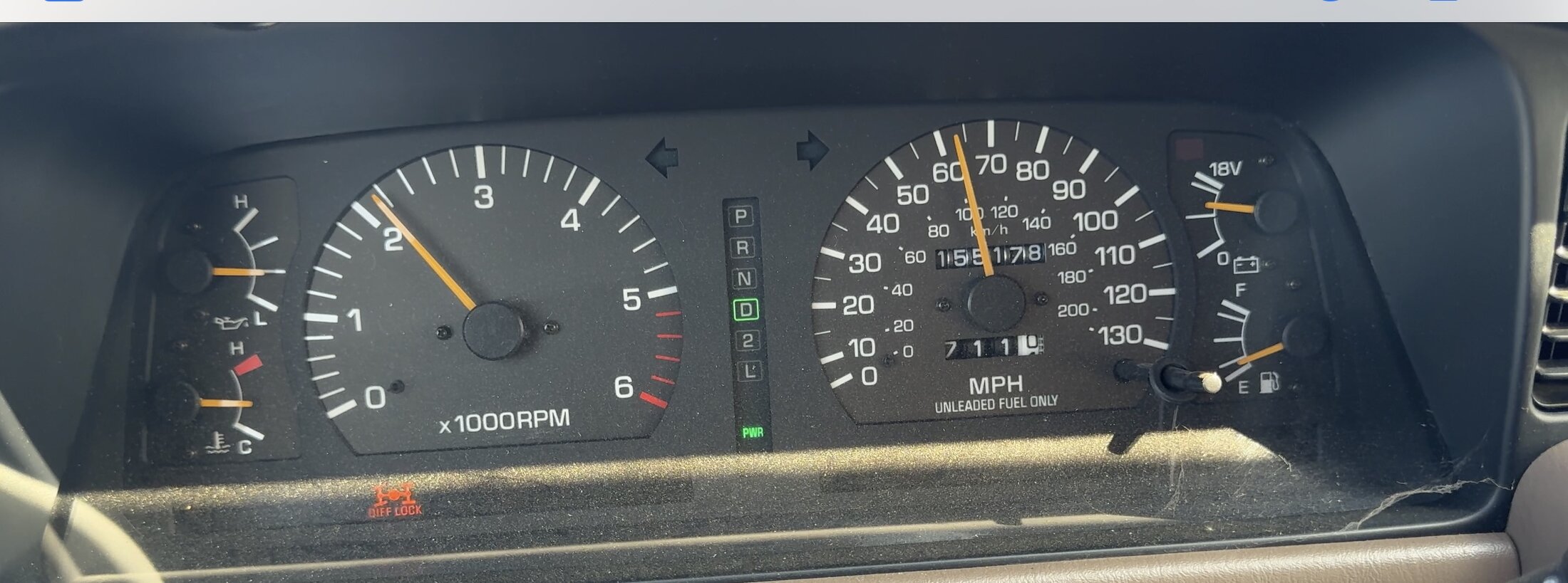

I don’t know how to post a video but here are some pictures in series. You can faintly hear the gear noise/vibration in these moments and see the dash light flickers.
The axle lockers work great and low works fine. Seems to be in high and noice vibration noticeable at 40-75 ranges. Center diff light flashes erratically from rolling through top speed.

If the CDL actuator motor was not in either the fully locked or fully unlocked position synced with the shift fork internal to the transfer case, it could cause grinding as well as an intermittent dash light.
