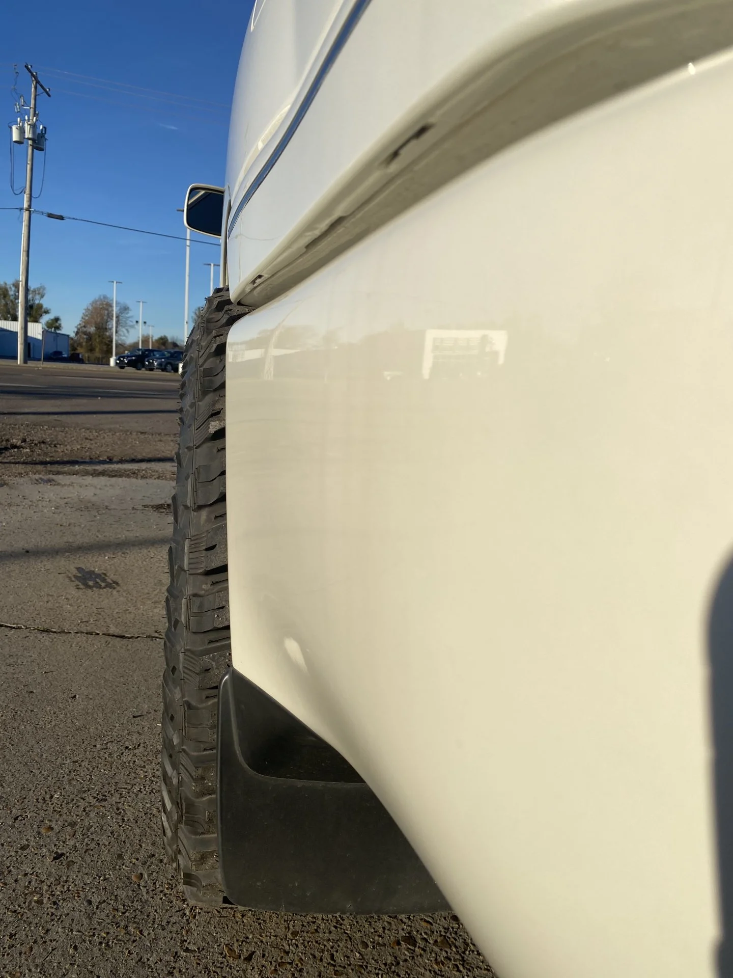

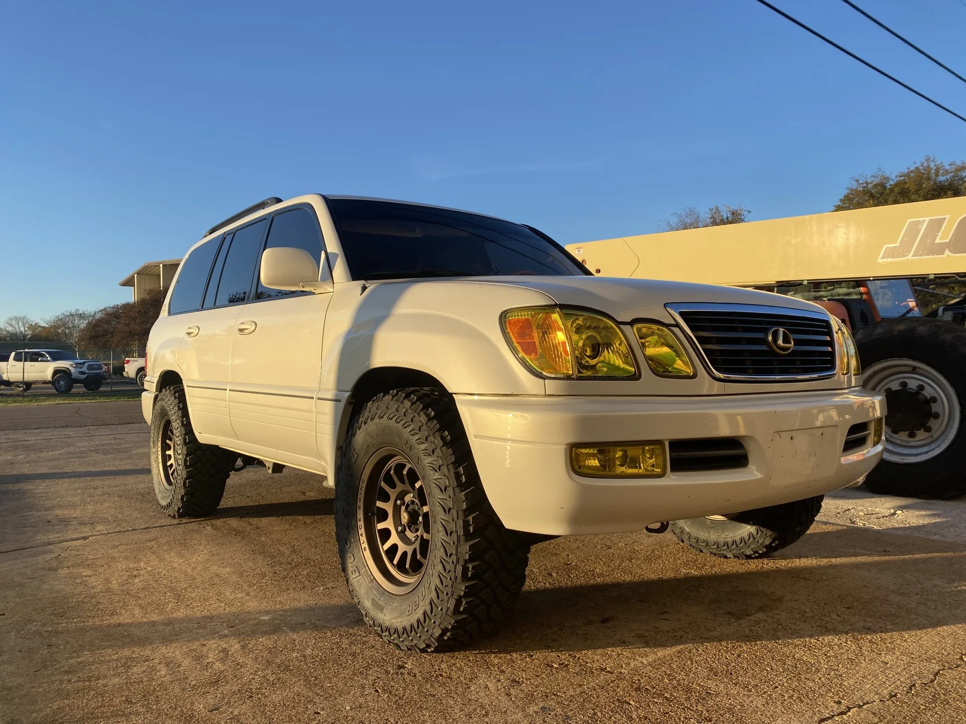

Thanks for the input everyone… I went with a set of Black Rhino Rapid’s in Matte Bronze; 17x8.5” 10mm Offset, wrapped in Maxxis Mudder 305/70/17 (33.8”) on stock height AHC.
There was some pretty bad rubbing, but most of it’s gone for street duty after pinch welds and smashing that plastic box under the front left well.
Going to get it on the fork lift tomorrow and see what it looks like!
Looks pretty good to me. I am thinking of getting the Black Rhino Stadium, same size, 17x8.5, 10mm offset, but a slightly narrower tire, 285/75R17, Toyo Open Country A/T III. I'd honestly prefer a little bit less aggressive offset, but Black Rhino does not seems to offer any alternatives. Also don't see many alternatives if you want a [rotary] forged wheel at a reasonable price.
