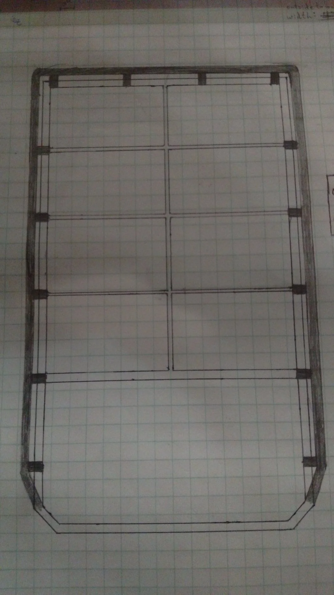

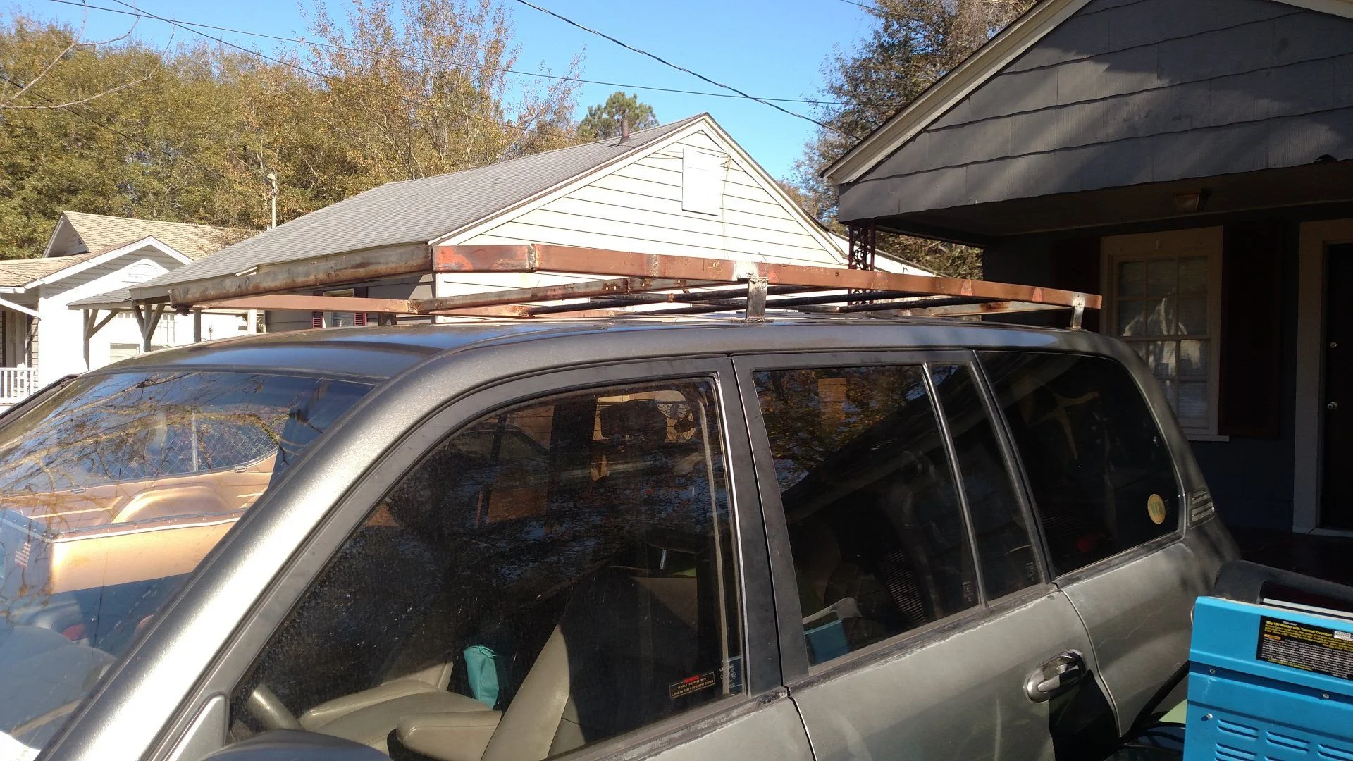

I must've went through a dozen drawings for the shape and layout, but here's the one I more or less settled on.

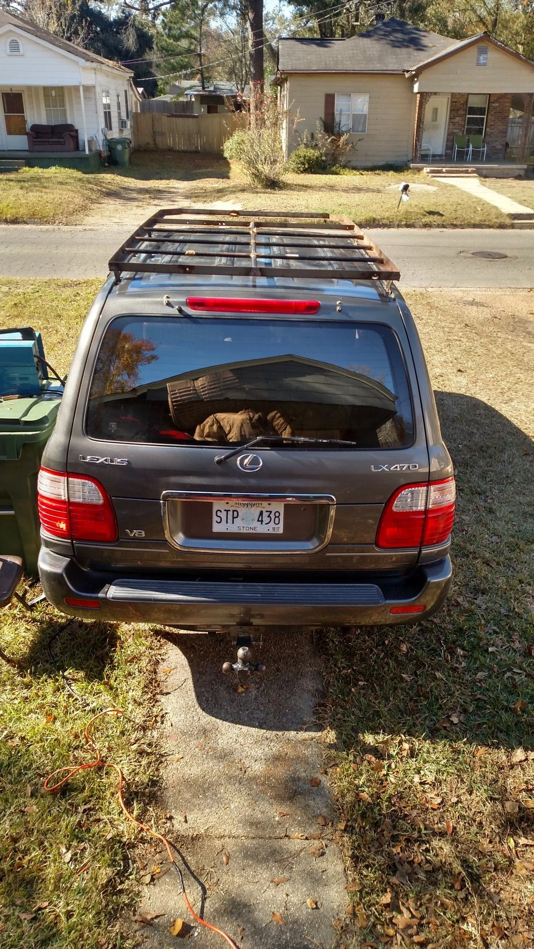

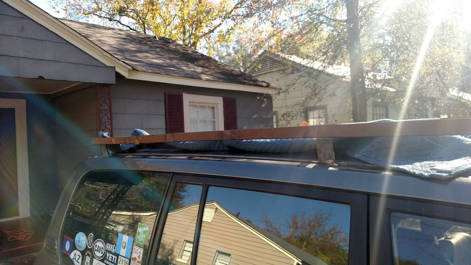

I reckoned the cross members would be positioned well enough to handle weight, and I would leave the front open for the sunroof.

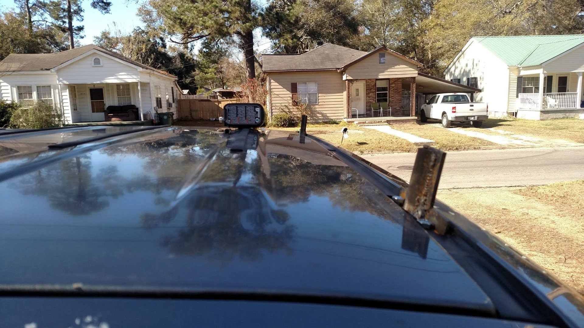

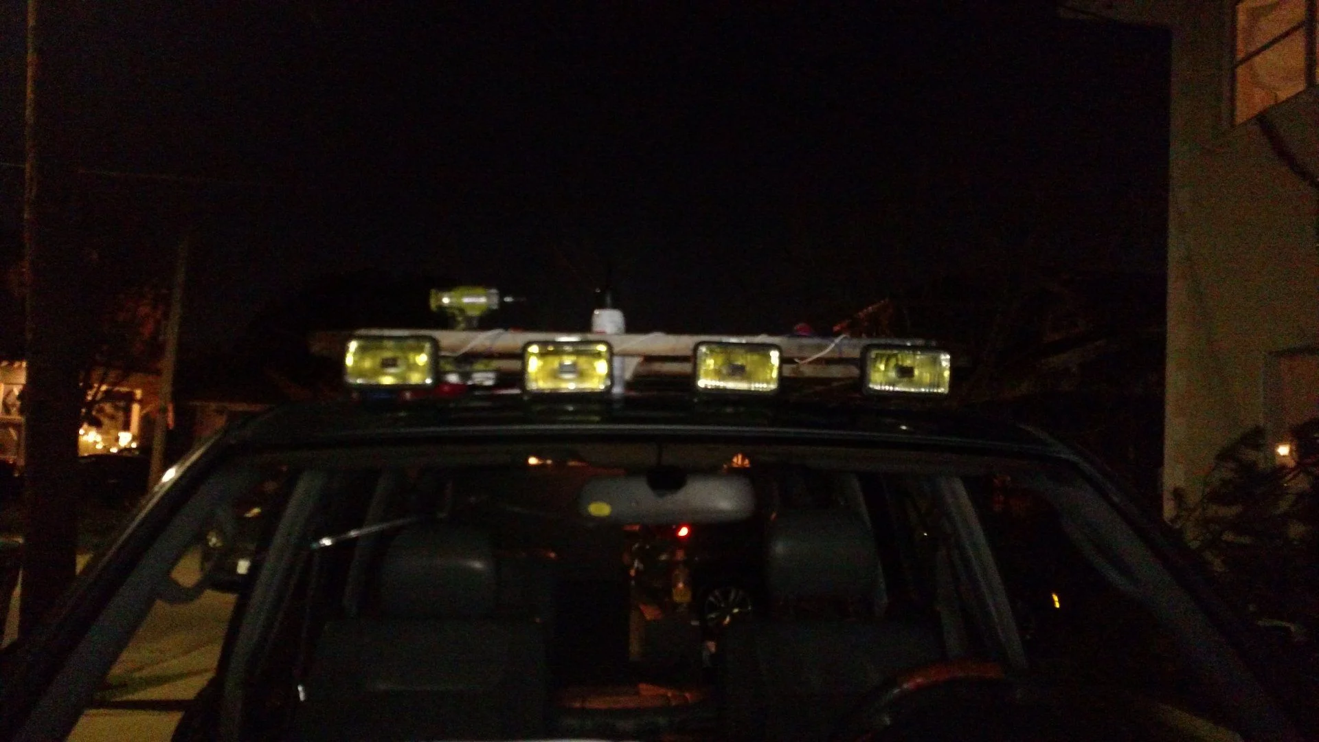

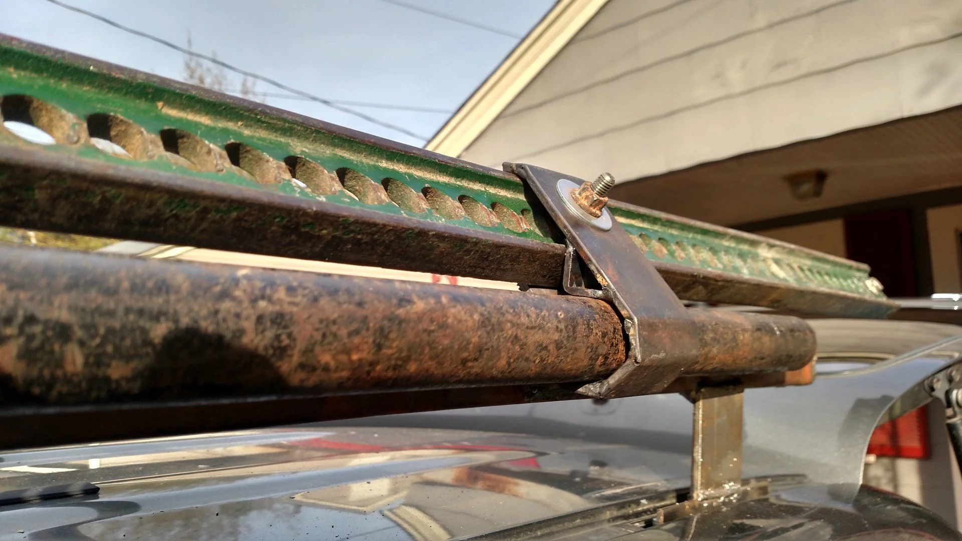

Those were the mounts I fabbed up, and they're solid. Next I wanted was a jack mount and lights.

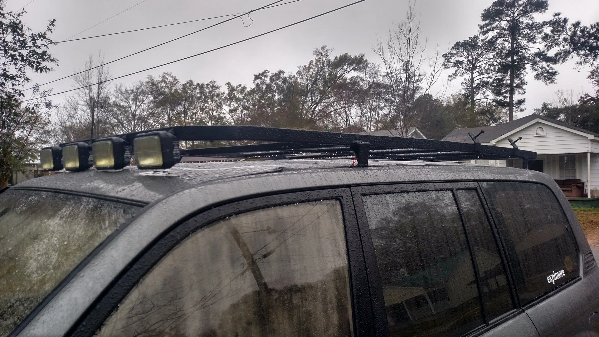

After driving it around for a few weeks, I decided it was time to paint(I'm sick of the rust...).

There's still more I'm considering doing to it:
-Welding a rail ~2 inches high on all but the front
-Putting some expanded metal across all of the bars except the sunroof
-Adding a 5th and 6th support
I'm not sold on the extra supports yet. I've climbed on top of it and stood in the center. I weigh 260 and it flexed less than an inch with all of my weight basically centered at the least supported spot, even with me bouncing. Leads me to believe it is plenty strong to hold a well-distributed load.
Again, I know it isn't the prettiest. But I have less than $150 in it, it doesn't make much wind noise, it's plenty functional, and it weighs less than 50 pounds if I had to guess. Let me know what you guys think!

Also, here's a better angle pic of it after the paint job.
Good on you for going for it.
A rail will help make it stronger as will a floor.
The unsupported weight where you installed the lights, does it vibrate?
You might need another foot out there that goes into the drip rail.
It doesn't vibrate, but the clearance between the lights and the roof is tight. Since my primary load would be hauling a canoe, you're right about the extra feet. I forgot to mention those.
