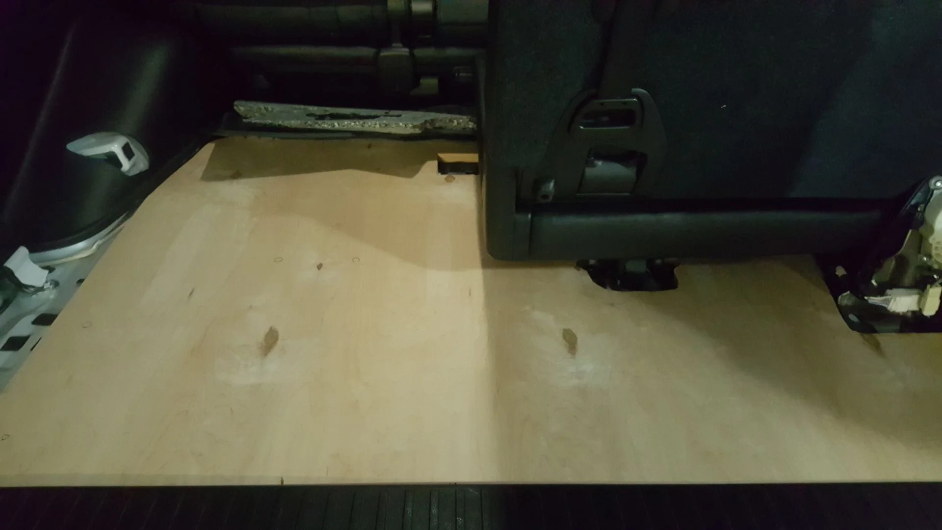

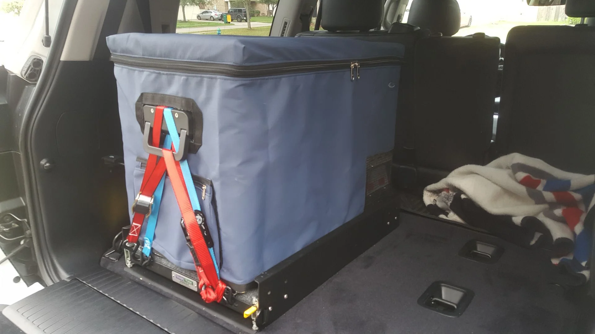

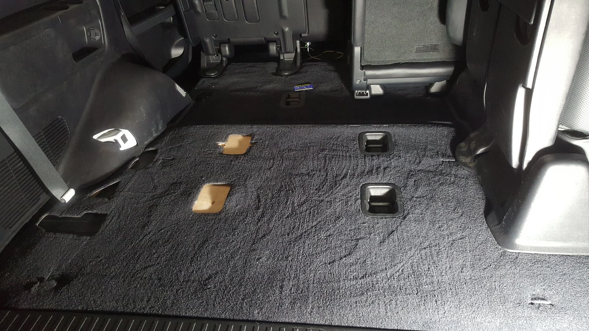

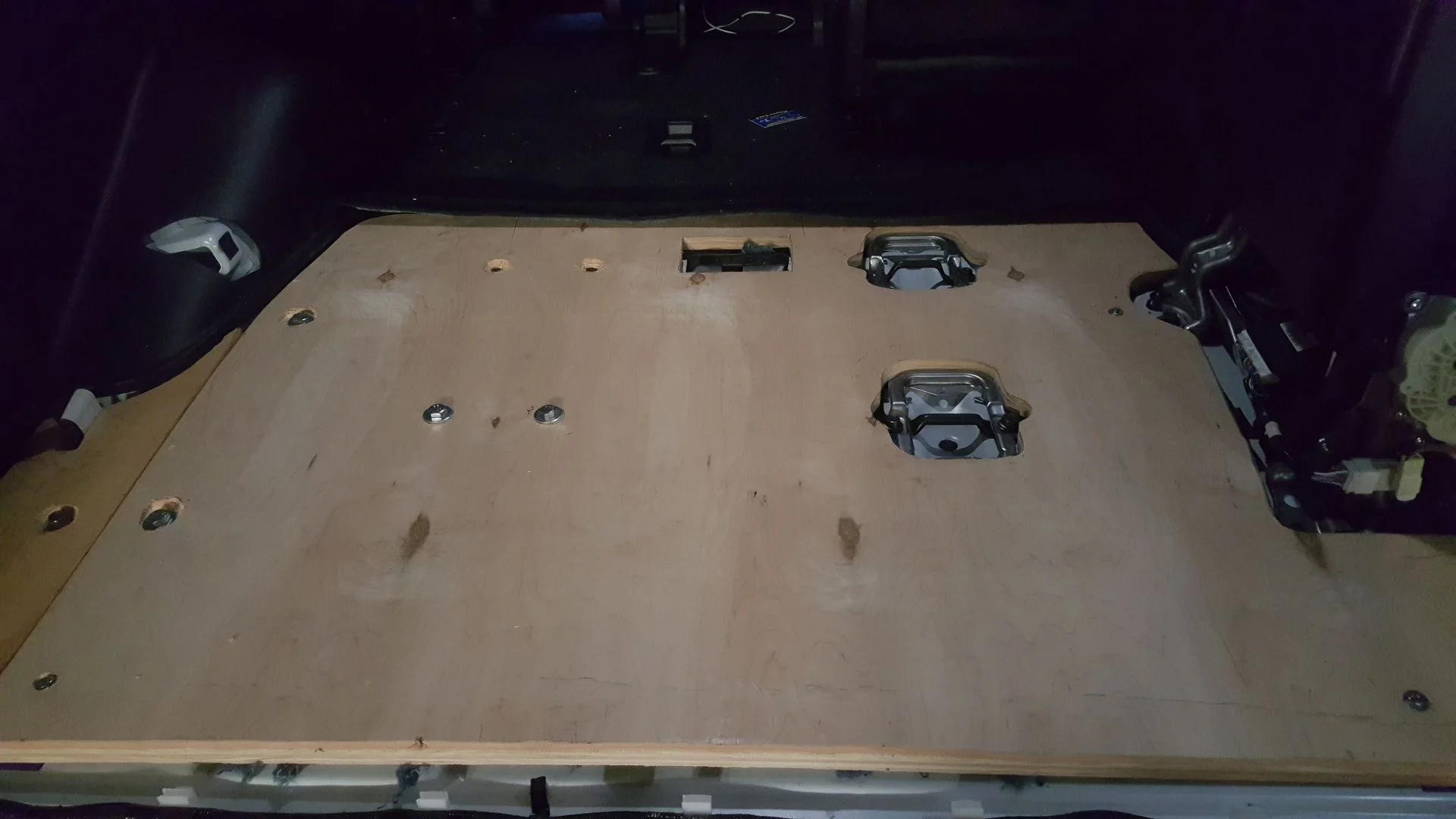

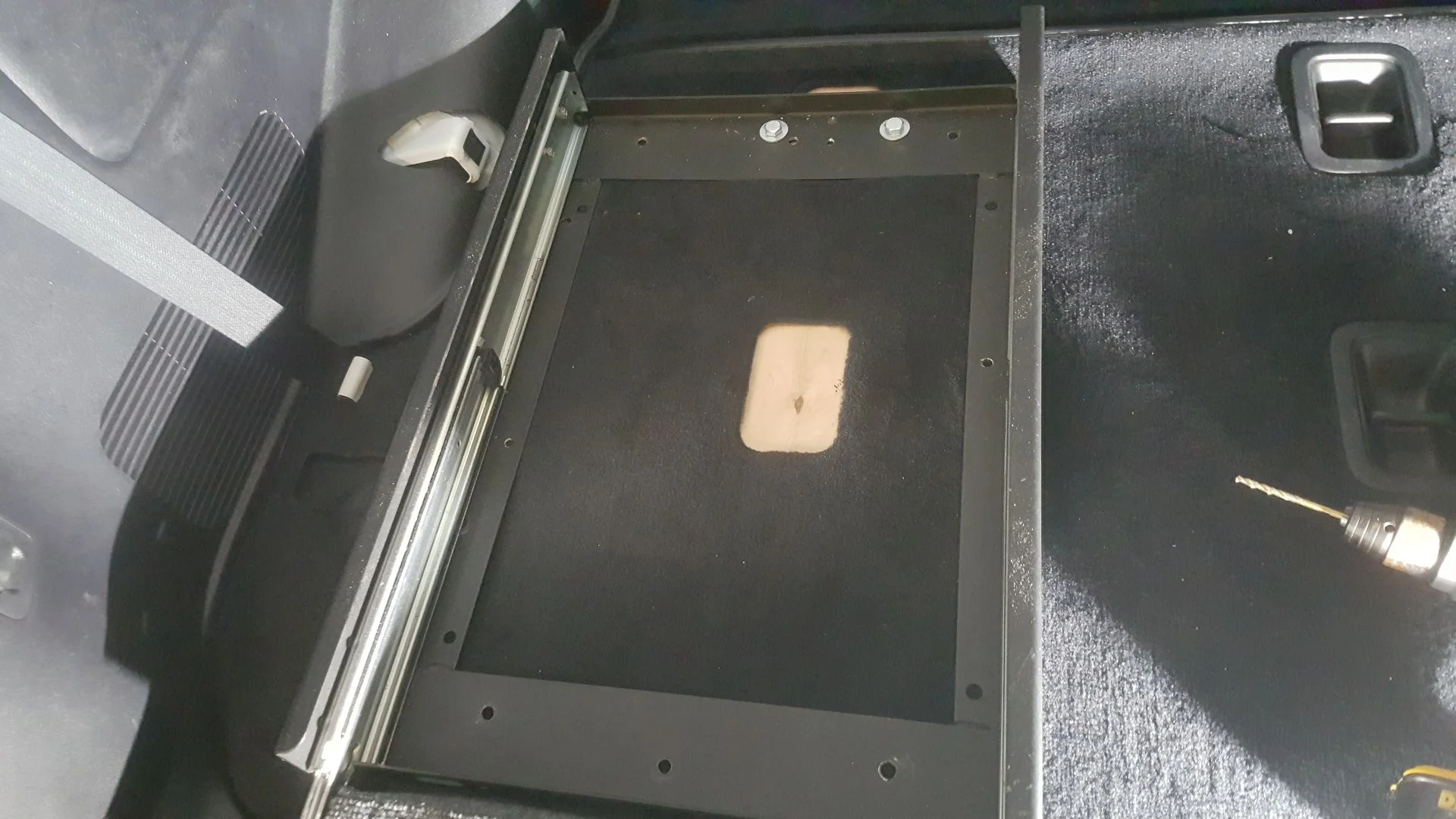

Purchased an LX 570 few months back (after a decade with 2 Gwags) and have been considering some type of base plate. Looked at a Goose Gear plate but didn't really want to lose both 3rd row seats (still keeping one as daughter likes to occasionally sit back there) and also wanted it to look somewhat stock with carpet etc.
Decided to make one which took about 8 hours over 2 evening.
Final view
1921296

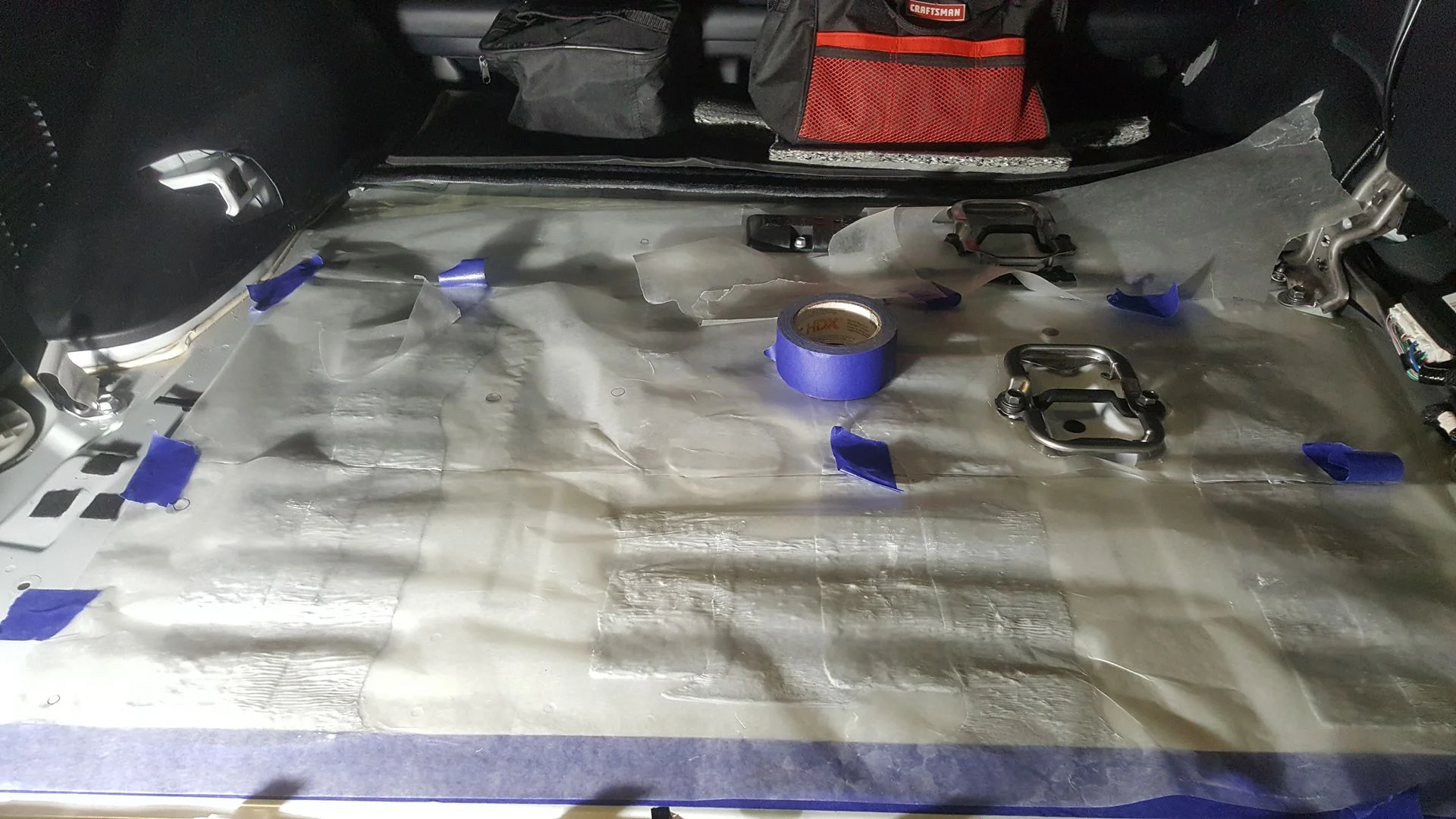

How it started
1921297
wax paper for outline
1921298
1921299
Cut and recut
1921300

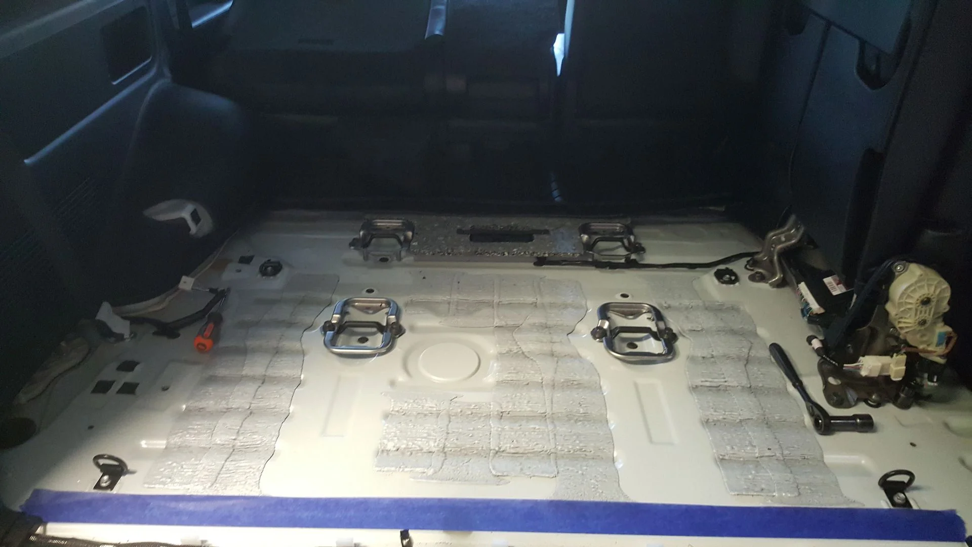

I suspect the bolt mounts would be similar in the 2nd row and 3rd row version of the suv. Wouldn't make much sense for Toyota to change that much to the body structure vs simply hiding them with plastic molding for 2 row only versions.
Lift your 2nd row carpet up and compare it to the bolt structure in my pics.
Very nice work, I like your template design method. 🆒
Wasn't 100% accurate with the tracing but close enough that it fit without issues. To mark the bolt locations, I tied a string to a random spot and marked each bolt position with tape and did it for every location that needed to be drilled. Once the string had 7-8 tape markings, the plate went back on vehicle and marked the tape locations on the board directly.
This is great! Two questions, one, how did you pull up the carpet? May be SQOD :meh:

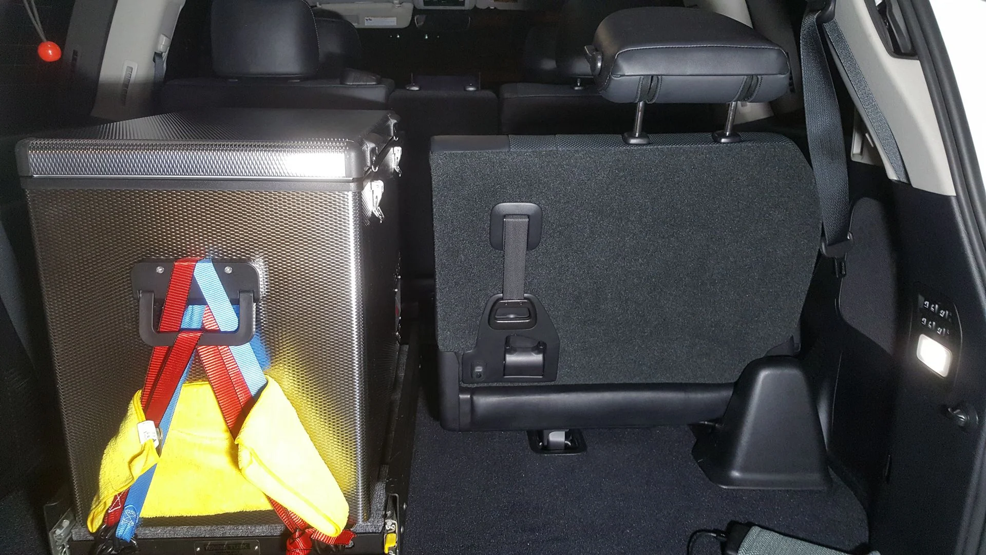

Next question, did you have to trim any of the plastic circled below or did those caps fit back on even after the board was added below?

Carpet removal basically just need to pull from any corner. You do need to remove both seats as the mounts do go between some of the cutouts on carpet.
The factory carpet has about 3/4-1" of foam and other padding materials underneath which I removed so replacement of that material with the plywood board doesn't change depth at all.
If you trim the wood board and leave a clearance gap, the caps will snap back in (if no tabs were broken in removal of the caps).
