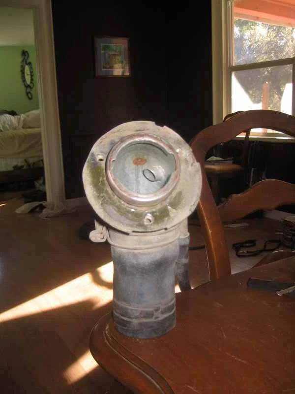

Seems like a basic question.
While my gas tank is getting boiled at the radiator shop, I've decided to "fix" my gas leaking problem.
When I have a full tank of gas, i will have gas spilling out my fill while I am driving.
My gas cap is brand new from Toyota.
Has anyone else had this problem?
Any ideas or suggestions.
Thanks,
Dave
Mine leaks so I only power through the left hand turns :D
Can't say that i have ever powered through any turns while driving the LV. :)
However, this is one of the many things that does drive me crazy. To the point of only putting in a half tank of gas. Especially since I can't even fill my own tank with gas.
Is my problem with the cap, filler neck or the tiny pin hole in the filler neck.
Dave
I've gone through 2 new Toyota caps and my LV still leaks gas. I even tried tweeking one of the caps to get a tighter seal. I could tell by the paint around the spout when I bought it that this isn't anything new. Does anyone own a LV that does'nt leak gas during a right turn?

I have found all my older trucks/cars to have chronic filler cap leaks on hot days when full of gas in Colorado. '66 Mustang, '76 F-150, '65 FJ45, '76 FJ55, '78 FJ40. All of these had/have sound fuel systems. Obviously, any car with a filler neck that is lower in relation to the tank will have worse problems. The hot sunny days here are the worst, as the fuel expands.
I simply don't fill them with gas until the pump clicks off - I stop before that. The only time I let them fully fill is when I'm sure I'll be driving far enough to burn off 3+ gallons of gas before I park it. You should be able to fill it 90% full.
Remote venting with a high vent line may be a real solution to this problem.
Steve
both my 45LV's dumped gas on right hand turns.....tired a dozen caps(all toyota) and same freakin thing.......so now I just don't fill it up ;)
