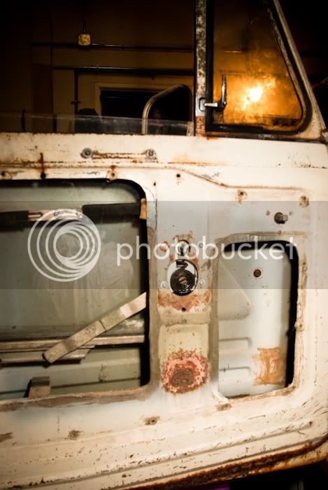

Scott, push the round bezel towards the door (its spring loaded) and you will see a pin,push the pin through,same for all the door and window cranks.I remember 15 years ago trying to figure it out! good to see that your at it again..YT

Thanks Whitey! I'll try that tonight. I've been fooling around with it a lot lately. I always used the excuse that I needed money I didn't have to do the brakes or the steering or whatever. Lately though I've gotten it cleared of garage junk and have been doing little things like fixing the loose wing window, cleaning up the dashboard and getting the doors dialed in.

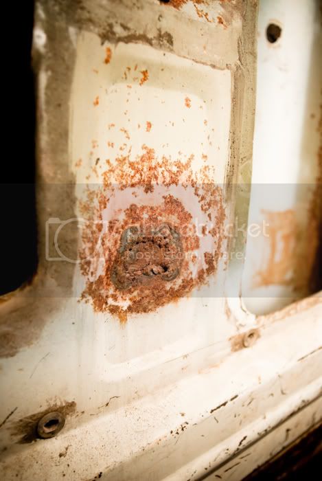

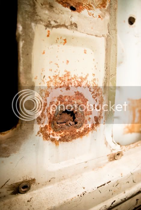

Wow. That was easy shmeezy. Hidden surprises behind that panel though. Window regulator mount rusted through door
Looks like a repair had been attempted in the past. That's some thin steel right there
Not sure what I'm gonna do about this. We'll see
