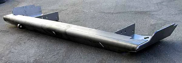

Brother Rob and I got started on our Luke bumpers on Saturday, just in time for CM07. Will try to do a write-up of the kits after the trip, but a couple of quick observations. The angles are greatly improved, shots from the side, the ladder used for scale is 26" tall.:D
I don't know if he is going to produce the kits, but they are a cool project to build. A ton of work, lots of mig wire and grinder wheels, but the result is very rewarding! Working all day Saturday we got mine all done but the "trim Parts" and Rob's main shells done, hoping to get Rob's swing out done this week. A shot of the underneath structure.:hillbilly:

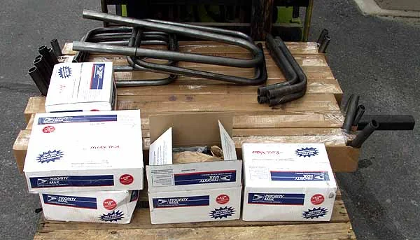

Our club did a "test" group buy for a stack of kits, don't know if he plans on selling any more of them? They are very nicely done, very little grinding needed to make the parts fit. The kit is just that, a pile of precut parts that you that you, fit, weld, grind and finish how you like.:hillbilly:

You probably want to just contact Luke for details on kits/group buys. IIRC we had a total of 6 bumpers in our group buy, all shipped to one location in Phoenix.

DIY Kits where in stock when I bought mine which was a big+. Cost ~ half of a pre built , cheaper shipping since it went UPS 2 boxes instead of freight but check with them for details.
