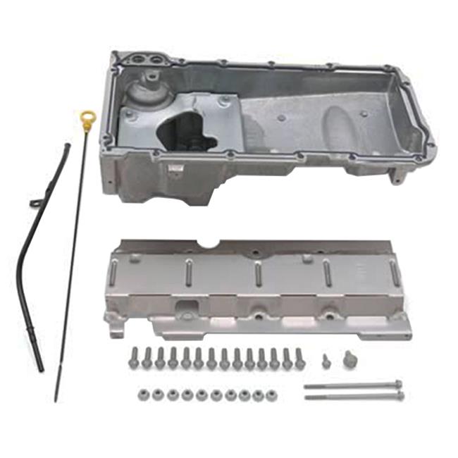

Anyone have this issue. Mine is pretty close. At full articulation, it's even closer. I'm afraid on trails it might hit. Anyone else have this issue?
Will H3 pan give me more clearance? I was think about those low profile pans but I lose 2 qts I think.
Yes. The stock pan is your problem. H3 pan will take 6 qts. Plenty of oil
