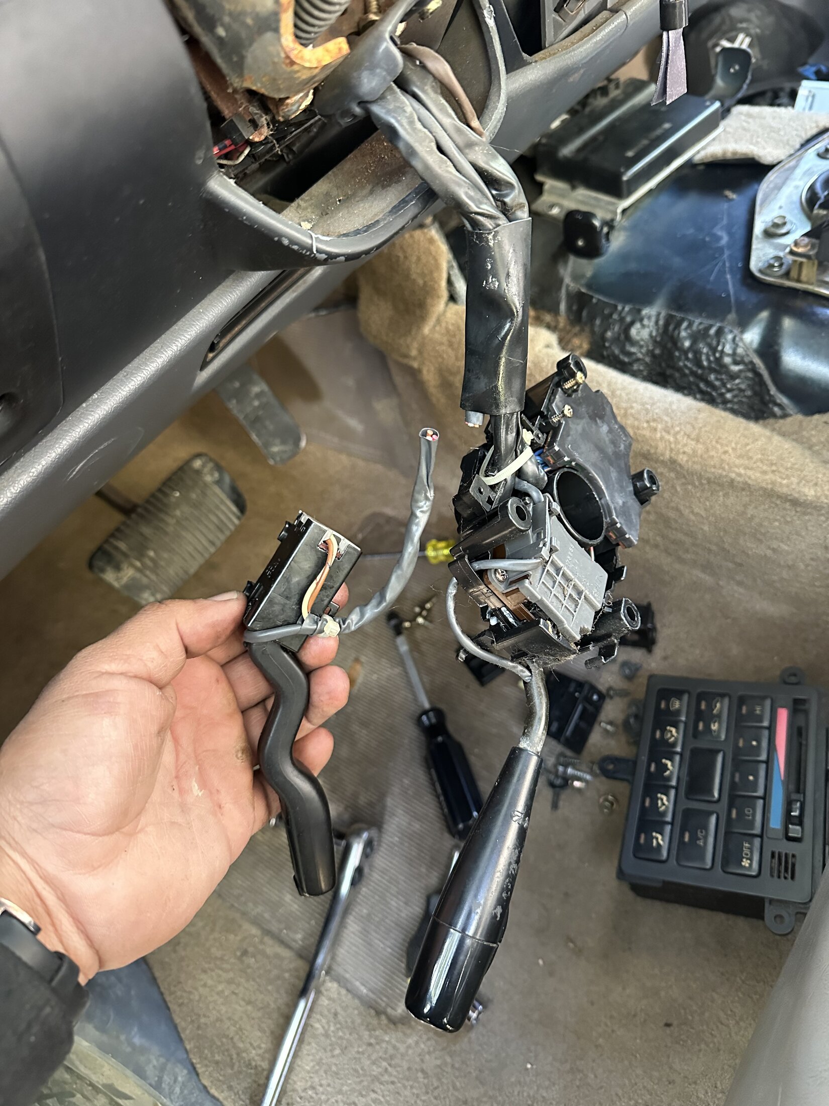

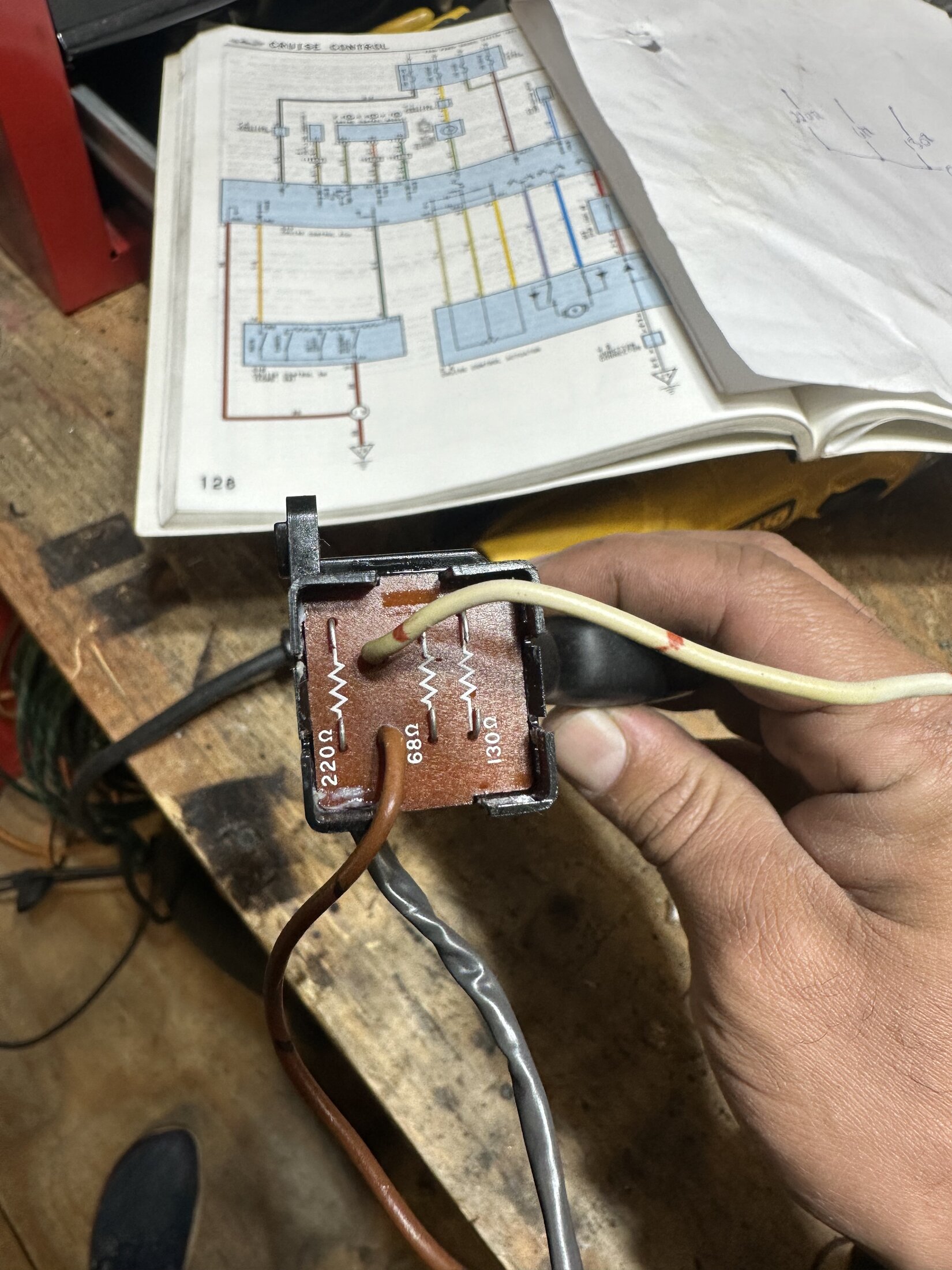

Alright so I think I'm going to be able to do it. I think I can convert the stock cruise control switch wiring to do what the LS/4l80 needs (momentary 12v inputs for resume/accel, set/coast, and cancel).
I took apart the cruise control switch, cut out the resistors, and figured out what pins to connect to what to get me the momentary 12v. All I have left to do is solder on some wires, connect some relays, and then connect it to the 4l80 system. It's still quite a bit to do, but I'm pretty sure it'll work.

Let me know your thoughts, please. I'm 100% just making this up as I go with no prior knowledge at all of how to do this. So, any input is welcome.

The factory switch only has two wires coming out of it (besides ground). One for the main on/off as you mentioned, and one that sends different resistances to ground (as I understand it) into the cruise control module for resume/accel, set/coast, and cancel. That won't work with the LS swap stuff...
Rostra makes a DBW cruise control system that connects to the pedal, basically controlling speed through pedal actuation. The switching system to set speed, accel, deceleration etc is simply switched with momentary switches. That’s where a stock lever could probably be modified to substitute for the switches Rostra sells.
