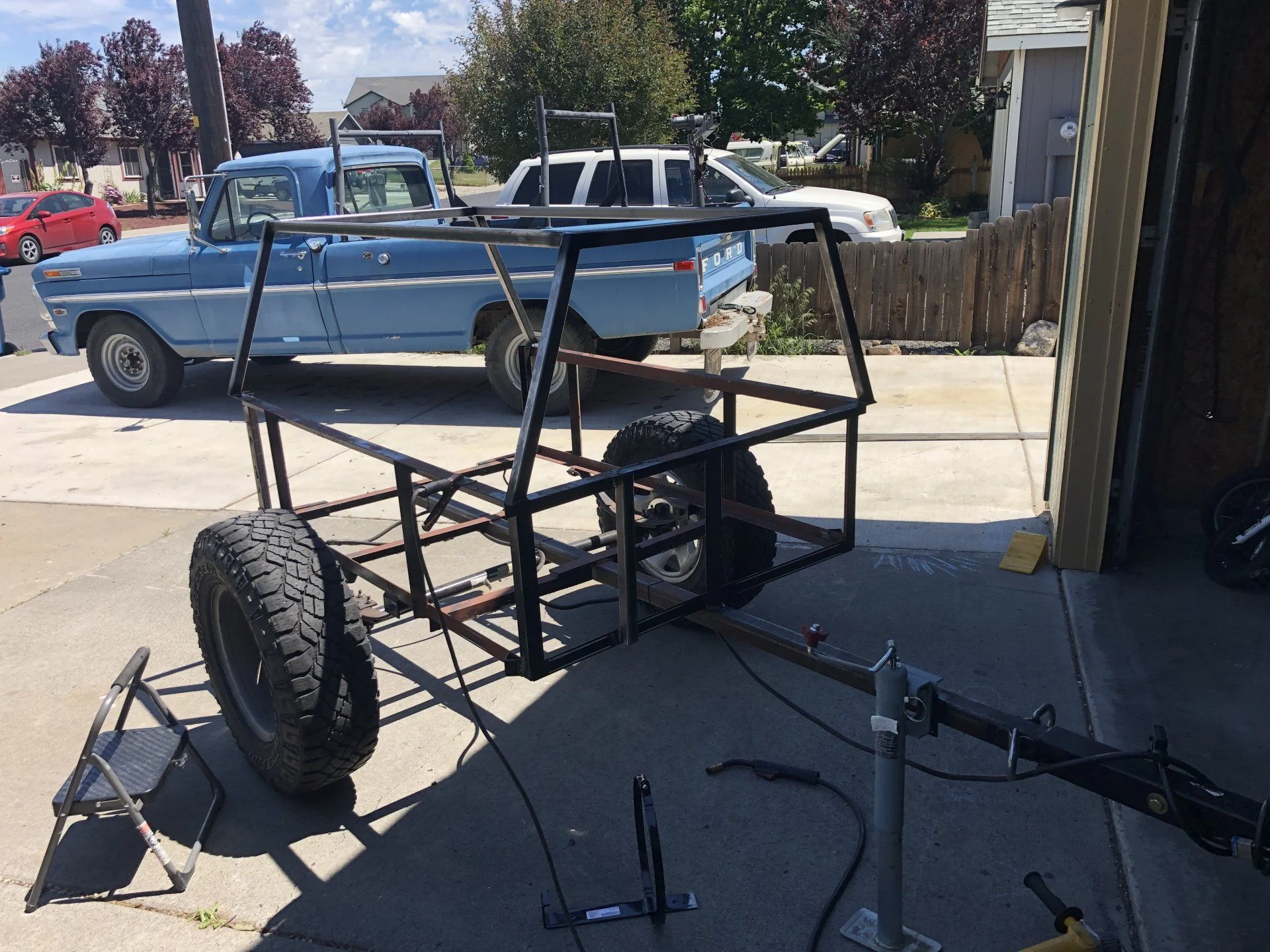

Some more work done on it today.
Cut the old poop pipe rack off.

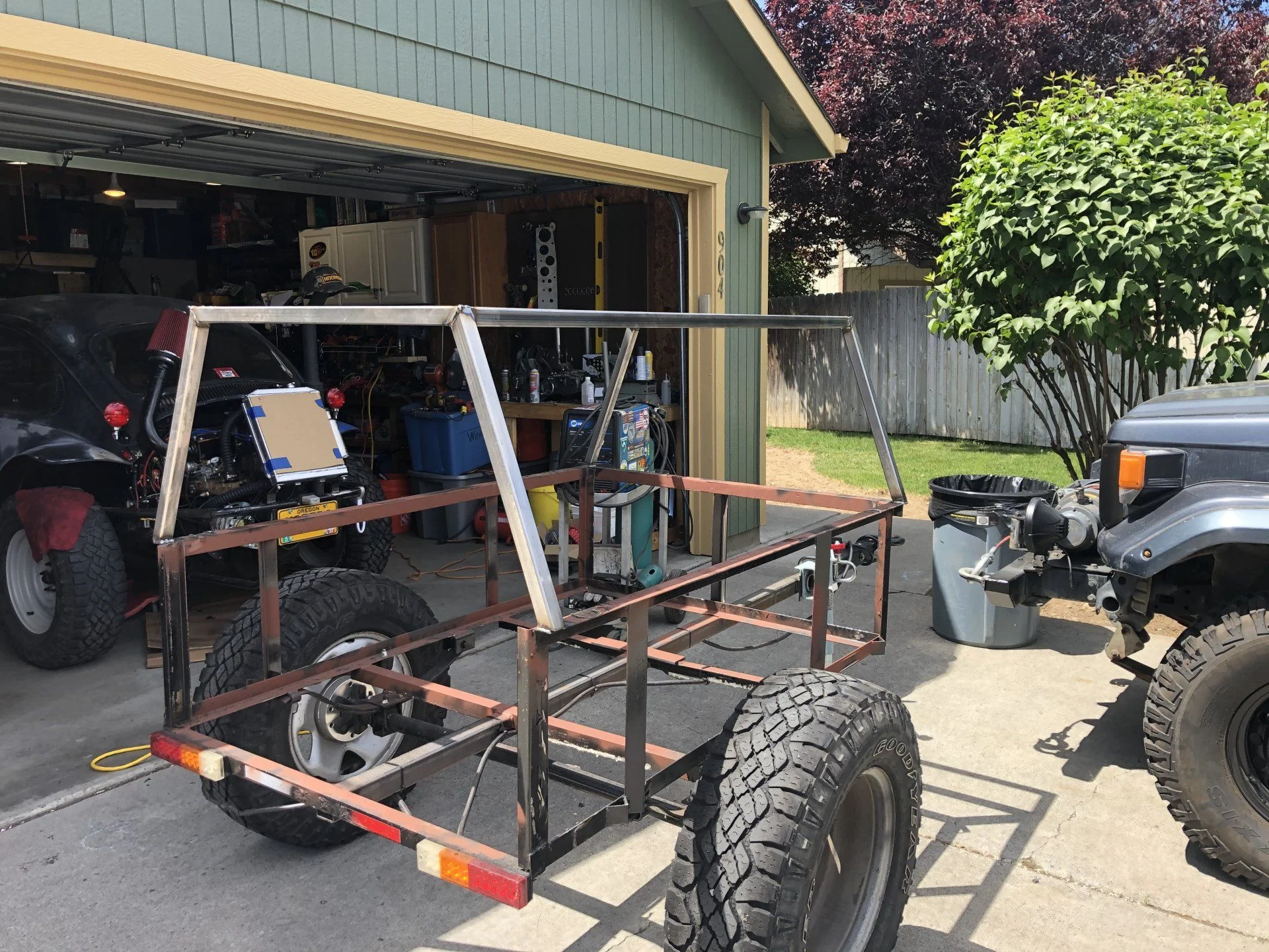

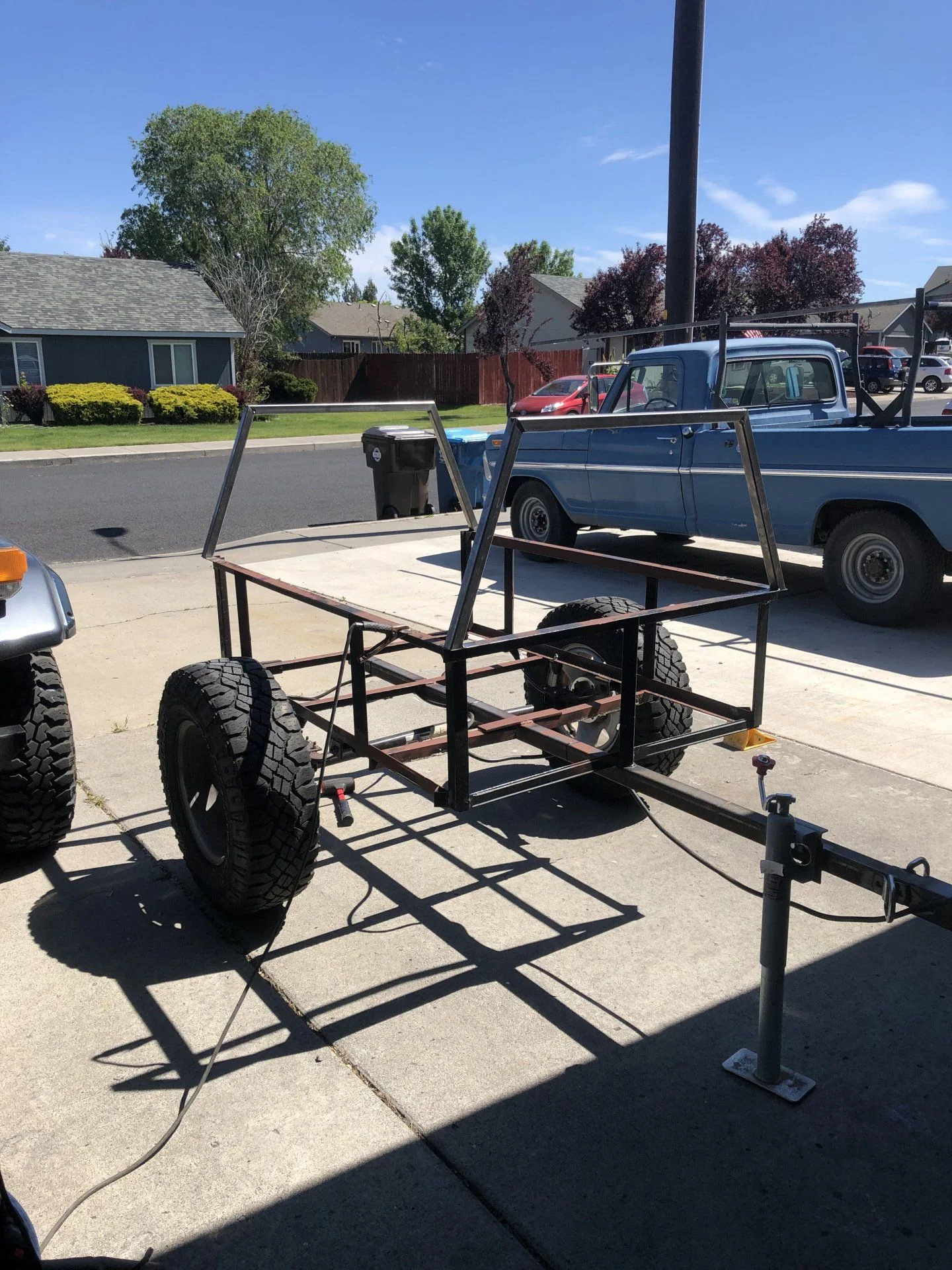

Made some new angled uprights out of 1.25" sq steel, 1/8" wall
Welded some long pieces in between...

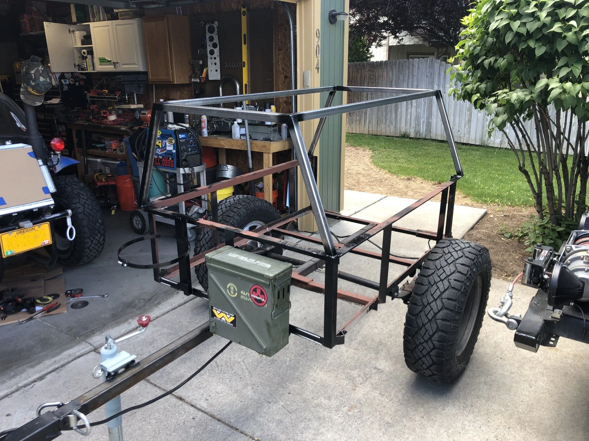

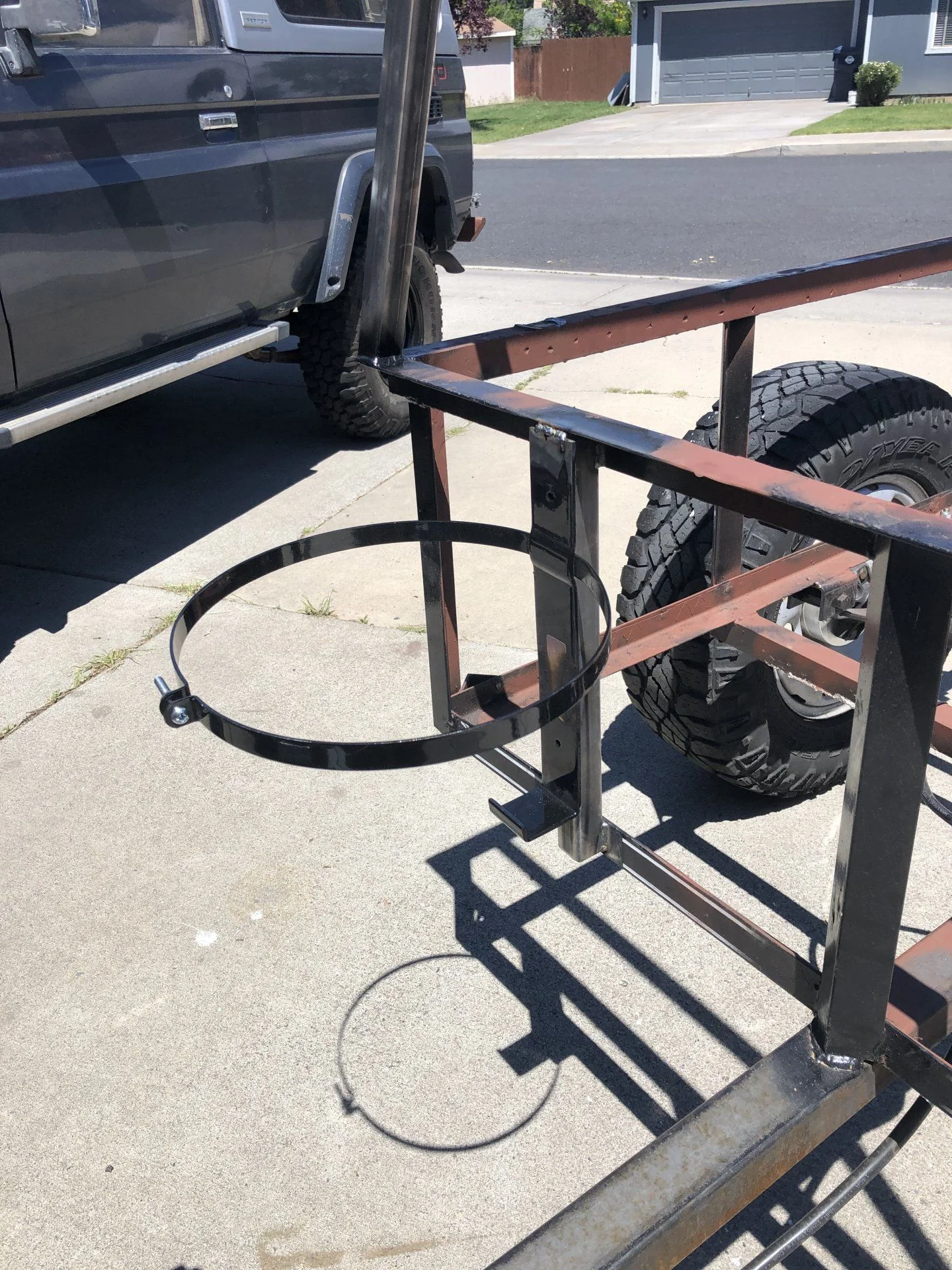

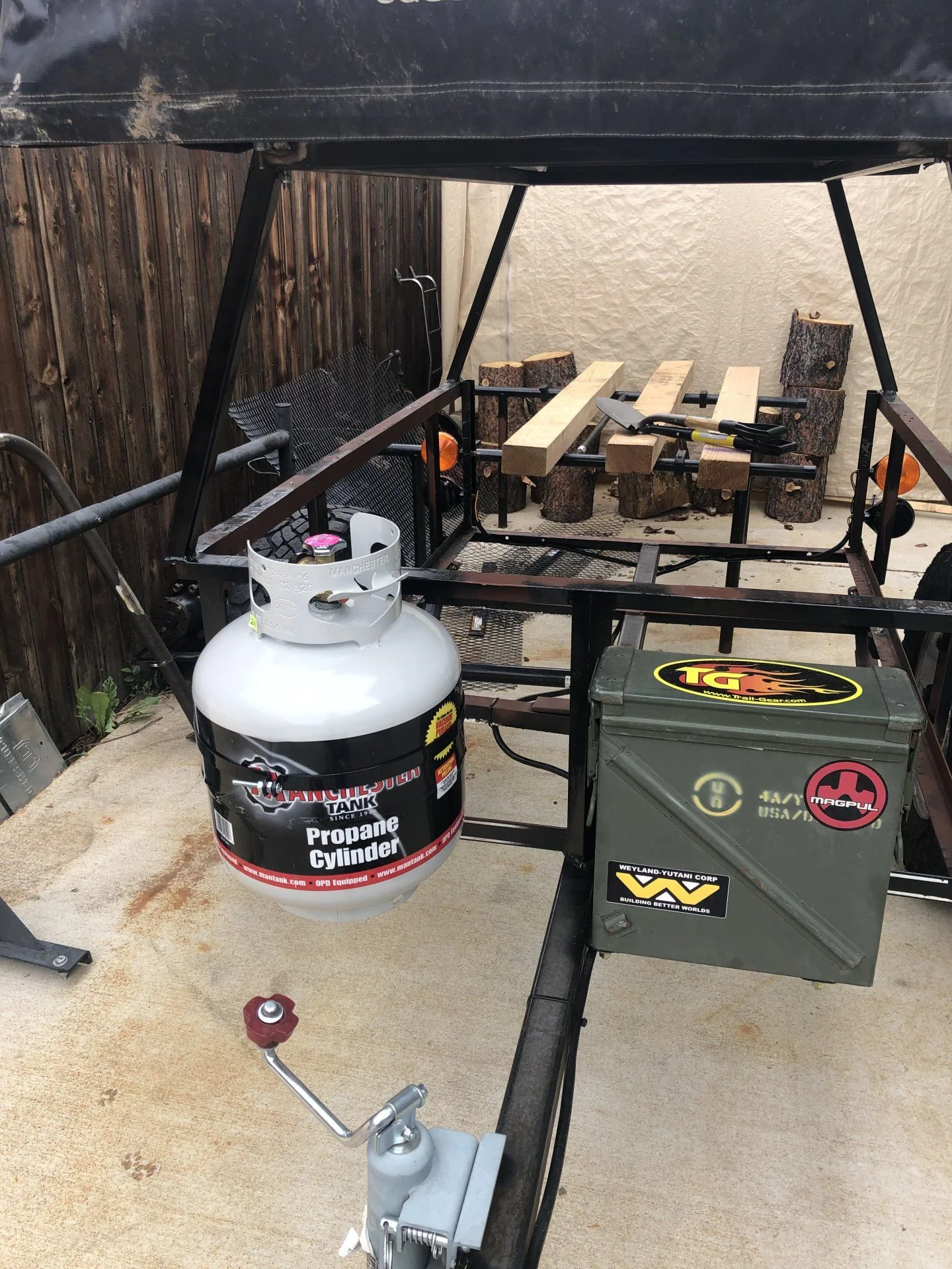

Welded on a cheap 20lb propane bottle holder and ammo box mount
Ammo box mount was part of an old winch fairlead plate
With a ammo box mounted. next i'll get some parts painted, remount my cooking fold down table and see how $$$ aluminum sheet is.

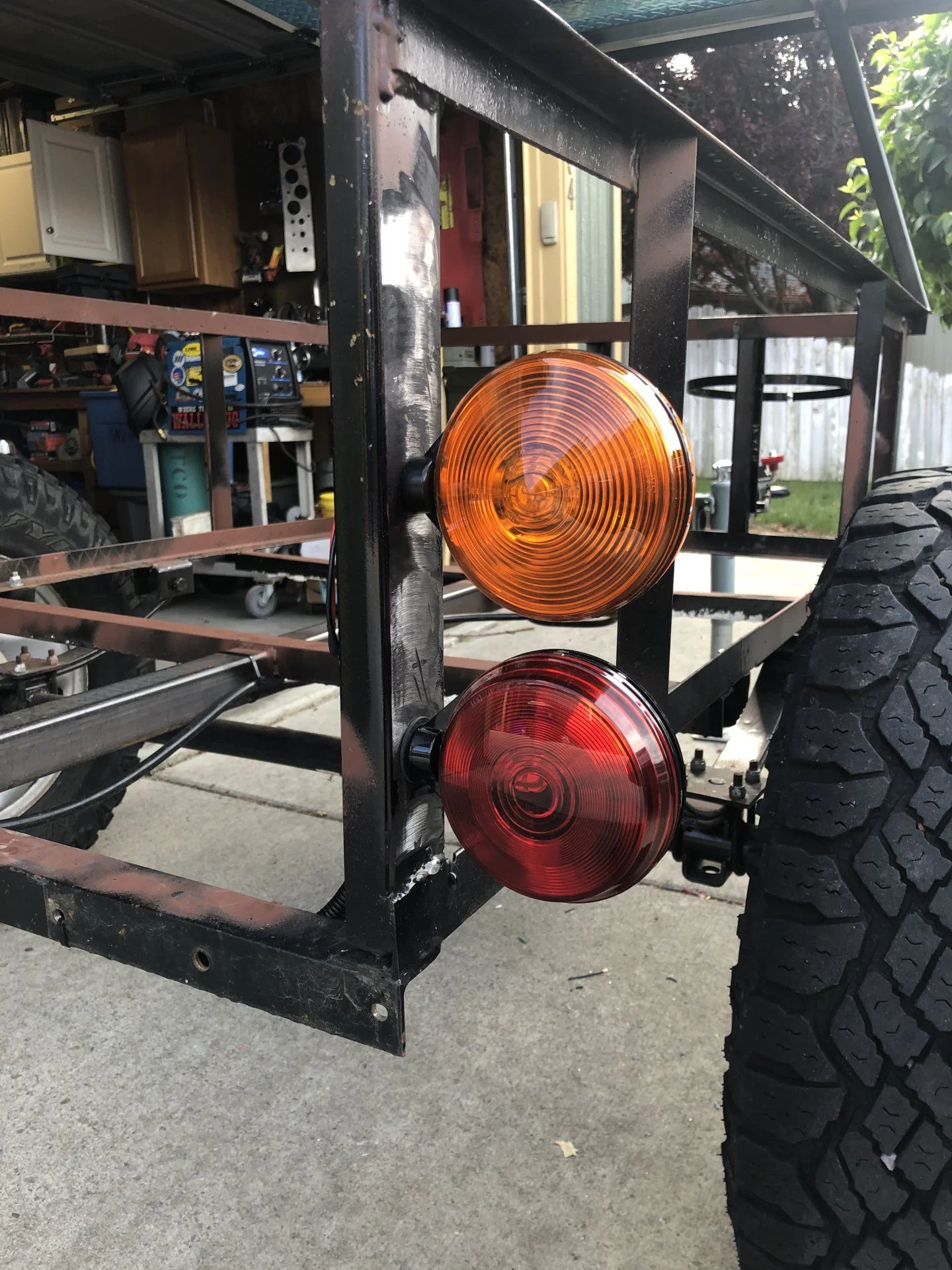

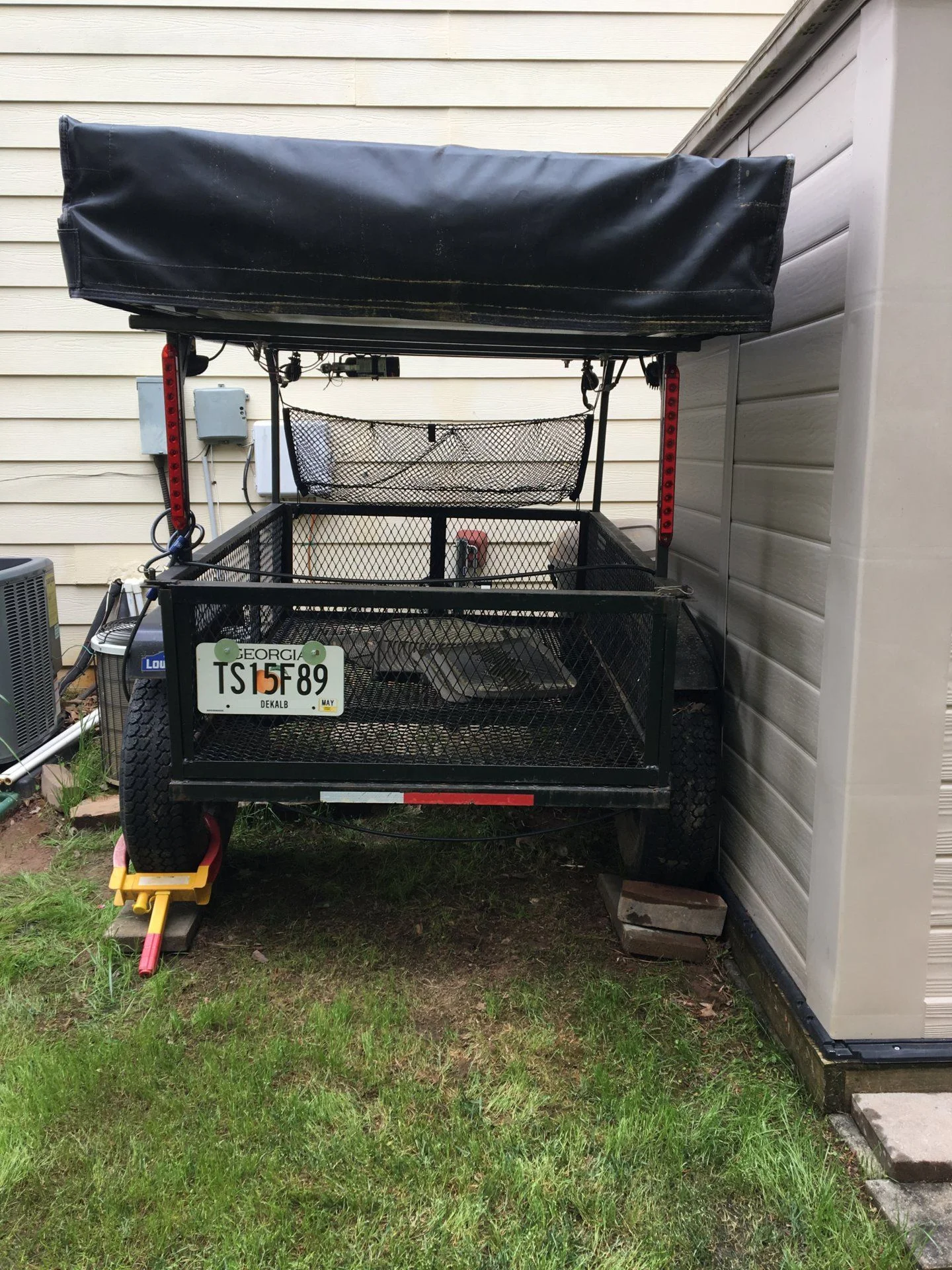

Got the tent back on, wired new lights that hopefully will be easier to see than the other ones. Also mounted a propane bottle and bought an adapter hose so I can run my camp stoves off of it.

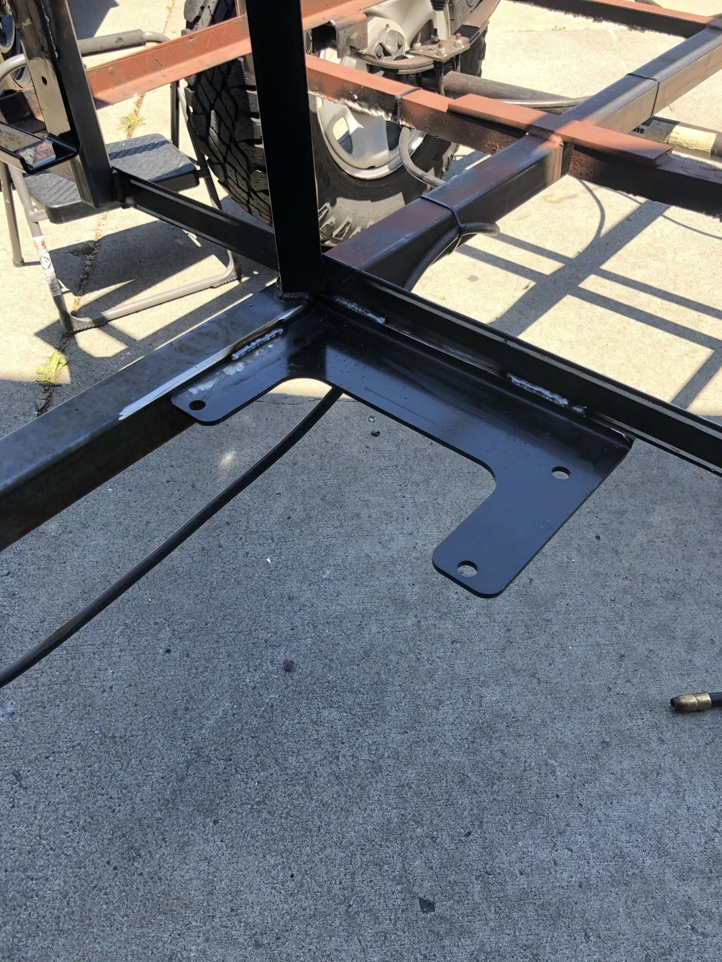

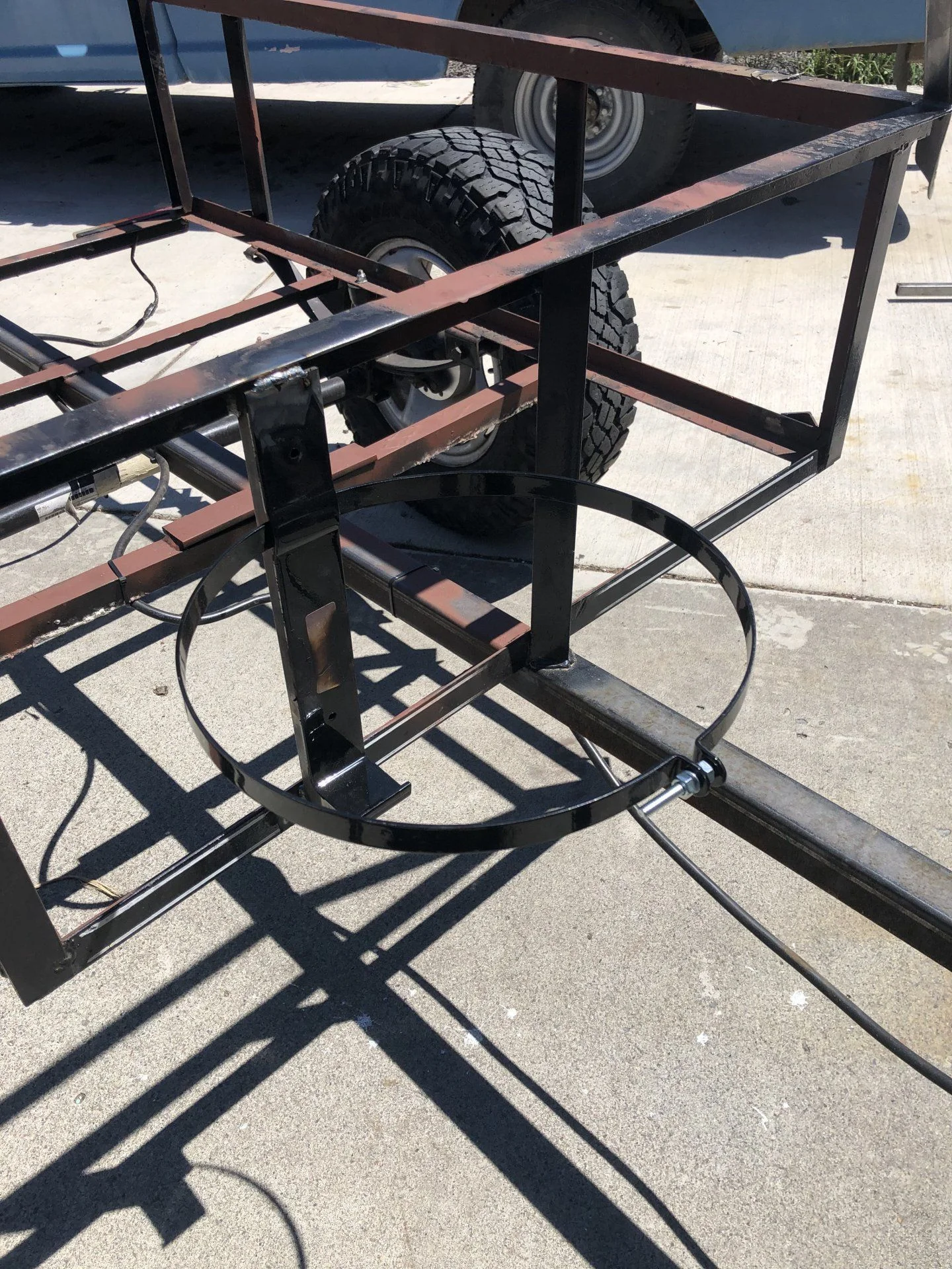

Something that's been bugging me for while is that the rear supports don't have much rigidity in what they're welded to as compared to the front supports. Until now I've not had a solution to suggest. It isn't that what's there won't support the weight, its more that going down the road those ends of the bed rails are going to vibrate and wiggle, which will eventually fail the welds at the base of the last vertical support.
With these closer detail pics of the rear I would suggest a piece of square tubing be welded under and behind (forward of as facing it from the rear) that lower-rear angle piece. Set it's length such that it extends out to the sides as far as you're comfortable with, and then bring some diagonals up from that outer end to just under those rear supports. I can see that tube becoming the rear fender support if fenders are in the plans. As to tubing size for the horizontal, I'd go as big as the legs of the angle at the least. Outer dimension will matter more than wall thickness in this situation. The diagonals can be smaller if that works better, but go up in wall thickness if you do.

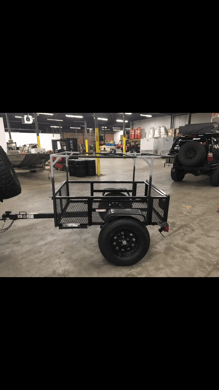

Hi, just purchased this same trailer and getting the axle flipped. Does anyone have details on this wheel/tire combo...this is exactly the setup i want. i plan to keep the fenders in the stock position like this one. i assume no spacers were needed on this setup. they look like 14"? Any help is much appreciated! thanks!

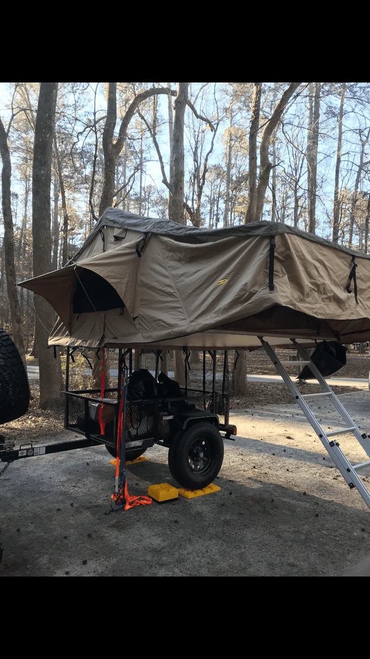

You guys are building these for/ using them for road trips primarily? Getting to campgrounds and such?
I'd be wary of the frames, axles, bearings, tongues or... everything I guess, standing up to serous trail use even with light loads.
I have two hard used M416s and had an M101 too. On some runs I have had all three of them along behind our support rigs. Loaded with fuel and gear. They do great, but anything any lighter duty would not survive. Those Lowes trailers and anything similar are just not meant for the stresses that off road use subject them to. You might be surprised how easy it it to flip a narrow trailer dragging it over thick brush or down steep river banks too. In fact, one of my416s is awaiting major repair after flipping while being towed empty. :(
