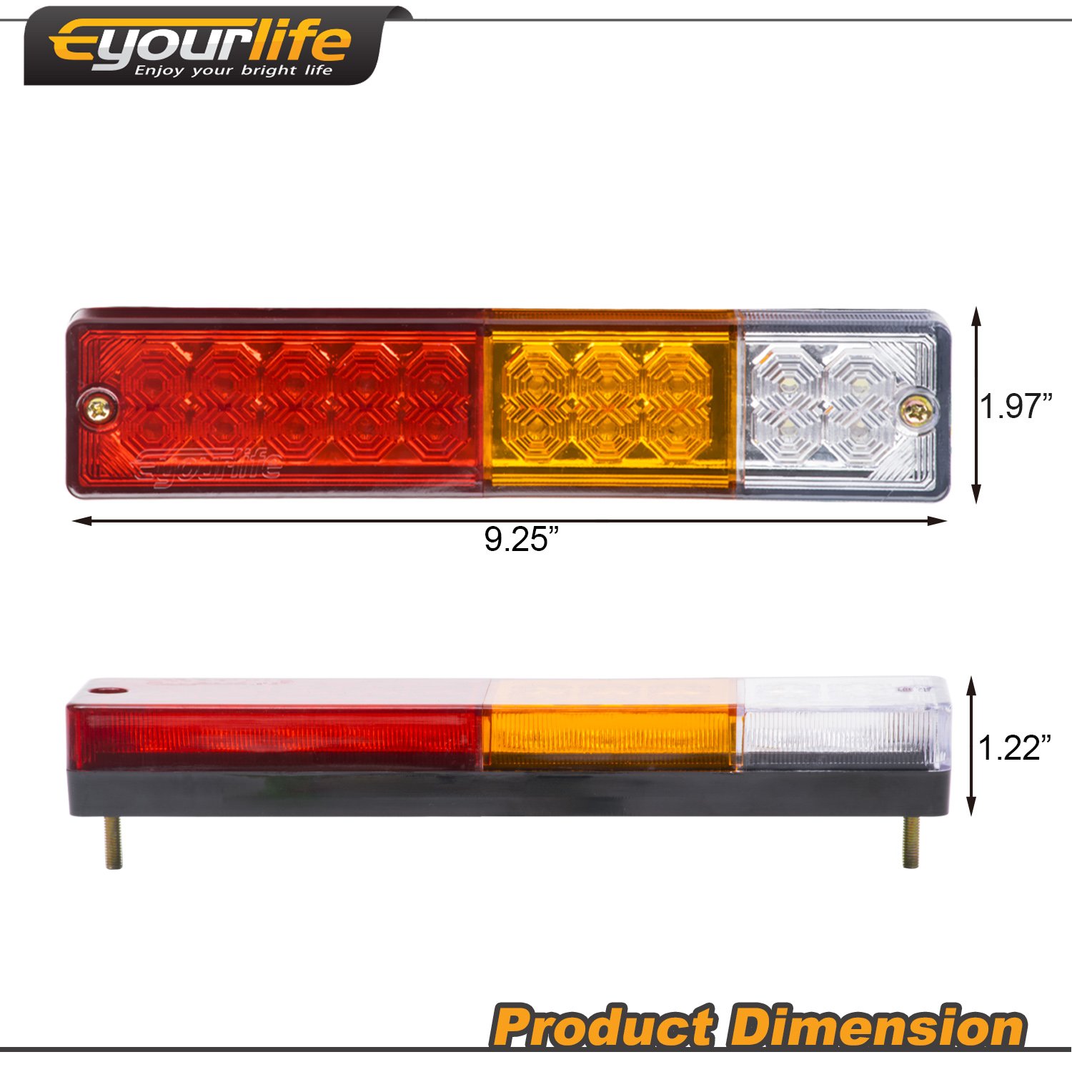

Also gonna pick up some LED tail lights that'll work with 24V from Amazon:

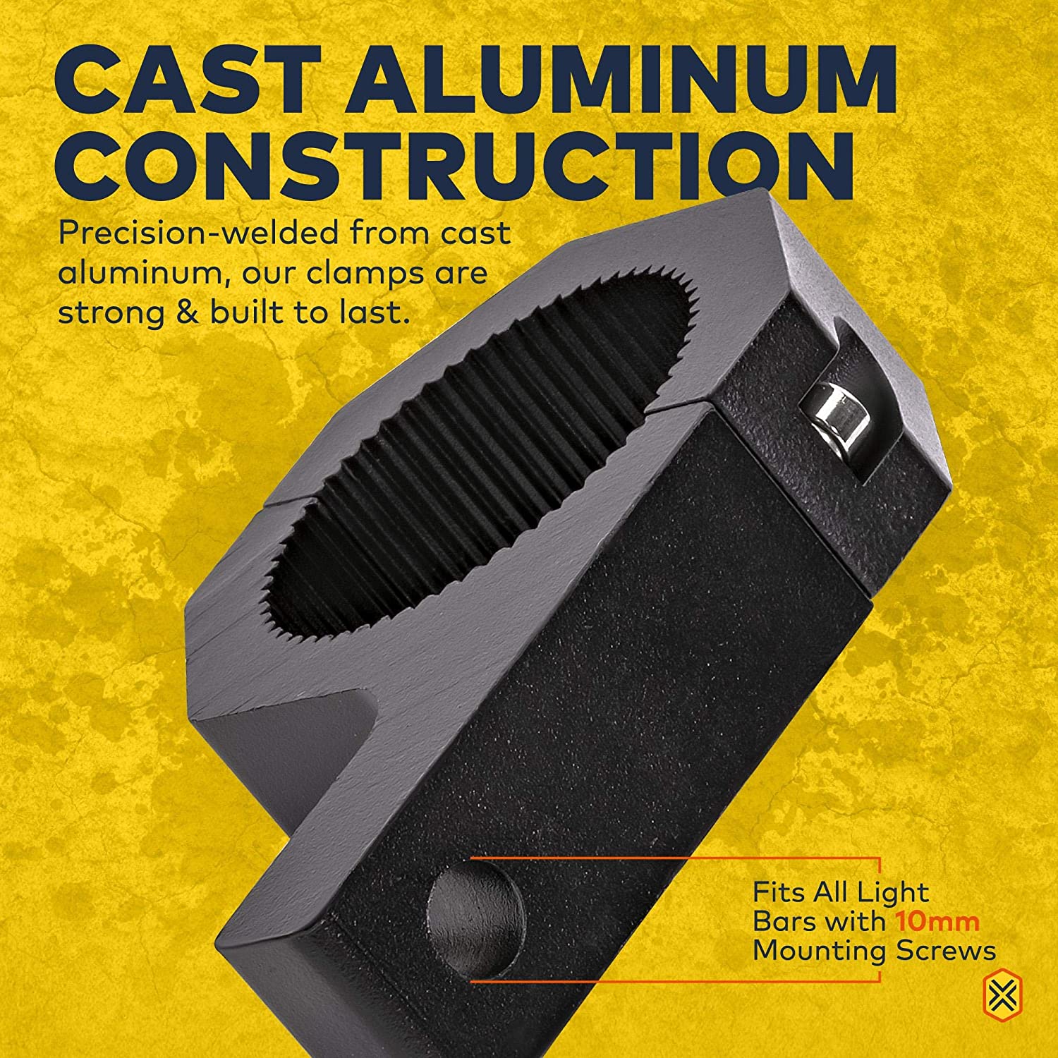

cool! what kind of mount did you use to attach your rtt? looks like the mounts they sell to put led light bars on tube bumpers, etc.
Thanks!
Neato!! I like your tail lights.

My Chinese LED taillights are already failing, 24V is not good for them lol. Going to run larger more traditional trailer lights and use 24V bulbs that are replaceable
