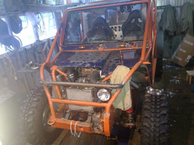

would it be possible for you to post up photographs of the buggy? this would in my opinion be very helpful

I'll post pictures in the evening, cause I am at work at the moment. I can't tell you the speeds - I didn't test the car with GPS. I'll try to heve my engine remapped, with new Supra Injectors, and bigger IC tommorow, but it depends on friend of mine who'll do it. Than I'll be able to tell you more details cause on stock injectors I had to raise fuell pressure wich isn't healthy for fuell system (metal fuell filter could't handle the preassure and started leaking).

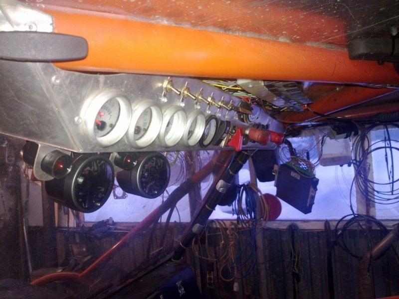

Sorry for the quality - snow was blocking doors and I wasn't able to move car from the garrage.
I know that car looks a bit like pice of junk, but new IC needed more space, co we had to modyfie all front of the car and cut the hood
Looks like a perfectly road legal Polish 4x4 to me. :):):):):)
I wonder how they do it and get away with all the mods.
Damn that must be cold to drive in the snow :) I wouldn't want to open the door either.
Seen so many "road" legal Polish "Cars" in the RFC.
This car isn't totally legal. If police stops me they can take my Vehicle registration certificate and than I won't be able to get it back, cause I'd have to go to the "official" diagnostic station. However as long as I have it I can go to diagnostic station that isn't "official" (I don't know the name in english, but in poland we have two kinds of diagnostis stations - one of them are run by goverment, others are privat) run by my friend and get stump to my registration certificate, where it's writen that my car is Suzuki Jimny 1.3:D . We have so many "road legal" cars made of pipes, because if you want to start in any race in poland you are required to have car with plates and insurance.
