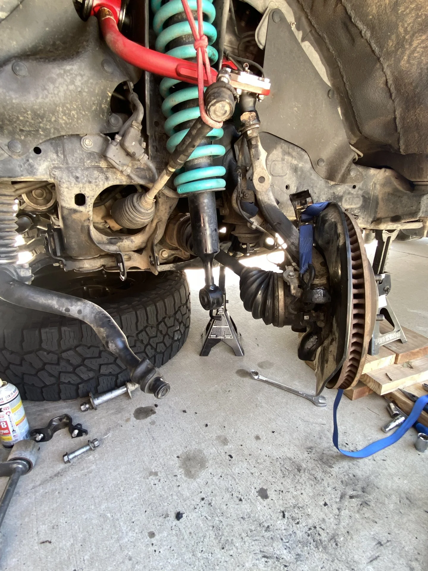

DIYed the LCAs today, not too bad of a job. Took about 4 hours total. Worse part is fighting the KDSS sway bar back into its correct place after disconnecting it, that and separating the lower ball joint from its lower mount.

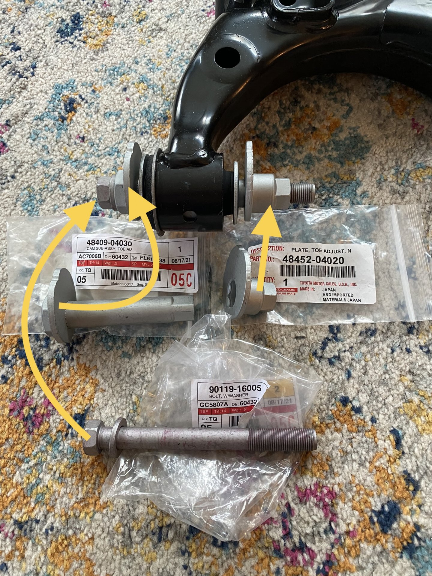

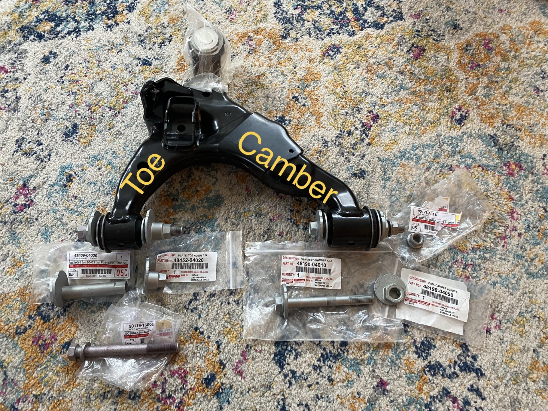

Here’s the alignment cams and bolts breakdown:
