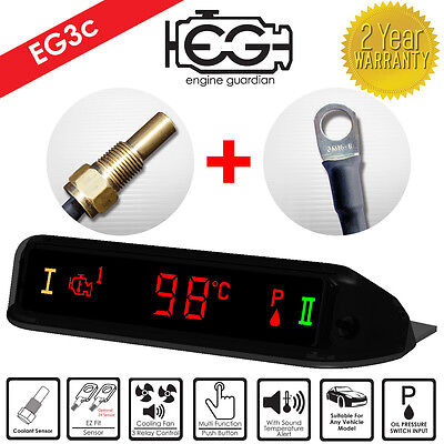

I went pretty low tech actually. I put a t-way on the oil pressure sensor location on the block, and hung the factory pressure sender and switch off it. The gauge is wired as normal, nothing changed. The switch is wired into the light I spliced into the cluster, and into the oil pressure switch input for my engine monitor. I run one of these:
Great unit, I highly recommend it. Here's it fitted to my rig, with the engine stalled out to show the pressure alert triggered and the light on the dash:
Did the pressure sensor come with the watchdog?
I have a watchdog to alert me on coolant temps.
No, it just has the input for it, not the switch itself. I nicked a Toyota pressure switch with the funny slide clip they use off an old Hilux in a wrecker. Or at least the clip I did, maybe I got the switch in a parts order? Can't remember now. Lots of options though, the switch is simple, there's plenty of options out there.
