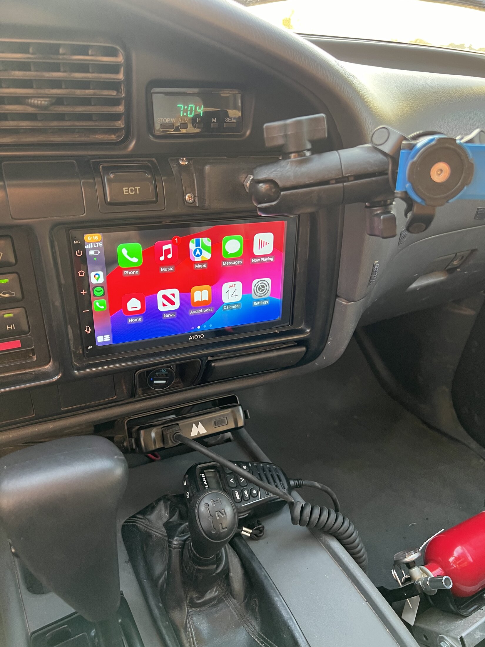

In and working. Less than $120 for head unit, wiring adapter and cheap dash speakers. I have carplay now. Yay. The sound isn't great, but good enough for me. Thanks all.

So, you still have factory speakers?
Did you bypass the amp?
Not too much to see.

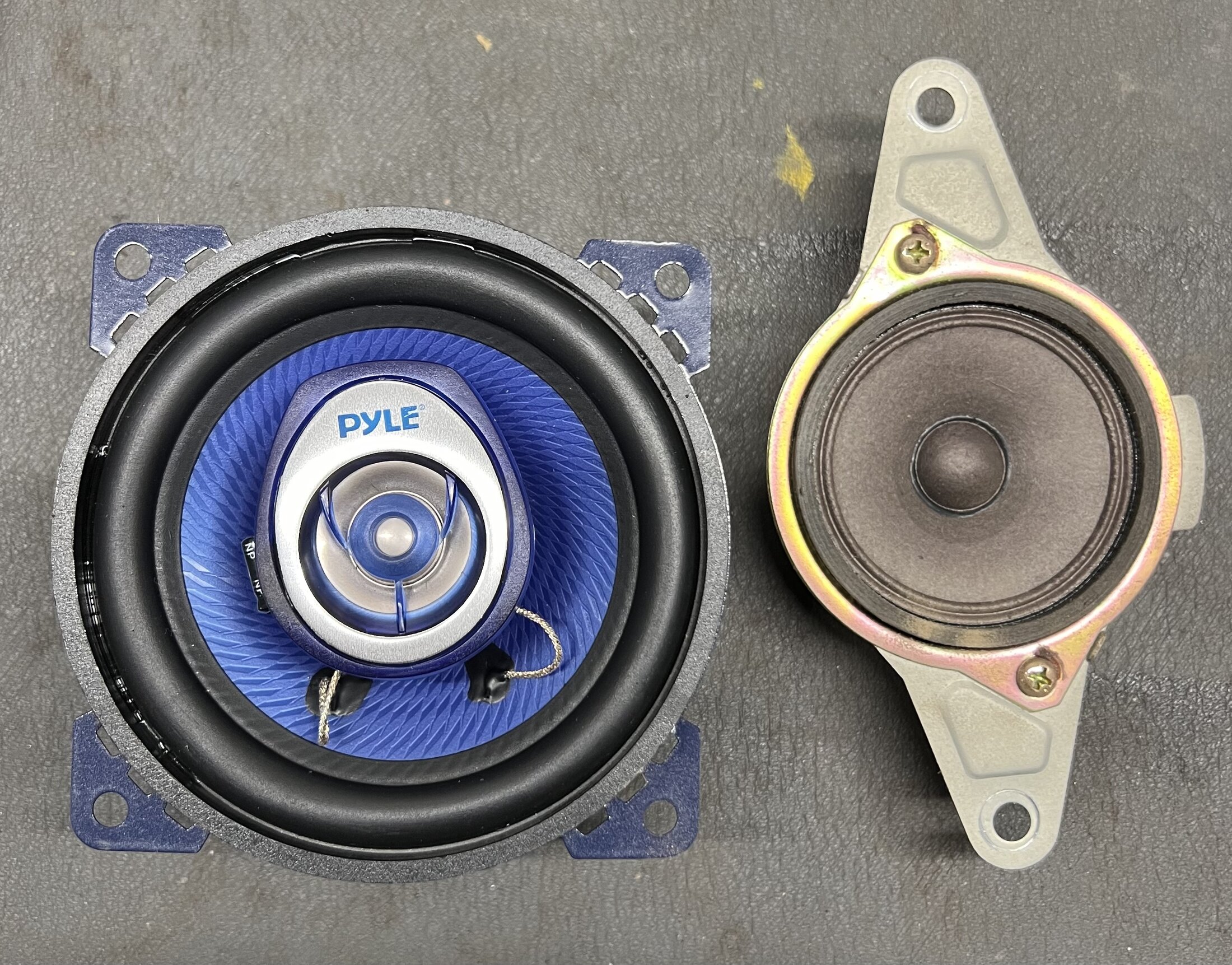

I only have dash speakers and the cargo speaker. I took the door speakers out. I wouldn't necessarily recommend that, but for my lo-fi needs it's good enough.
I used to use only the dash speakers for the front but recently added some 5-1/2" door speakers, bypassing the dash units. The difference is a lot more dynamic range when listening. I know you do not want to cut the door cards but keep it as an option for much better sound at little cost.

Stay away from the tiny Boss speakers, however. I installed a set of 4" in the dash of my Prado maybe a year ago and they sounded worse than the 25 yr old paper speakers I was replacing. I had to pull the dash back apart and replace the replacements.
