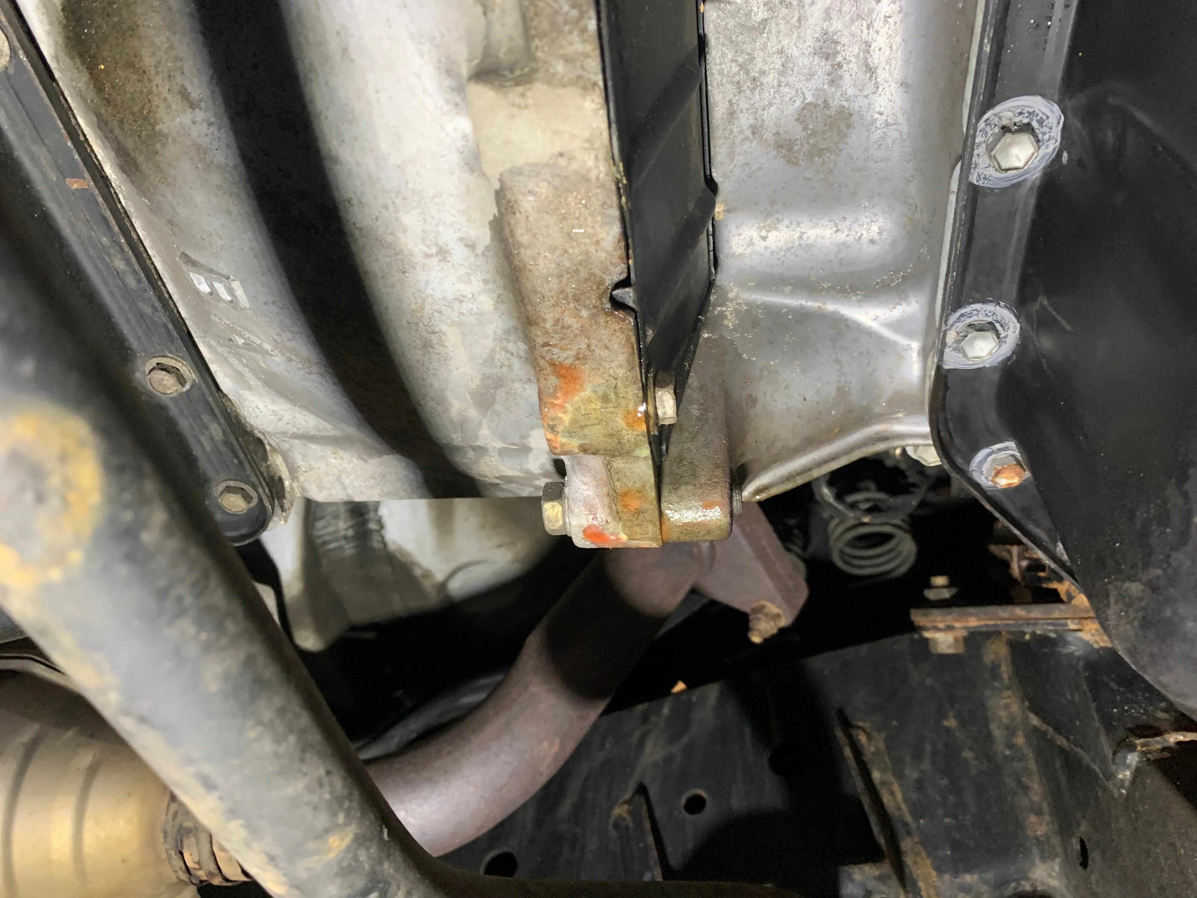

When I was installing skid plates I found this.....
full

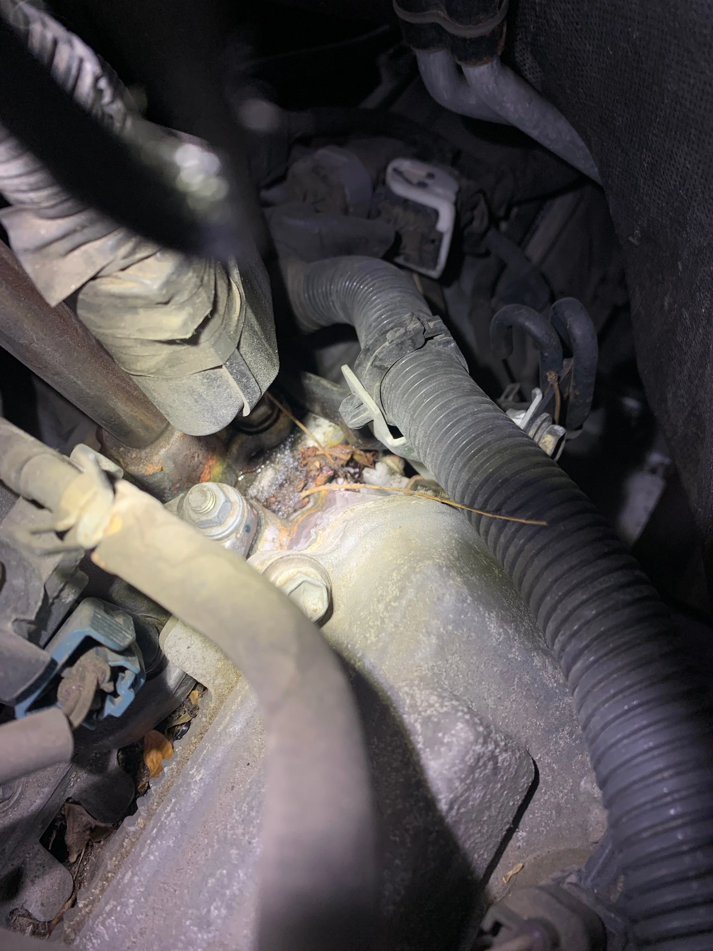

Traced it down to the bypass on top of the engine. Coolant bypass is just behind the intake manifold.
full
Hard to see from my picture but can see red/orange crusted up by the hard pipe. Cruiser Patch has a good picture on their website.
