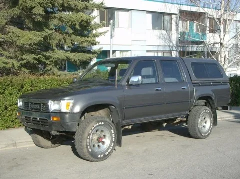

Oh Josh you are so funny. Where do you get the idea it is an Isusu? It says Toyota all over the place unless you are making another funny and I don't get it.

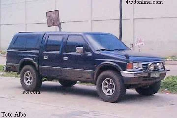

Look at the body on the crew cab, especially in the fenders.
this is the toyota crew cab
and a cleaner less beat upon isuzu crew cab
I always liked my old isuzu pickups and troopers. they were just so basic :)

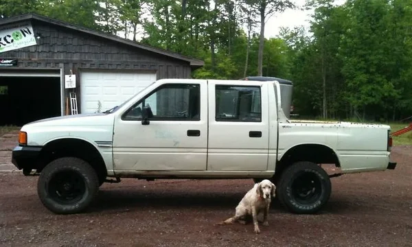

Also, after some digging on Craigslist I found his OTHER ad.
1992 Isuzu crew-cab
2L-TE turbo diesel
1985 Toyota Solid Axle frame
When is the last time you have seen a left hand drive, 4-door, 4x4, turbo diesel, mini truck?
This truck was assembled by Proffit's Cruisers of Austin, Colorado. The Isuzu crew cab body was mounted onto a 1985 Toyota extra cab chassis. The toyota frame was stretched 6", cab mounts and box mounts were custom fabricated. This is a very clean swap.
This Mini-truck is powered by the Toyota 2.4L turbo diesel motor. This is the highly sought after toyota diesel motor. This 2L-TE runs strong! It is all stock except aftermarket air filter and aftermarket valve cover breather. The glow plugs are on a separate relay and they work flawless.
There is a GM one-wire alternator on this Truck. Exhaust is 2" that ends under the cab. All the gauges work. Cooling is accomplished via Isuzu Montego oversized radiator and temperature controlled electric fan.
The axles have 4.10 gears, tires are 235/75R15, and has a 5-speed Toyota manual transmission. Clutch is new, both driveshafts are custom made, and transmission cross-member is low-profile.
This hybrid truck is super tight, brakes are spot on, transmission shifts perfect, and there are no rattles, or sketchy driving characteristics. Bumpers are both custom and very strong.
MILEAGE IS 28-30 MPG!!!!
Driver's side door is sticky, no radio, seats are pretty basic, body is dented in a few spots, cab doesn't have a headliner.
The total cost to mount body and do the 2L-TE swap was $5613.45. That does not include the cost of the 2L-TE ($2000) and rust free running gear ($1000)
