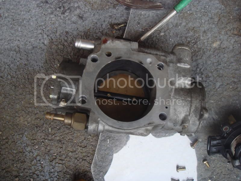

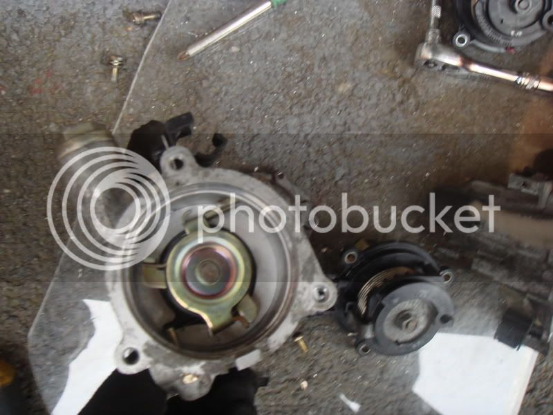

Took the whole TB apart to give it a good clean and put it back together. A few questions;
1) the motor on the TPS end, what does it do exactly?
2) with the APPS in place, as youu manually pull back the cable, mechanism inside only catches a lever when it is past, say, 75%. It's past 75% that the "flap" moves but only slightly, say 25%. Is this corect? Or is the instalation of the APPS no corret?

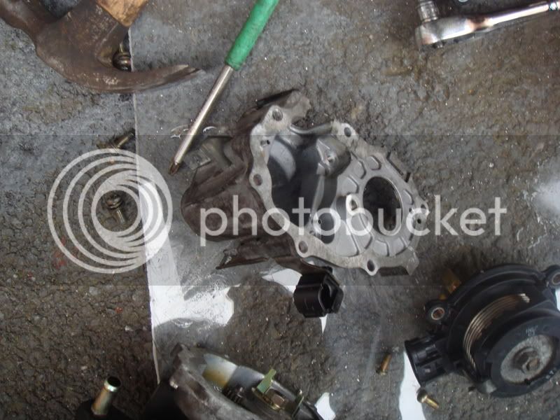

3) fault codes still read TPS & APPS eve though both have been replaced and TB cleaned.
As you reset ecu, CEL comes straight on as you start up, it's always there!

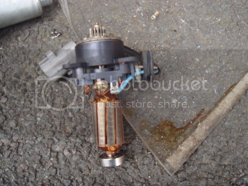

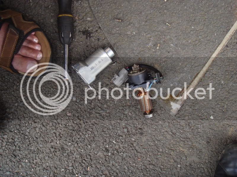

Some please tell me function of motor above TPS............ It run freely but does not tun the gear at one end........ looks like some kind of clutch?
Pulled TB appart for a clean.......
What does this motor do? If you rotate it, the gear at top end does not rotate....? Could this motor be the cause of my problems?
Can someone please tell me how this TB works? As in, if you twist the APPS, throttle/flap only opens when you're at 75%. Is throttle/flap controlled by this motor?

Ok, how is the air regulated? is, how does the throttele body adjust the butterfly/flap?

Just had car checked by another dealer, they tell me it's the Throttle Control Motor........ just ordered that at £200................... Bills keep building up
the 'motor' photographed is the throttle actuator motor, which is part of the 'throttle body assembly.' This is a 'drive-by-wire electronically actuated throttle, with a back-up mechanical link (cable) to enable you to drive perhaps 40 mph or so when the electronic gizmo quits. Lots of these things failed (and still do) on MBZ from about 1990 or so when the insulation on all the tiny wires in the harness crumbled to dust (bio-degradable wire insulation!)
You push on the accelerator. The accelerator position sensor tells the 'computer' how much to open the throttle. The computer sends the signal to the throttle actuator electronics, which engage the fail-safe clutch and turn the motor to open the throttle plate. A position sensor attached to the throttle plate changes in resistance, which the computer interprets as a position. When the measured throttle position matches what the accelerator position asks for, rotation stops.
Had assumed just as much. Will have changed all TB parts now........ The TPS & APPS I removed, might not have been faulty? :flipoff2:
