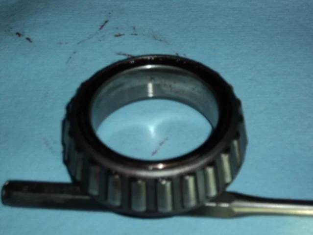

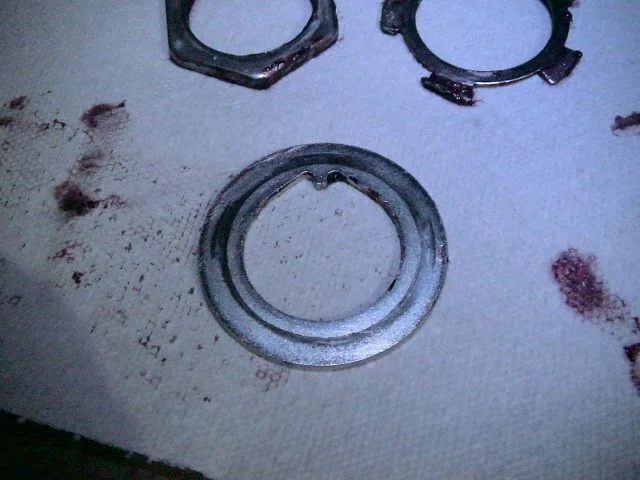

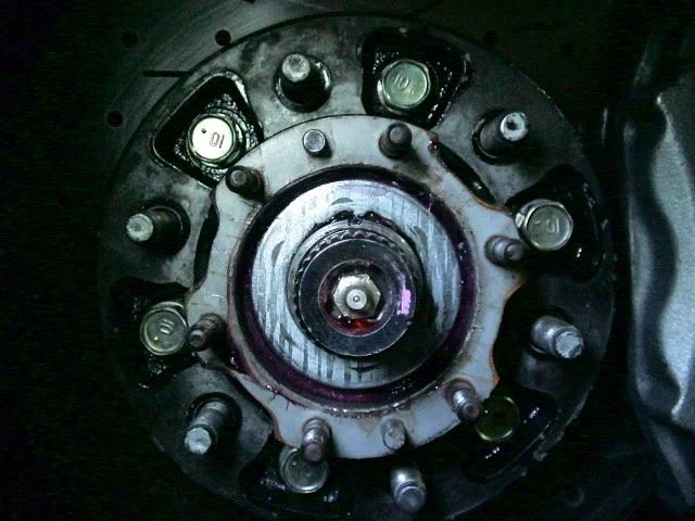

Noticed that my DS wheel bearings were loose by rocking the tire at 6 and 12 o'clock and got the clunk clunk. These were new bearings I put in a year ago when I did my first front axle service. Dug into it today and found the inner spindle nut hand tight if that. Also found that the new spindle washer had a slight groove on it's back side with a corresponding greasy black mark. Looking at the inner race of the outer bearing I can see some slight scoring where it's been rocking or spinning?? This spindle is the same one that I previously had repeatedly loose bearings and has wear at the bottom, so maybe it's time for a new one. Here's a few photos.

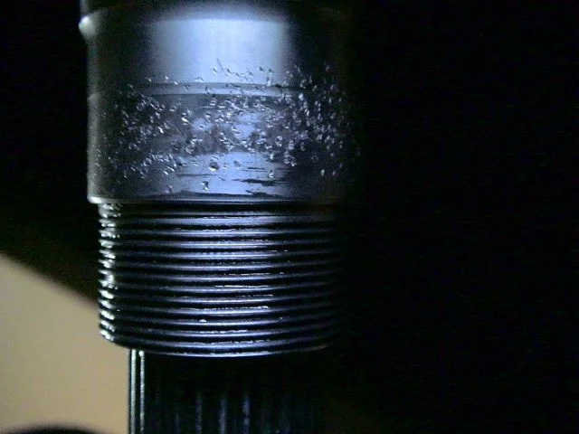

Pulled the hub and outer bearing. The bearing looks good. The spindle has more wear compared to 6000 miles ago so I went ahead and dimpled (staked) the end of the spindle where the outer bearing is located. Didn't have a punch so used a 2 inch #2 Phillips bit and a BFH, figured I couldn't screw it up too bad and may be needing a new spindle soon anyways. Before I did the dimpling the bearing slipped on the spindle by itself would rock at 6 and 12 o'clock but not at 9 and 3, so concentrated the dimpling at the top and bottom. After I was done the bearing fit tighter with no rocking. First photo from underneath looking up and then the top.
Mike; that could be the case; IIRC when I last touched these I finished up with the fish scale around 12-14 lbs but the readings were all over the place, maybe due to the new Mobil 1 red grease sticking everything together?? When testing using the wheel clunk method at 6 and 12 o'clock a year ago and then about 6 months ago they appeared tight, no clunking. But recently when I checked again they were obviously loose on that side. This was the same spindle that gave me problems before; the bearings were always loosening up. Now wondering if my brake pedal pulsations weren't caused by this also?? I'll know when I get it back together.

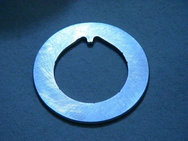

Sure to cause the pulseing. I tighten my bearings tight then back them off and then measure them. NEVER use old washers. Any out of round points on that spindle? It does look rough. MIke
The spindle has the usual wear edge on the bottom. The roughness you see in the photos above is what I just did so the bearing wouldn't sit as loosely on the spindle; read about that trick on Mud but never saw photos of how to do it. Someone discussed an old method that would do a better job, forget what that was called, sort of a pressing or rolling operation that would raise up some metal?? Don't have a new washer, maybe flip that worn one around??
Fixed the washer the old fashioned way, used a couple of flat files to file the back side flat; good as new.
I'm having this same issue on the passenger side of our 80. People like to jump in and quickly say you did not properly set the preload on the wheel bearings, but the fact is if the spindle is worn you CAN'T avoid them loosening, no matter what method you use. It very well could be a lack of maintainance from the previous owner.
In terms of setting preload, I think the fish scale method is horrible and instead just rely on setting the inner nut to 15ft/lb and 'feeling' that the tension is correct. So far it's working and the passenger side has not worked itself loose. Some mudders go as high as 20ft/lbs, but many vary between 10 and 15 with good results.
Thanks for posting a picture of your dimpling as that is my next step. Ultimately however I think spindle replacement at $240+ is the only real solution.
