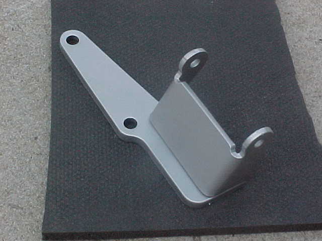

I mounted my sag pump off the air pump bracket.
Here you go. It was simple to make out of scrap 2x angle. It's stout and very adjustable.
Both are good examples of exactly what I'm looking for - the cradle part made for the sag pump looks simple enough. Where was the tension adjustment mounted?
Here's the rough dimensions. I just built it to fit the pump. The base of this allows a lot of adjustability front-to-back for belt alignment. There are two different lengths of air pump mount and I used the longer of the two, which I believe came from a 60-series truck. For tension adjustment, I used a Ford alternator adjuster, backwards, from a slightly longer-than-stock water pump bolt to a front bolt on the pump, which worked very well. I can probably find that part number if you need it. Pretty much any alternator adjuster could be made to work.
