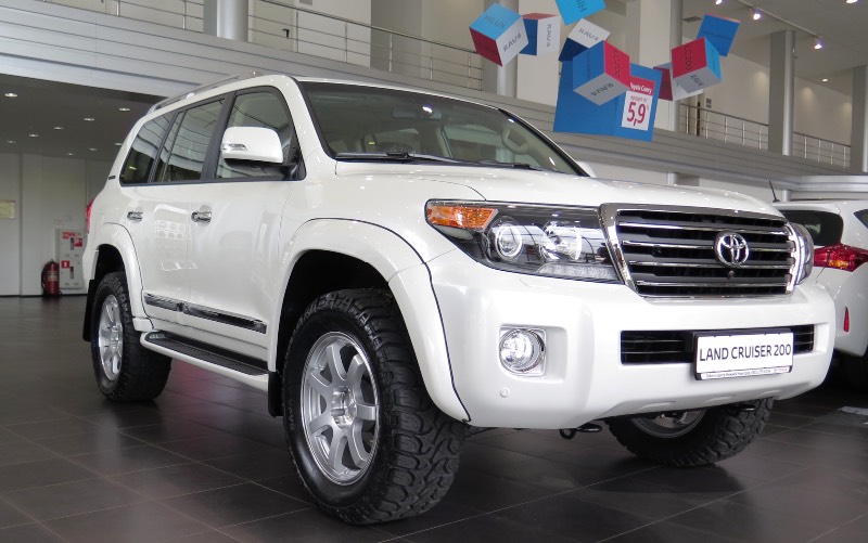

Here's my Arctic Trucks AT33 rig with R20 wheels an agressive 305/55 tires
I LIKE THAT!!!!!
I wish we could get flares like that!
Very very sharp.

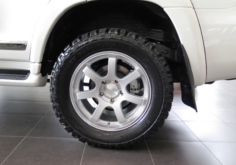

What's the story on the wheels, size, offset, brand and model would be great?
That wheel looks to have a very negative offset similar to the OEM wheels but yours are hangig out more then I think the should for ithat offset. there you have
PS. I am just curious, Is that Super white or Starfire pearl white?

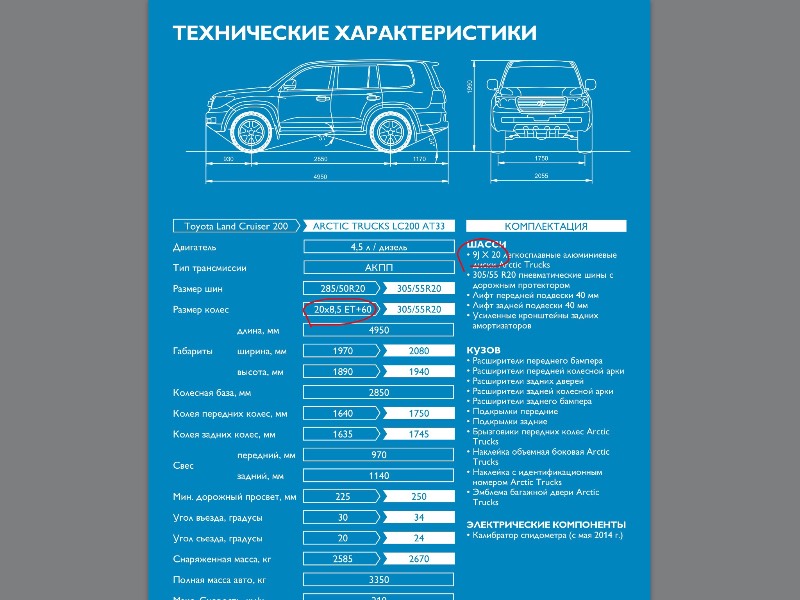

had to make a little research but I found what you need. The wheels that are used in Arctic Trucks AT33 are LENSO RT-7.
It looks like the wheel spec is 9jx20 ET+60 according to the Arctic brochure.
Hope this helps.
P.S The color is Pearl white
Cool thanks
I can't read th language, but the line under the wheel size mentions 40mm. I am guessing that's maybe the wheel spacers I thought it must be running to get wheel like that out there that far. The 9" wheels is worth 1/2 inch, the 40mm spacer is about 1 1/2 inch so together with the same stock 60mm offset you get about 2" extra with which looking at the flares and wheels combined that looks about right.
you are welcome.
40 mm stands for lift. there are no spacers included. to fit the wheels they cut the flares though.
Hope this helps.
I've always liked Arctic Trucks. Beautiful rig.
I run the same size tire and similar wheel size (20x8.5"), and there's no way that wheel fitment is +60. At that offset, the tire would be contacting the upper control arm.
Looking at the AT33 stance compared to my own car which has 1" spacers on stock +60mm offset 20x8.5 wheels (+35 effective offset), my calibrated eye says that's more in the 25mm offset range.
