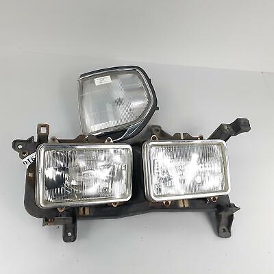

About a billion of them here in Aus as @mudgudgeon said. You should look on ebay.com.au, or you won't see listings that don't advertise postage to the US. There's this one for example:
But you'll see it only advertises postage to Australia. If you search on the ebay.com site you won't find this one doing the search. Best bet is to search on the Aussie site, and if it's listed as Australia only, contact the seller and see if they're willing to post internationally. You'll need the surround as well as the light cluster, which looks like this:
I prefer the quad style myself, as long as you've got the semi-sealed halogen style, which take the H4 bulbs. You can put in good globes for a nice bright light, and no crappy plastic front to scratch or go hazy. Fit the headlamp protectors to make them rock-proof and they'll last forever, and they're set back to protect them from getting broken, even when bush-bashing or in a minor fender bender.

Do you also need this per side?
That's not a surround, that's actually an empty housing. One of those is attached to the back of the headlamps in the first link. Don't buy that separate. All you need is the housing with lamps, springs, and mounting rings present, then the surround to go over the front.
Now, picking one with the semi-sealed halogen globe type could be trickier. This one I linked to earlier however, is that type, confirmed by the VIN, and that it looks identical to mine:
Here's what the outer most lamp should look like on the semi-sealed type:
The inner one will look similar with slightly different markings.
