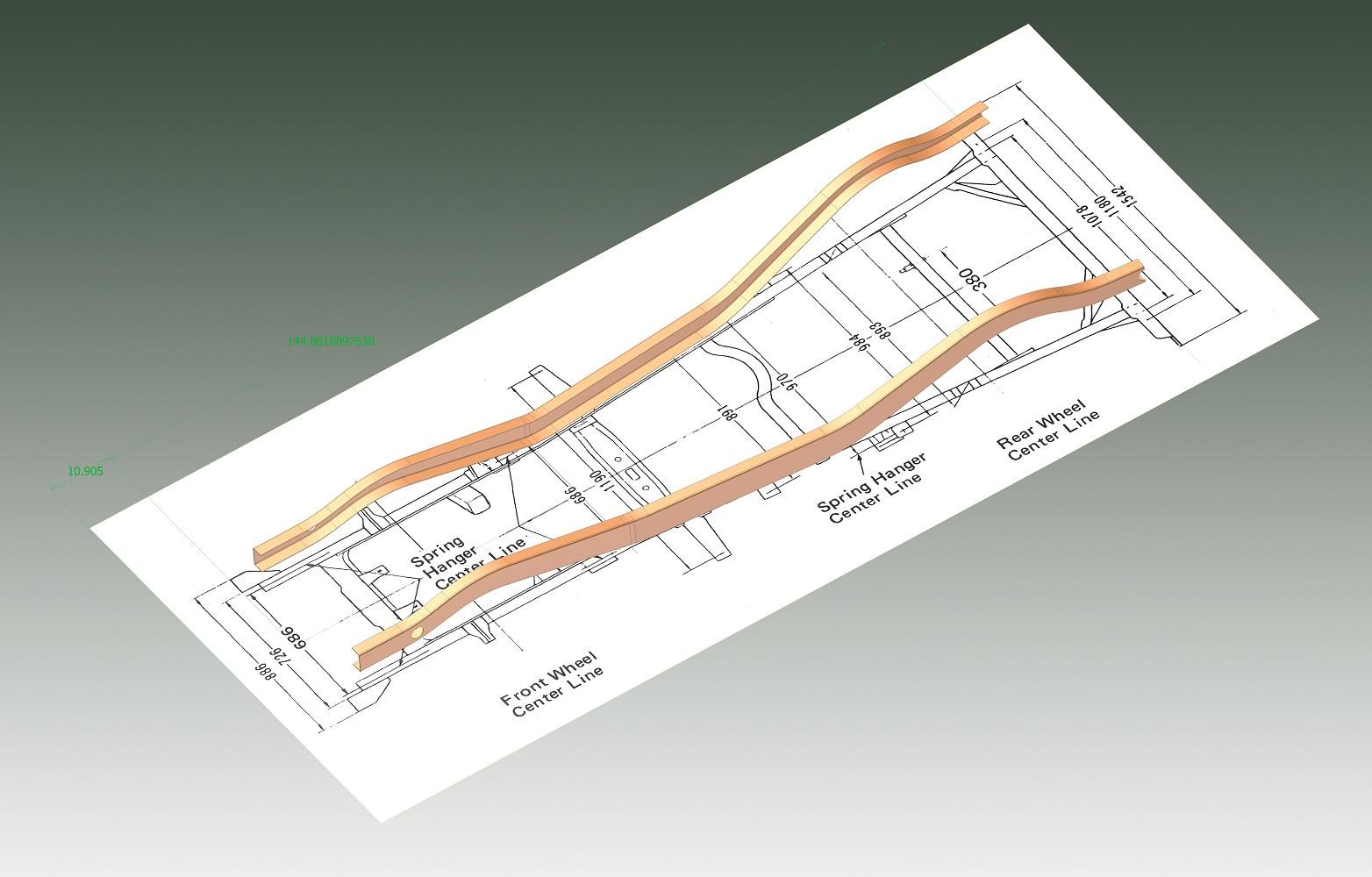

Here's a couple teasers, (these are before I made the bend outward, that bend will be confirmed with the hole centers from the body mount brackets once those are completed being modeled

Once I finish modeling the brackets I can assembly them in and tweak the frame rails to give the correct dimensions, right now some of the angles are best guess and rounded up or down to the nearest 1/2 degree and I am also rounding my inch measurements to the nearest .5 mm conversion, as mentioned before, based on the model of the rail I created and what the sheet says, my first pass was 144.882" long, and 3680mm's equals 144.881" (so I think .001") is a good lead off for using a scanned drawing.
I used the bottom edge of the frame rail as a reference to draw my profile and measured the rail height at each "bend" to determine a true width, the above pic was way off concerning the width of the frame rail in places

Here's the assembly layout, of course once I get the brackets modeled and in the assembly I will adjust the dimensions a little to make sure those hole centerlines are the controling dimension as laid out in the referenced image
Wow! What software are you using?
