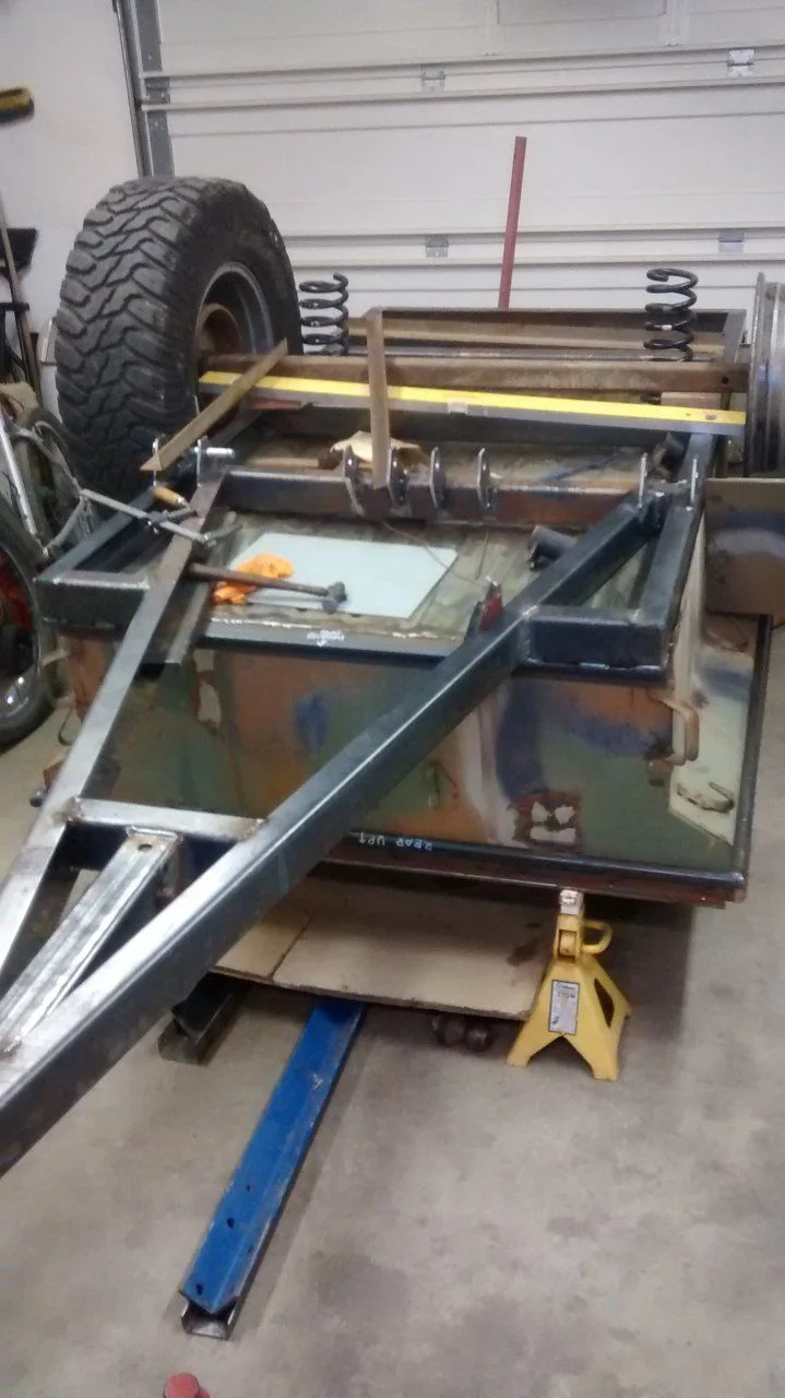

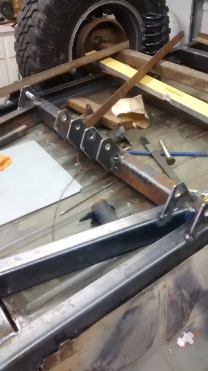

Man, I've scoured the internet and e-trailer is the only place I can find with a parking option but I want to get 6 lug hubs and spindles. I seem to come up with a #42 spindle and then miscellaneous hub set ups. I didn't find a source for the cables for the parking brakes. E-trailer has some poor reviews but I guess that is due to the volume of sales. I had thought of using old spindles off of an early fj40 drum brake but I think it would take more work than its worth. I had also thought of using mini truck drums and backing plates but I like the idea of having electric brakes on a trailer too.. This will all be for a heavy M416 build, extended tongue and heavier frame.
Pictures of my current status. The axle I have is a 6 lug with bolts, not studs on a 2x2 tube and is a bit rusty.

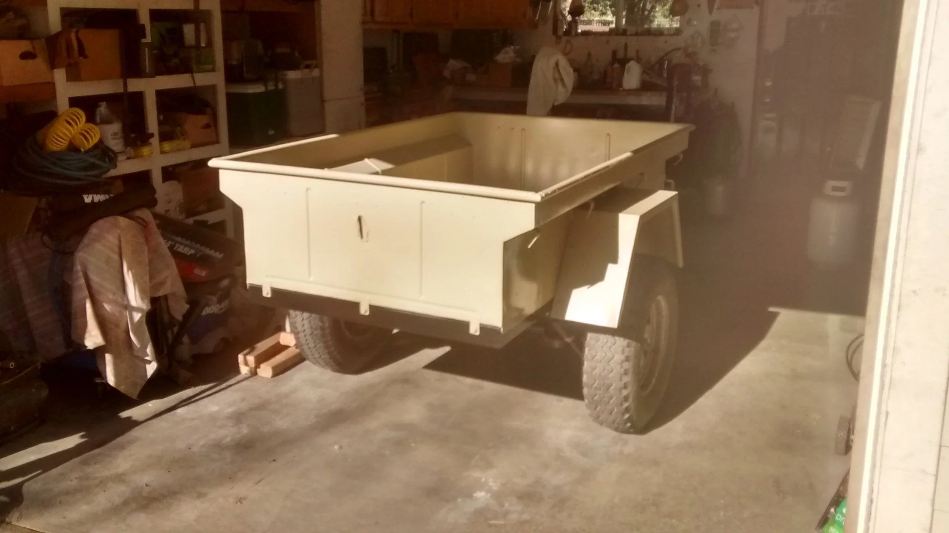

ended up going with rockwell american parking brakes but they are chinese and the same as the ones being sold on e-bay. There was a vendor that was a mom& pop outfit.. the axle was dexter and I don't thing the brakes are really true, that's OK. It was pretty easy to source a a 6 slug 3500lb axle. I will get the width I wanted next time, I shortened it and had some alignment issues- too much toe in..
It's getting closer, needs lights and brake wiring and the parking brake. Looking to rig up a rigid cover too. No idea of weight but I would assume heavier than stock, the frame is much thicker steel.
