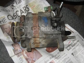

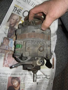

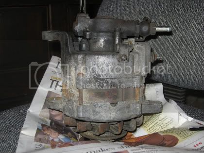

If you are not able to bring your Alt by then I would at least need some pics to help ID it.
Here are a few pictures of the alternator. If you need different or better pictures, please let me know. I live in Massachusetts, so we'd have to work out shipping.
Looks like we do. Reman 27040-68030
2H/12H-T Alt 24v 50a IC reg
Short vac pump shaft.
Larger body, 4 bolts holding the 2 halves of the Alt body together.
Have to get a core back.
