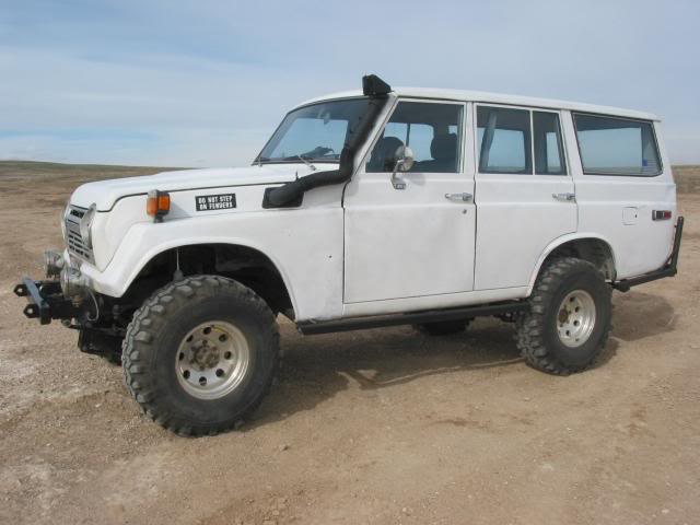

Here's a pic with factory leaves in place of the bottom 3 leaves, alcans on the top. The angle isn't too bad, and those are 33" swampers.

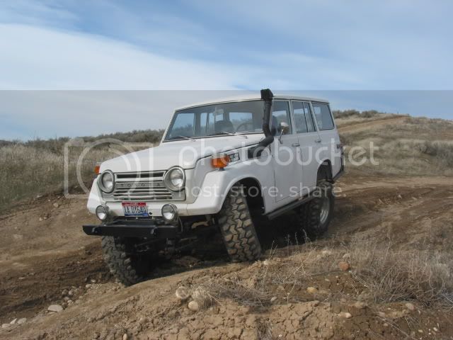

In the pic I don't think that flex is a real issue up front, you could get even more if you just flipped that front frame mount around to get a better shackle angle. Quick, easy, FREE!

First pic, flex with 33's and partial alcan/stock pack
Next pic, full alcan packs front and rear.
