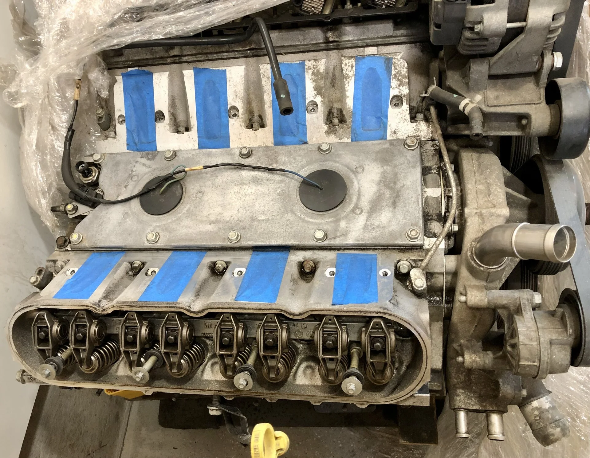

- all aluminum L33 LS with 40k miles (needs a tbss complete swap)

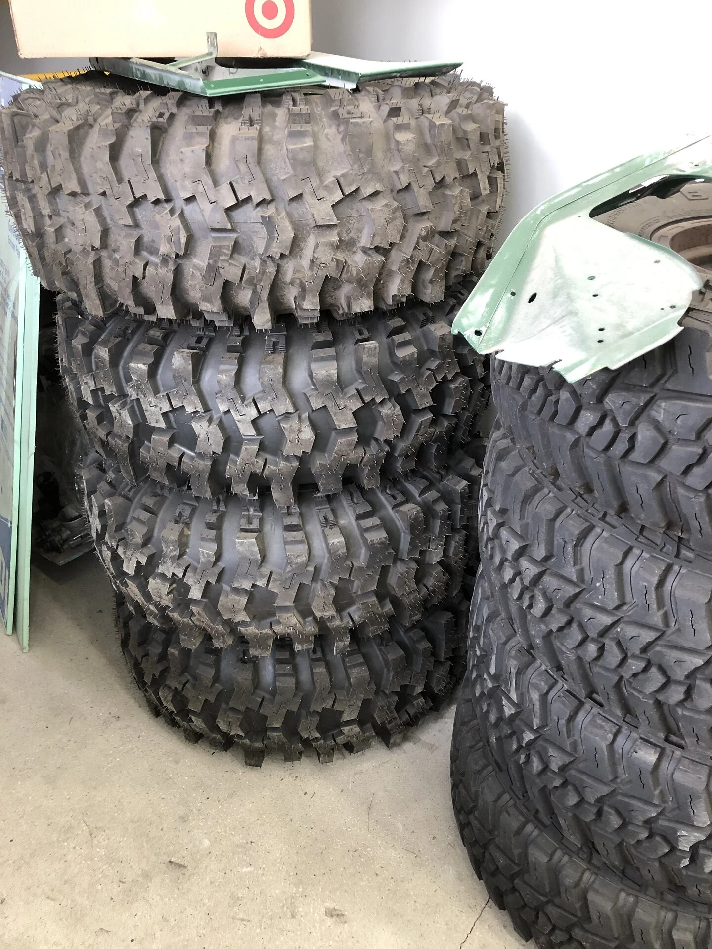

- 40 MT Baja boss on beadlocks

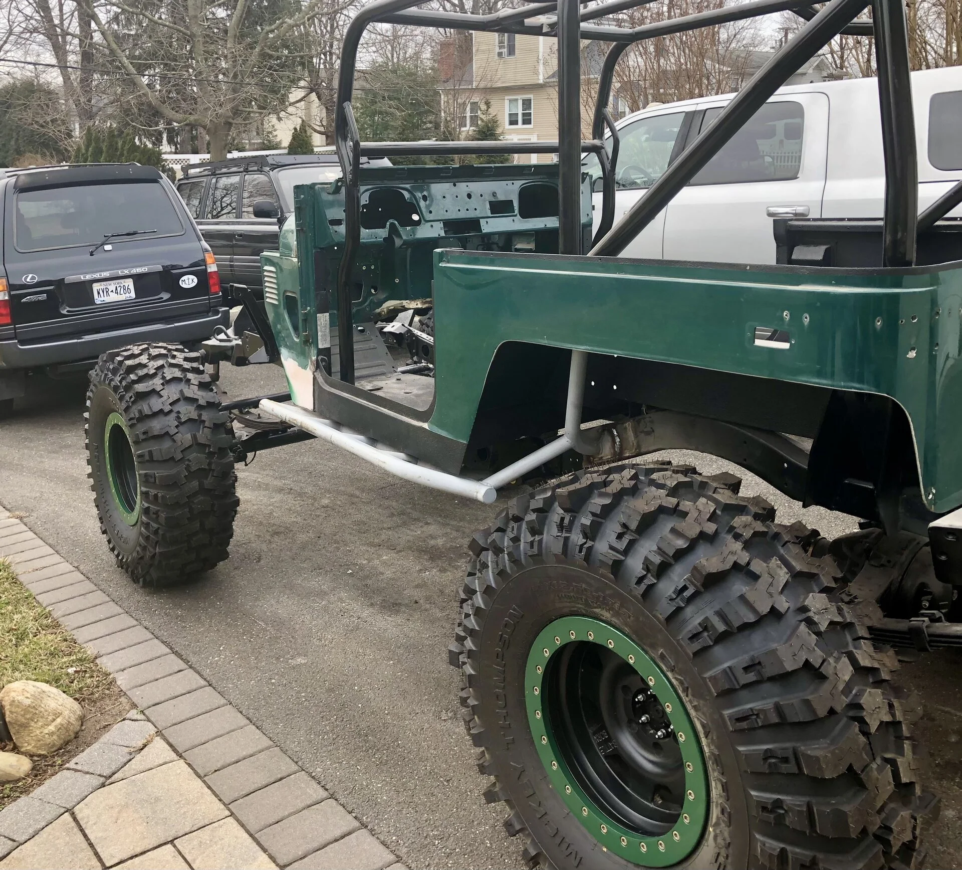

- metal cage roll cage (will need to modify it to add seats and some sheet metal on top so I can add electronics)

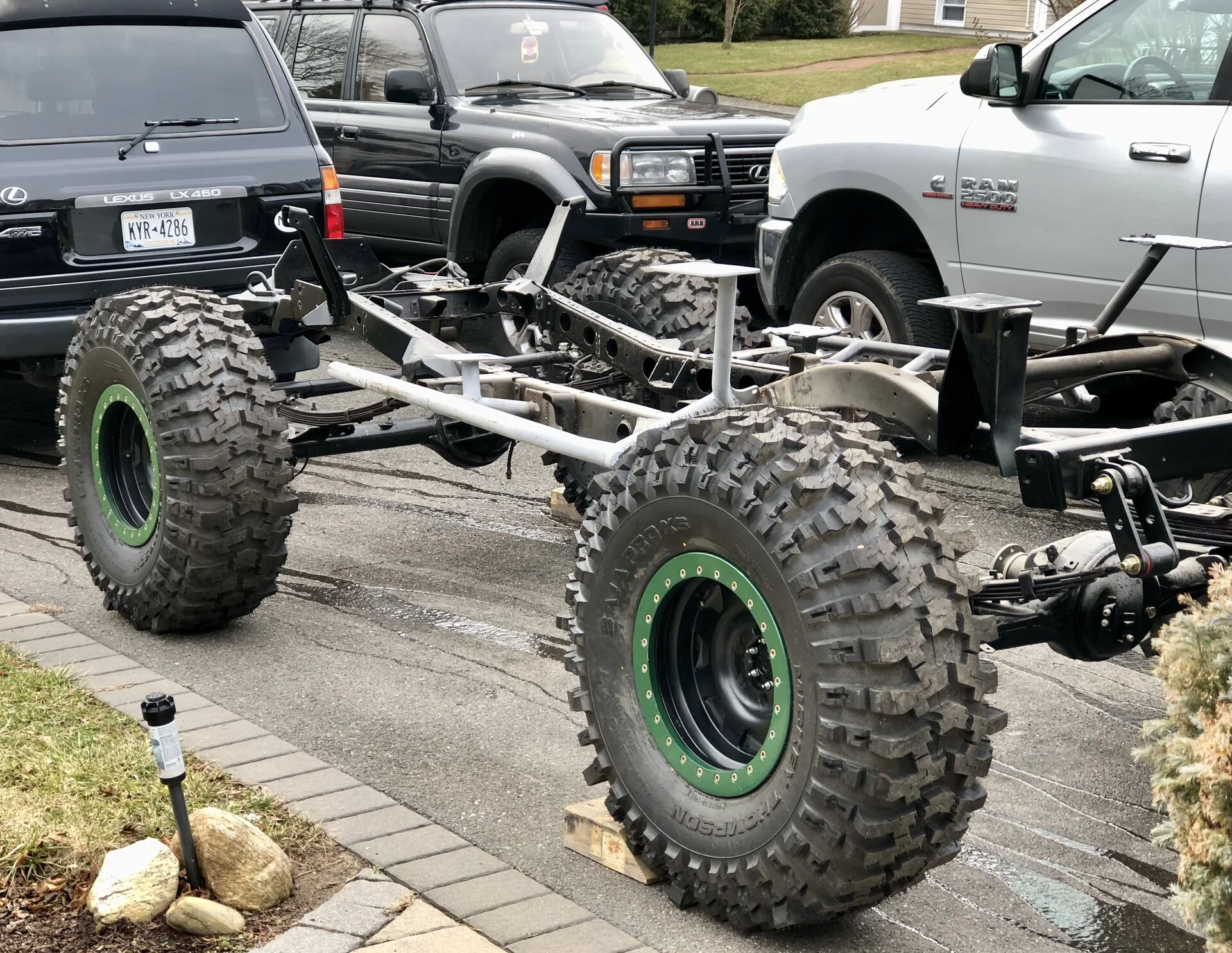

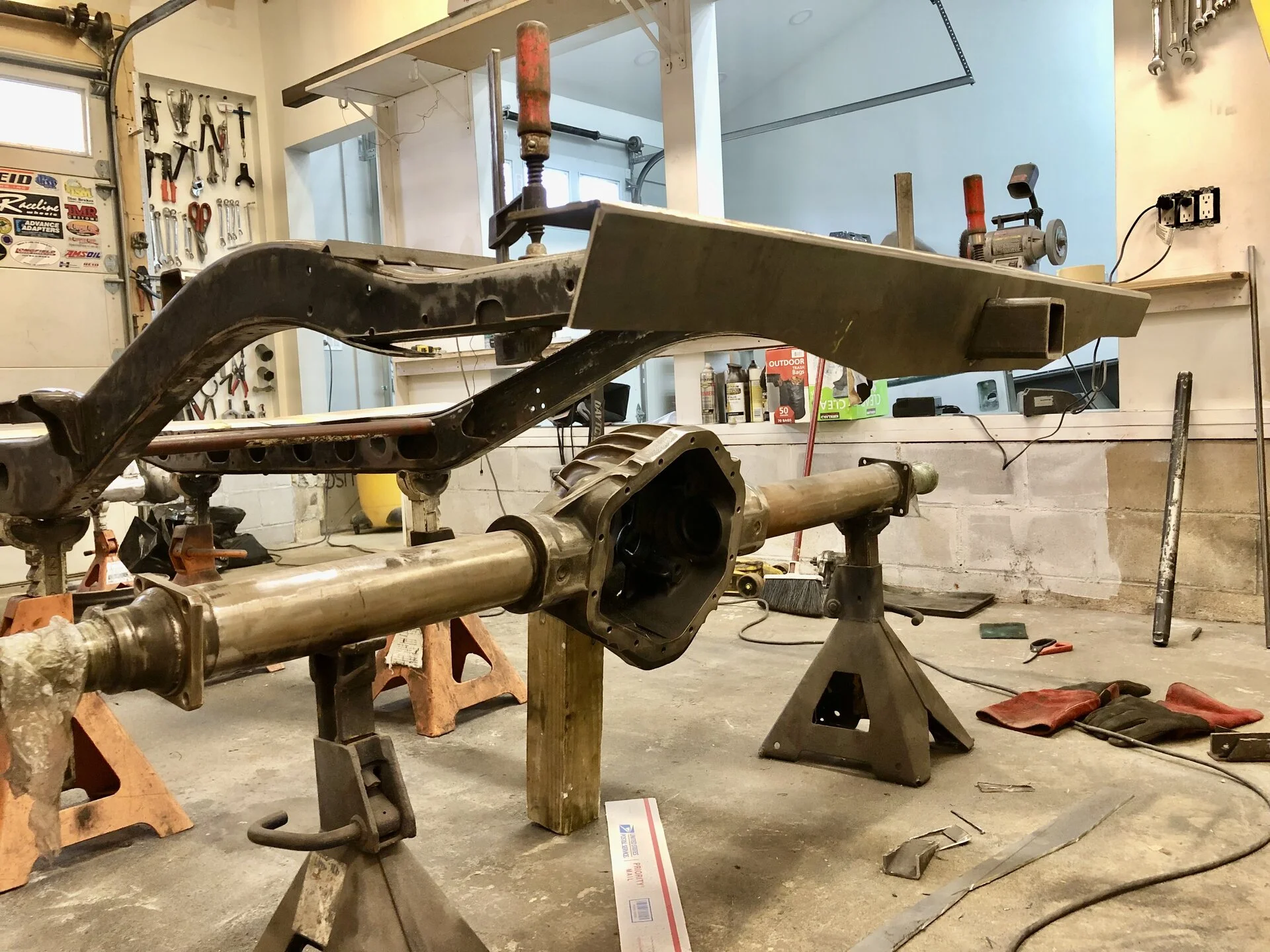

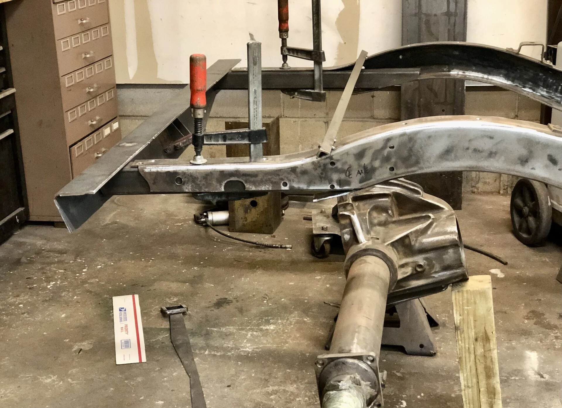

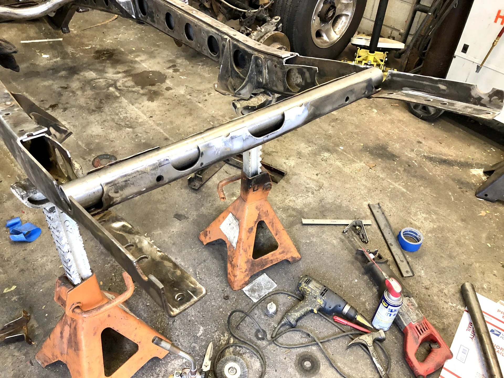

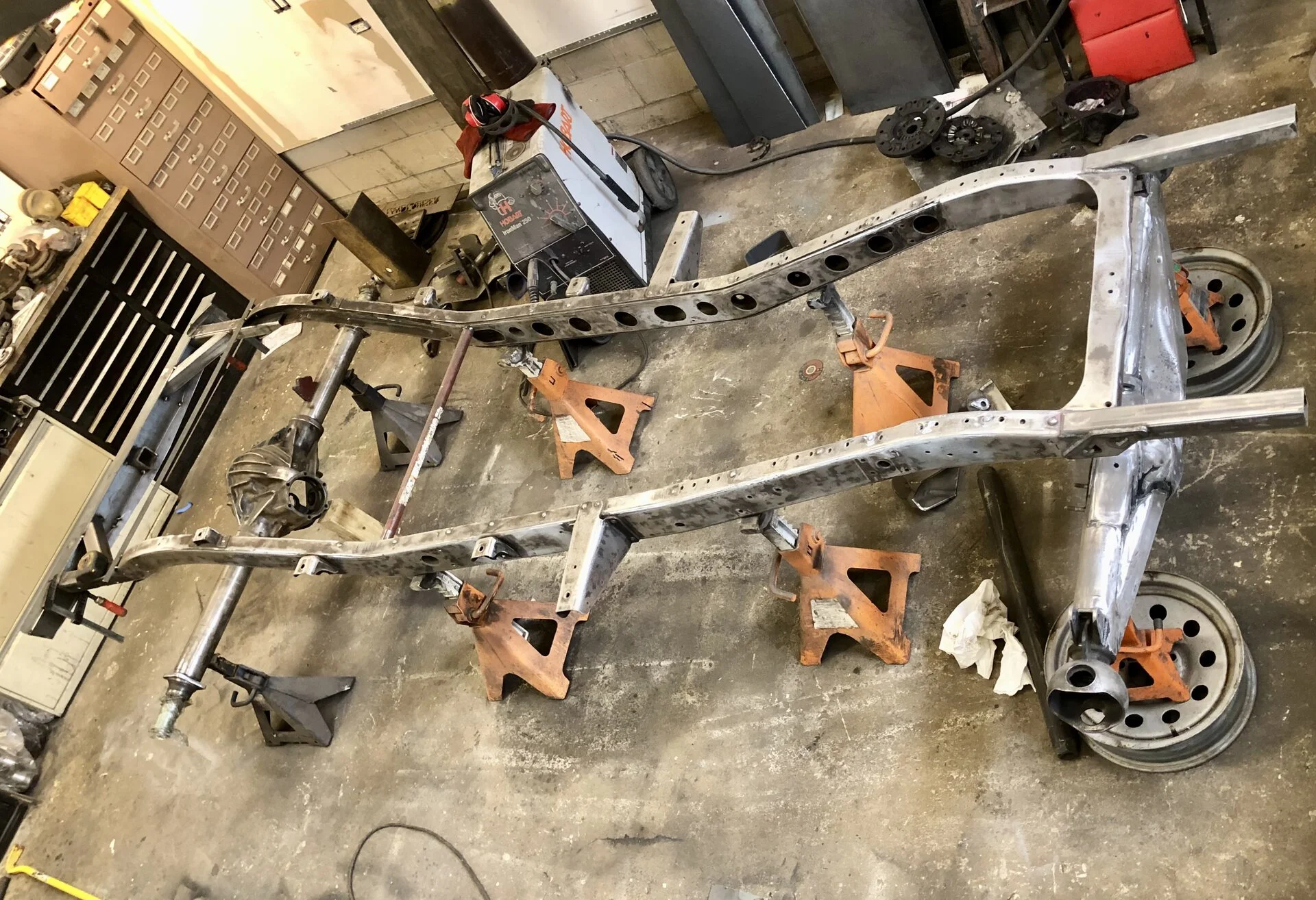

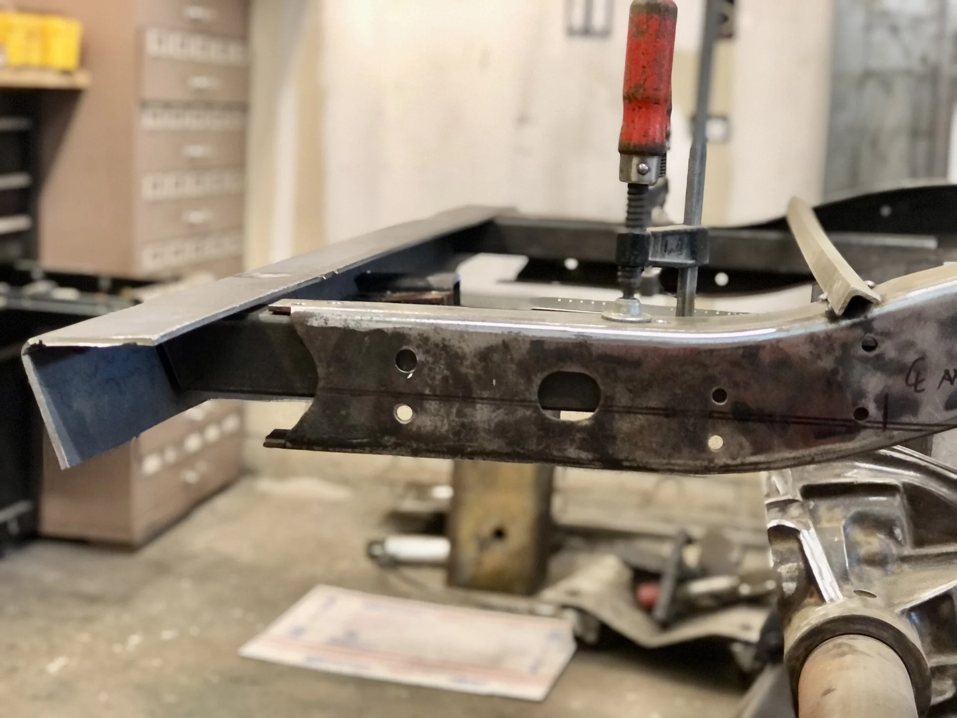

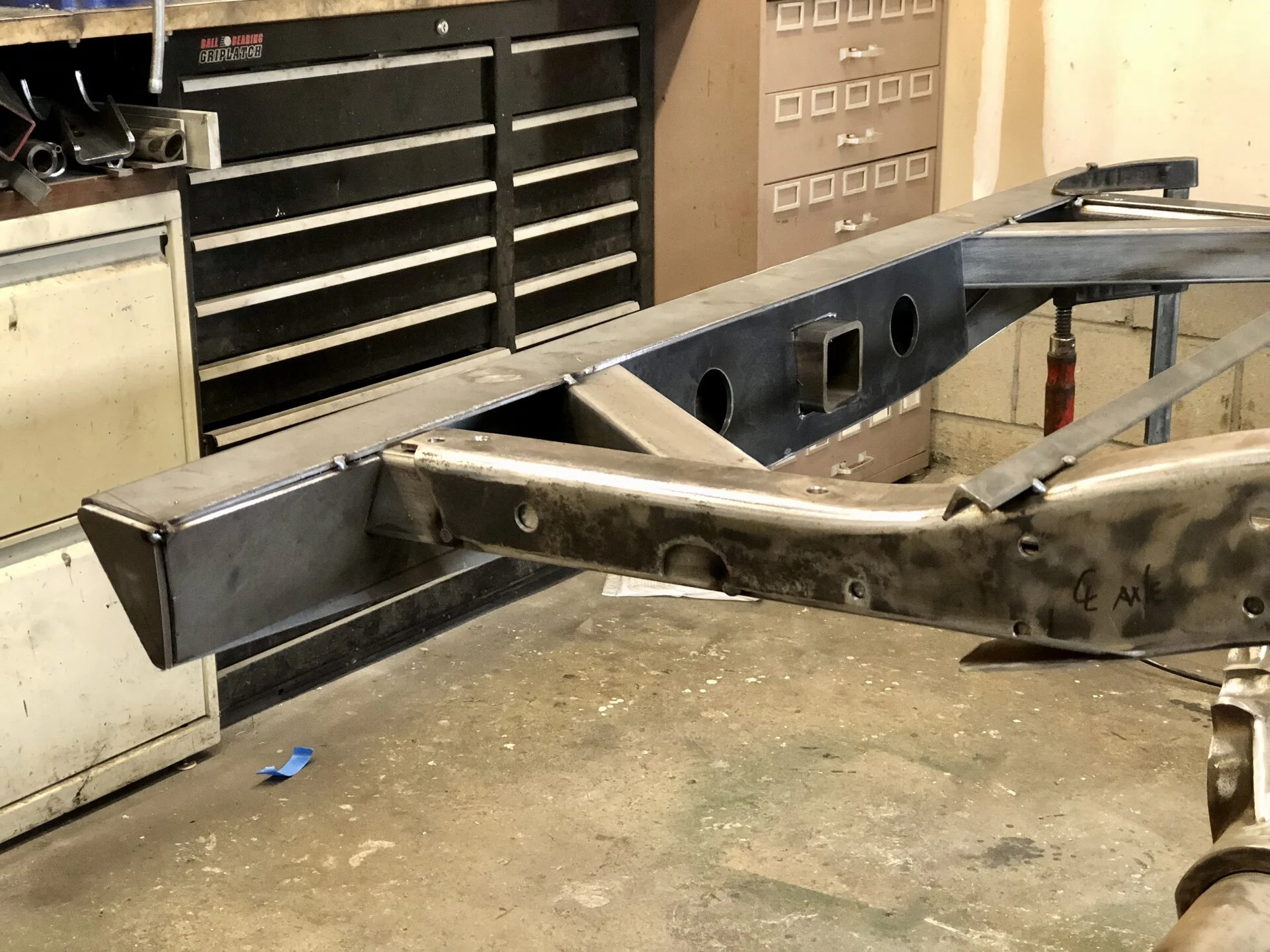

Here’s what I got so far; front is almost completed, the goal is to clear the steering linkage in order to keep the ride low. Rear is half way done, extended the frame 3” out to have a bumper and eventually create a cradle with struts to hold a 40 spare in the center of the car.

Started as a fj60 rear center section, with 1/4 DOM tube, used 80 knuckles balls, 67” WMS and 6* of positive caster. I bought this axle a while ago from another member who built it at his shop.
