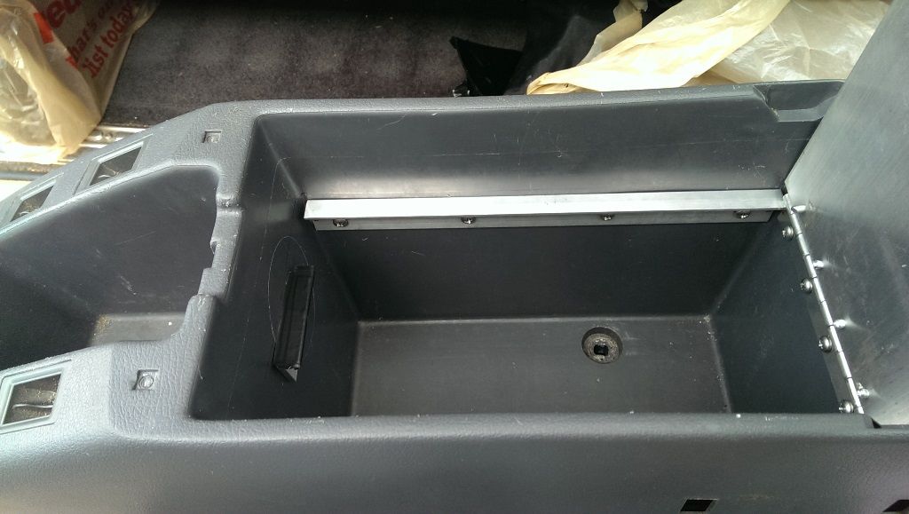

I finally had some time to get back to this so I thought I would give an update.
I ordered parts a couple weeks ago from McMaster Carr, total price was $25 + shipping (~$10) and fastener costs; part numbers listed below for what I used. Cut out most of the pieces last week and installed today. While it could have been better, I am very pleased with the result and think it serve me very well. When I get a pad installed it should look very clean when closed. The one thing that I need to figure out is an easy way to keep it propped open, right now it won't stay open by itself since it hits the hinges for the upper console but I didn't want to leave notches for them which could easily turn into pry locations for a thief.
The basic change I would do next time is find a better tool selection; I only have a cordless drill, a jig saw, and basic mechanics tools. Cutting the plate out neatly and cutting the "double D" hole for the lock were the most challenging parts and didn't end up as nice as I was hoping. I ended up having to file out most of the double-D hole since my saw blade didn't fit. Ugh.
Parts:
  • 1x 6x12x1/8" Aluminum plate (cut down to ~5.5" x 10") - 8975K921
  • 2x 12" 1"x1/2"x1/8" Aluminum angles (cut into 2x 10" pieces and 1x 2" piece) - 8982k91
    • It would be better to have 1x 24" angle, cut into 2x 10" pieces and 1x 4" piece.
  • 1x 12" Aluminum piano hinge (Cut down to 5") - 1581A521
  • 1x Combination Cam Lock - 7138A14
  • 14x 3/8" stainless self-tapping screws (1 box) - If these don't end up working and start backing out, I have some screws that are meant for plastic that I will try (tri-lobe type).
  • 4x rivets (to attach the lid to the hinge so there aren't any screws accessible.)
I still need to install a cover over the plate to prevent rattling and maybe install some edge trim on the lower pieces to also prevent rattling. Right now I just have some electrical tape on the latch angle to provide some rattle prevention which is why it is black instead of aluminum colored. I have considered just using some plasti-dip but I don't really want to take this out again to do that properly.
Current pics attached. I will try to add a loaded up picture when I get the anti-rattle felt/padding installed.

Love it! It's actually where I started with my mod but wanted something more secure. But this is a really nice build.
Thank you! Although, if I hadn't already ordered parts when your lock box was first mentioned I would have waited. It wasn't so expensive that I can't yank it out and seal the holes if I end up needing something more secure down the road too. :)
Out will be easier than in; to pre-drill the holes on the long sides I don't have a drill that will fit in the console that direction so I ended up using an old keyed drill chuck and spinning it by hand. That method of drilling worked surprisingly well though and I only had one problem with a hole not lining up which was more due to the console straightening up to match the aluminum angle than me drilling in the wrong place. I hadn't realized how not straight the interior of the console is until I got the angles in there. The angles really add rigidity to the inside of the console as well, not that I have ever heard of an issue there.

Here is a final image with some Wit's End swag.
Not seen are some self-stick felt tabs (for the feet of chairs) on the bottom of the door to prevent rattles.
