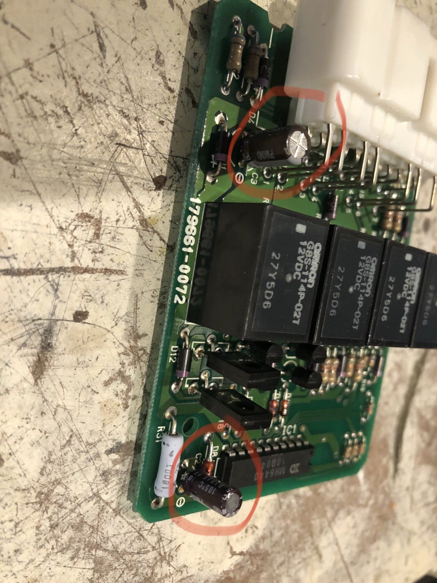

So, I checked the grounds, and that made no difference. After looking at the EWD, it looked like it basically had to be the Diff Lock ECU. I unplugged the ECU and the stuck light went off immediately which confirmed my suspicion. I opened it up and saw no obvious damage, but I know that capacitors from this era do eventually dry out and cause issues. So, I replaced the only two capacitors on the board and that seems to have fixed the issue. The light turns off like normal every time. Unfortunately, this probably means almost every cap in the car is probably shot or well on its way...
