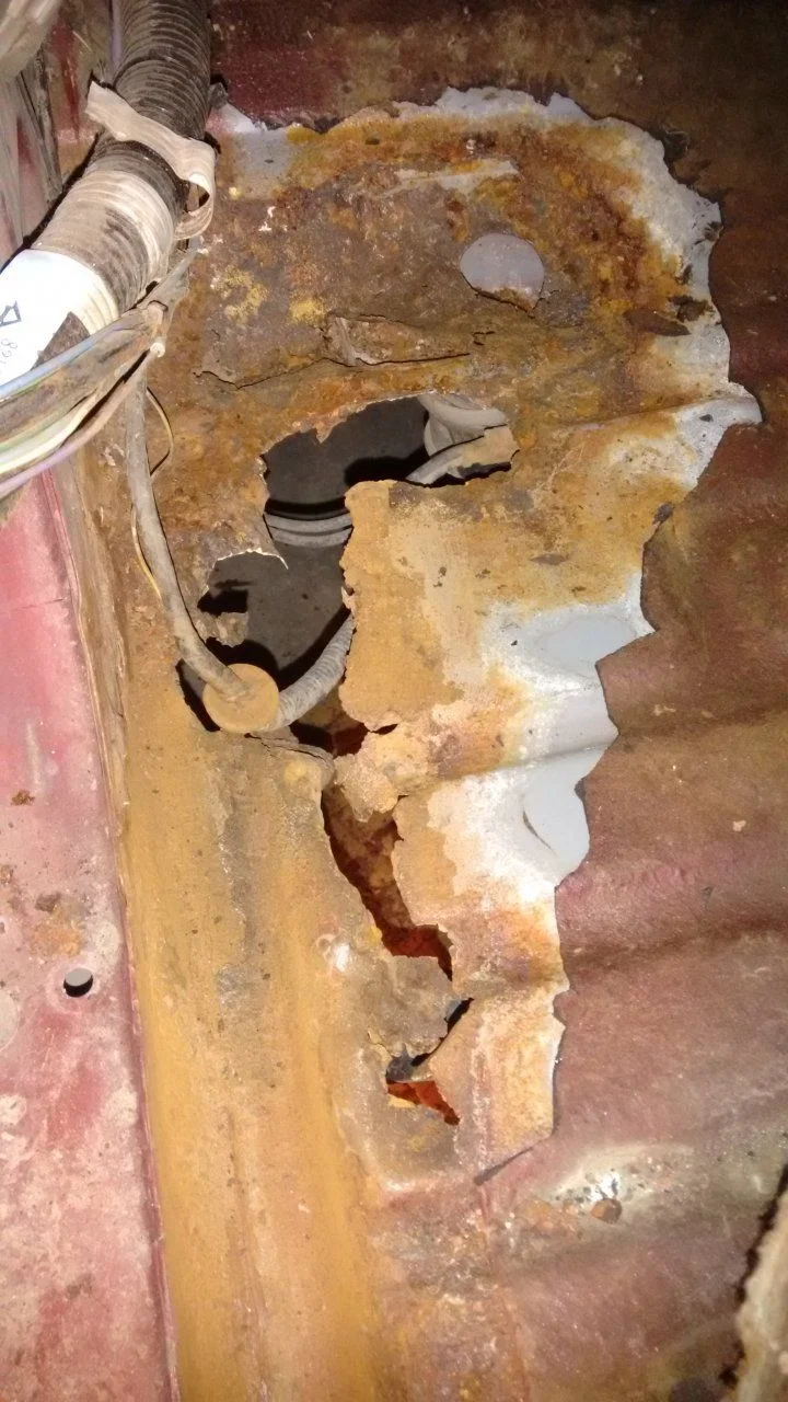

I was going over the truck & trailer today in preparation for the kokopelli/canyonlands trip and discovered that I'm about to do a Flintstones imitation. Something has been leaking and rotted out my DS floor board. Probably the windshield.
I'm going to call Justin @ Redline and see if he has an 80 body that I could buy a floor board out of, but I'm not going to have time to put it in.

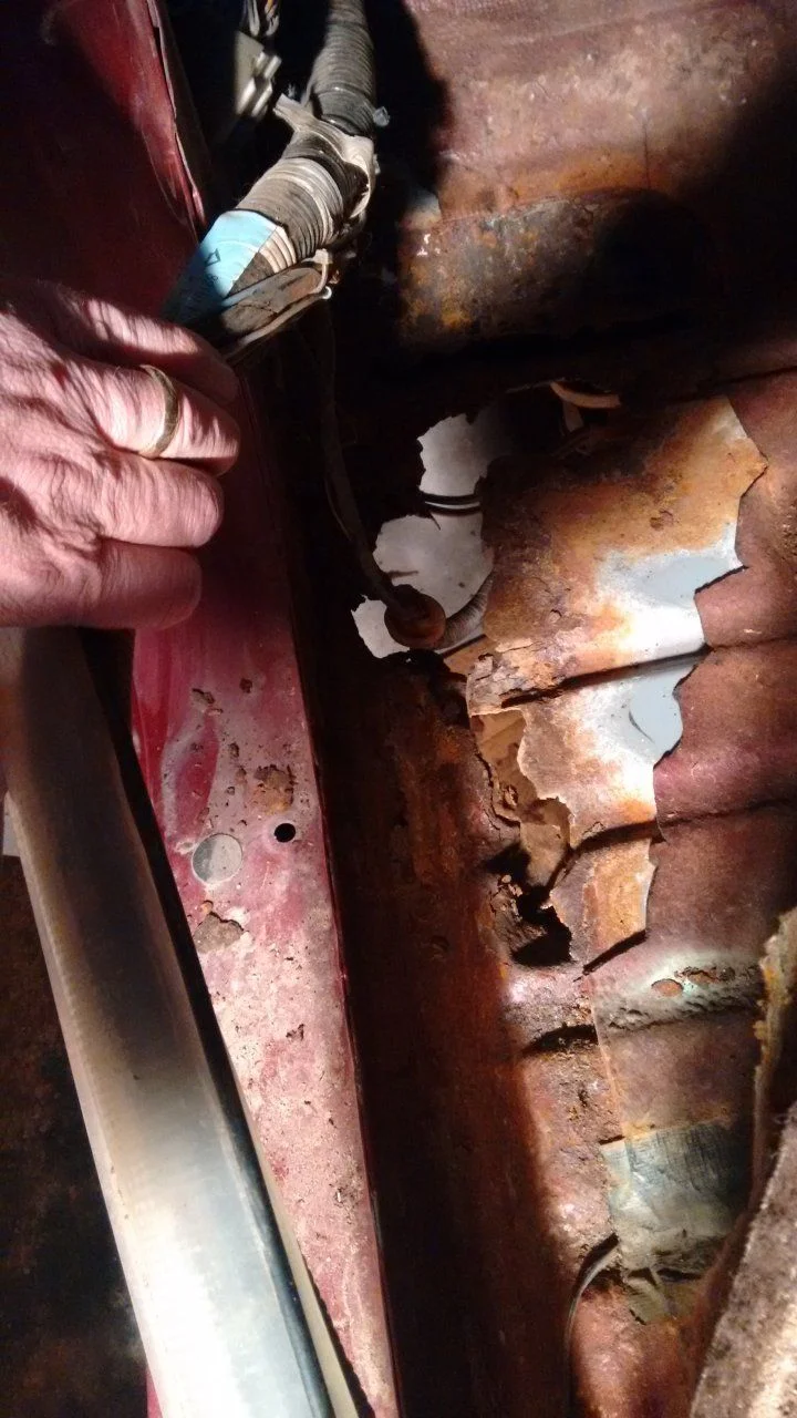

I haven't chopped it out yet, but it's pretty bad and goes up the curve in the front and probably on the side. But yea, I should get a better look at it before I go nuts.

Not good :( this is just the stuff that fell out tapping it with a hammer. Cutting back to good metal will be worse.
A better pic
So I think I'm going class an it up as well as possible, then rust reformer, primer, paint.
Then cut & bend a piece of steel and rivet it in place with some kind of sealant in between. Any thought on the sealant. ? Was maybe thinking of that asphalf roofing caulk.
body seam sealer is what you want. expensive but its what the pros use.
OK, thanks - will try to pick some up today. Do you think I can fill those corrugations on the right side with that stuff?
I see better now. If it is meant to be temporary why not use cheap silicon, a small patch of sheet metal and some self tapping screws? Maybe I am missing something.
its pretty thick stuff so i would venture to say yes.
