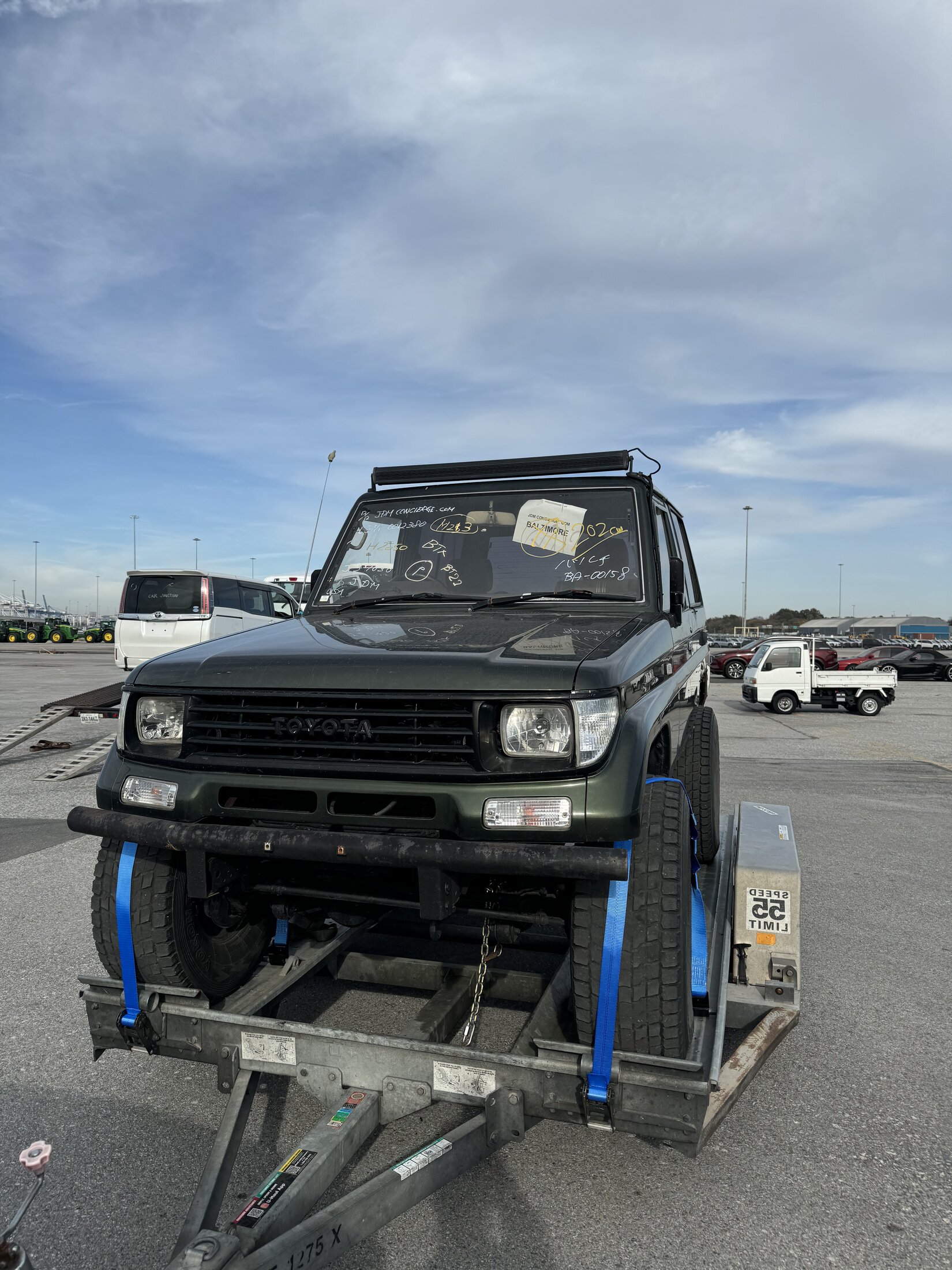

Here’s a build thread of my LJ71. Arrived in Port 10/30 during the CKCC Fall Crawl, I picked it up the next Monday.
This truck was imported for very very cheap as it has a good amount of body rust and is a 2LTE. My goal is to build it out as cheap as possible and make it capable enough to do medium trails and not feel bad if it gets torn up.
It showed up with 240xxx KM, bald and cupped 315 geolanders, a ton of hacked up wiring, a rusted out dump pipe, a broken front shock, unknown lift coils, about 10 lbs of excess random wiring, clear coat is failing and a led light bar with a short. I couldn’t start it at port as both batteries were dead. When I did get it to start it sounded awful. I suspected a broken pulley, which was correct.

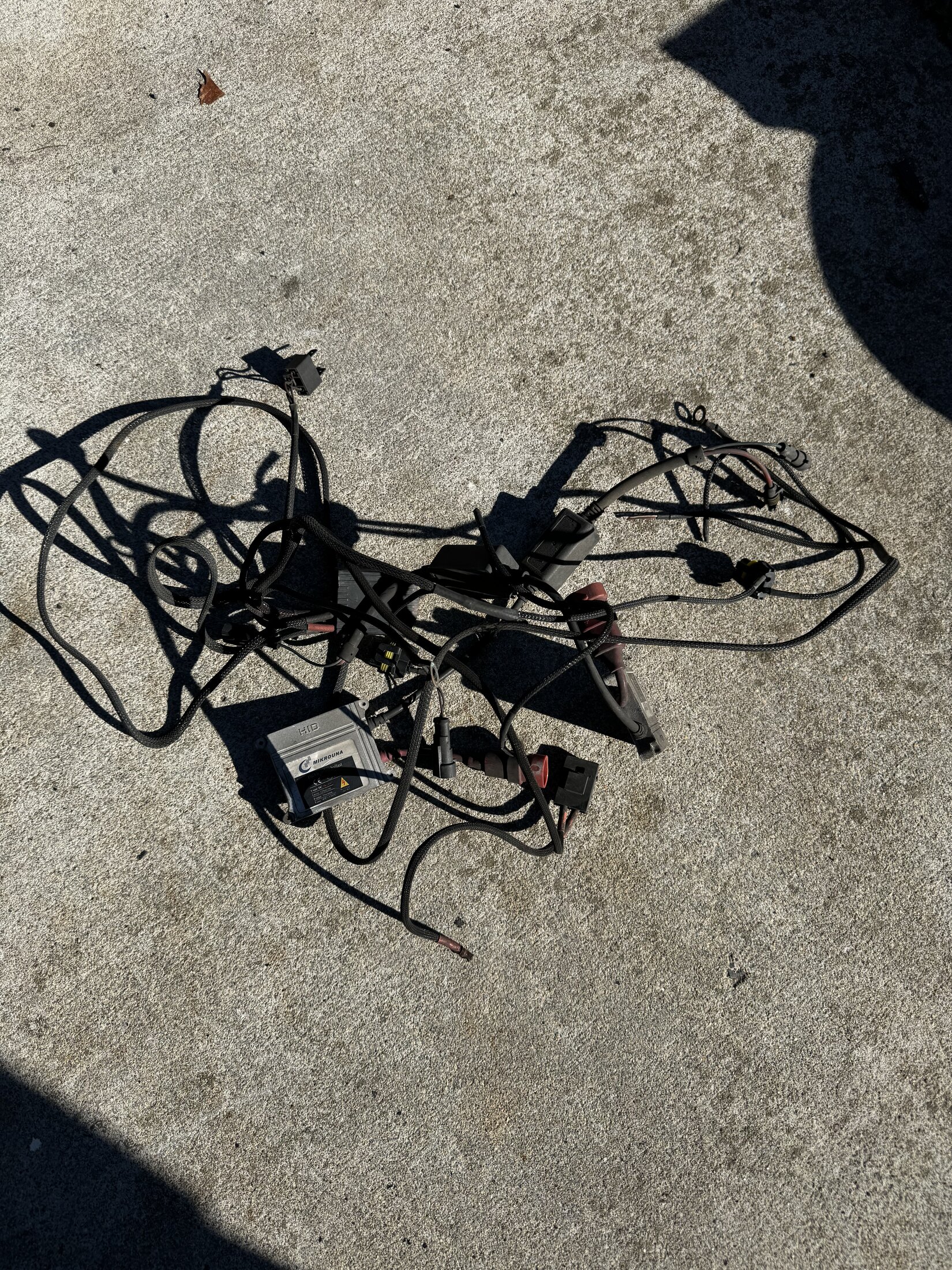

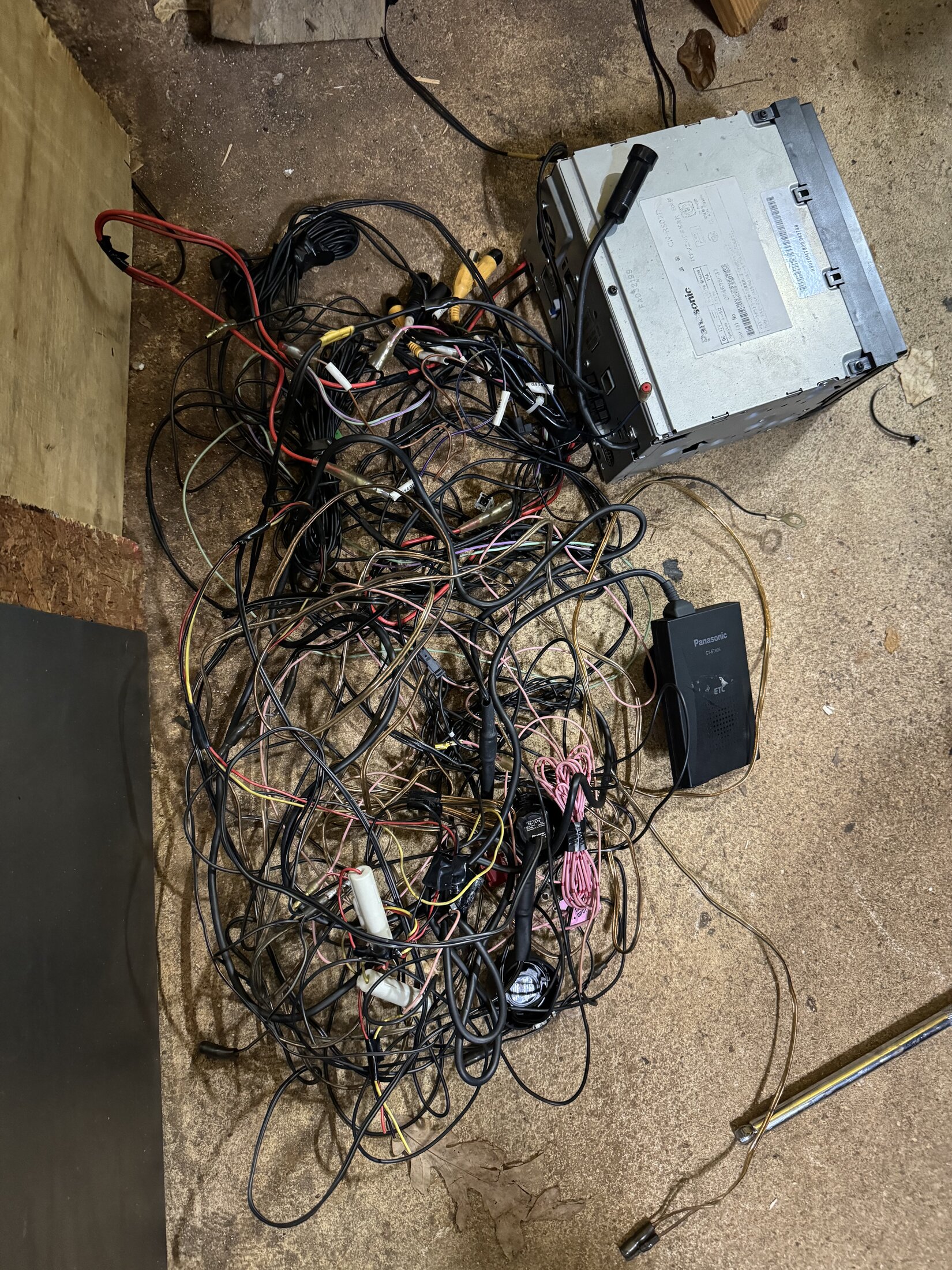

Next I started removing ton of useless wires. The toll reader, a Japanese old radio with TV etc. wiring for subs and speakers, random wires twisted together.
I pulled the dash and found more spaghetti hidden behind. There were weird little switches mounted inline to the blinkers. I removed them. The light bar didn’t work. When hooked up directly to battery it got really hot, must have a sort, so I removed it.

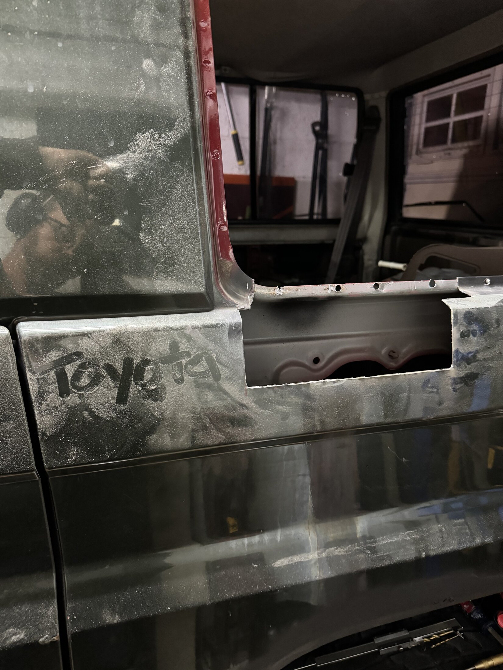

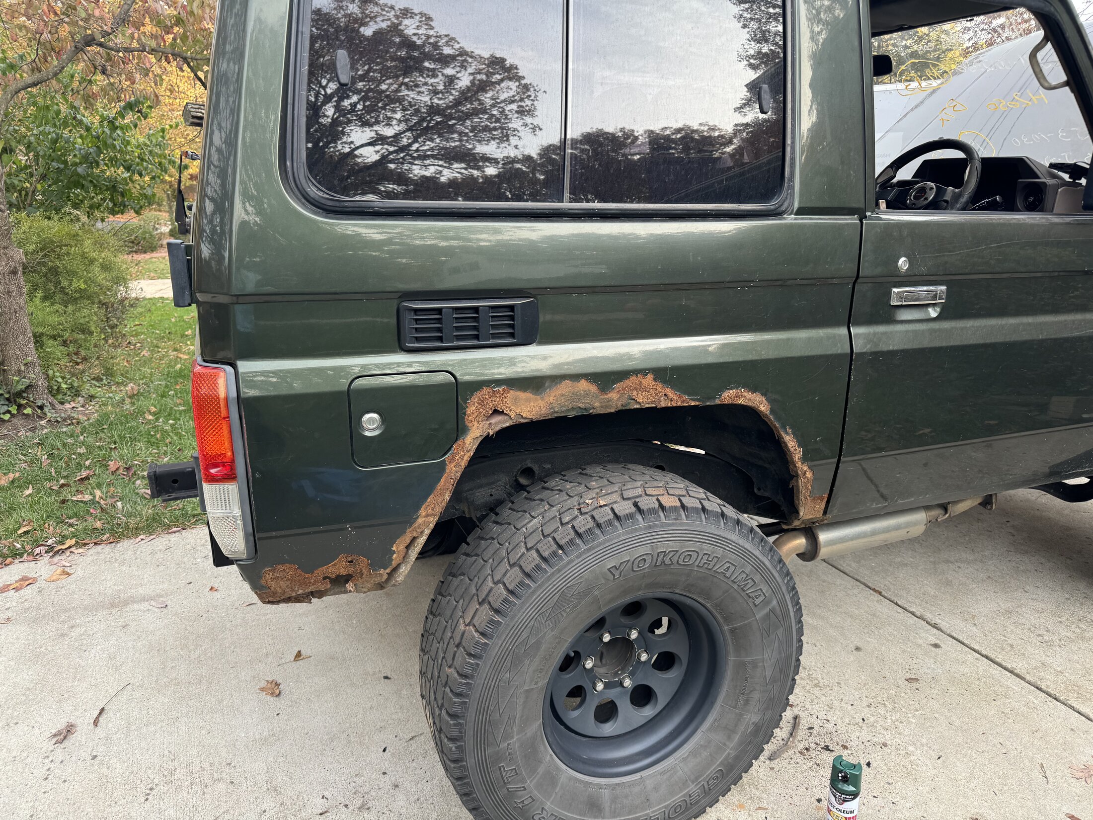

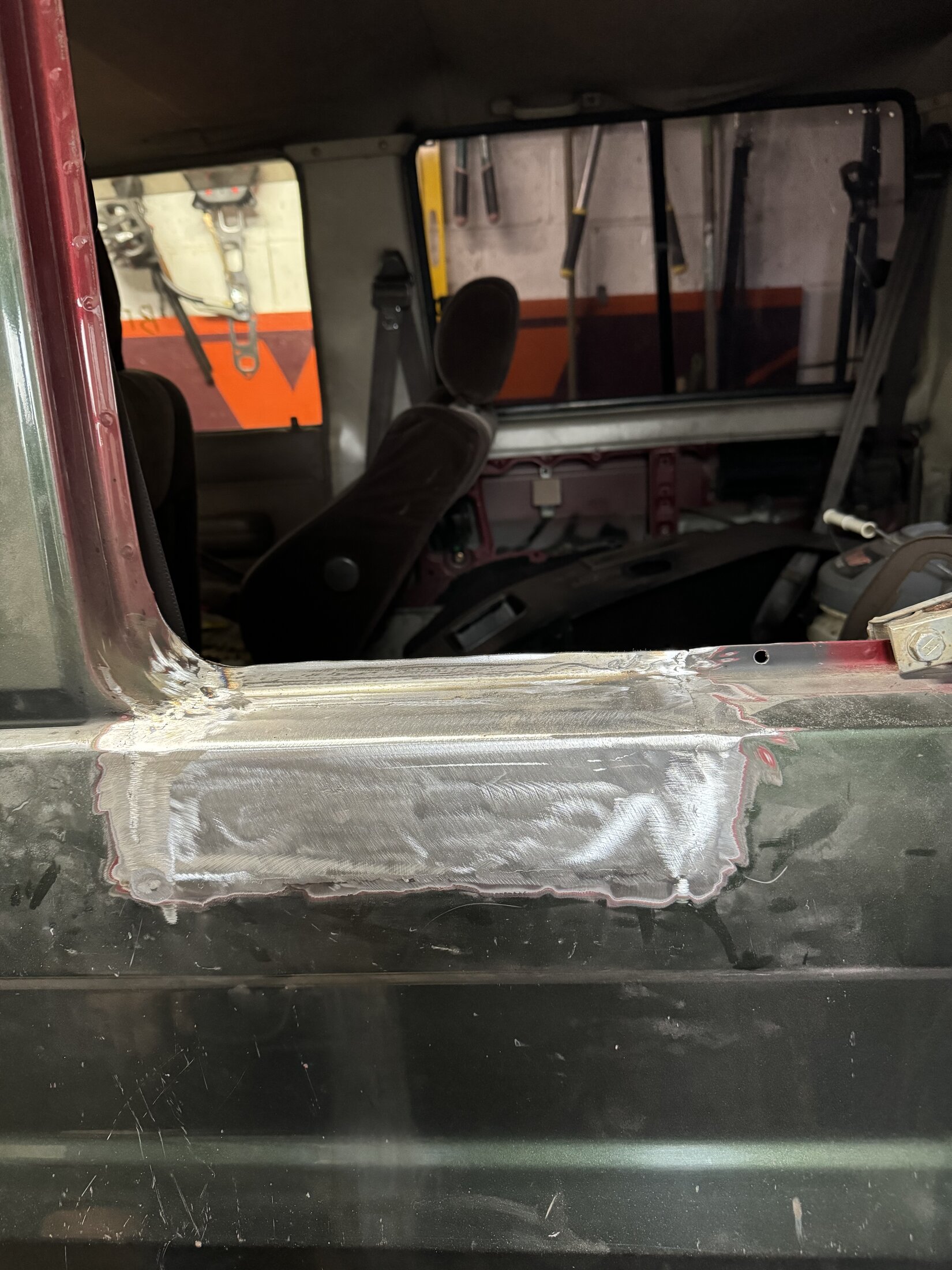

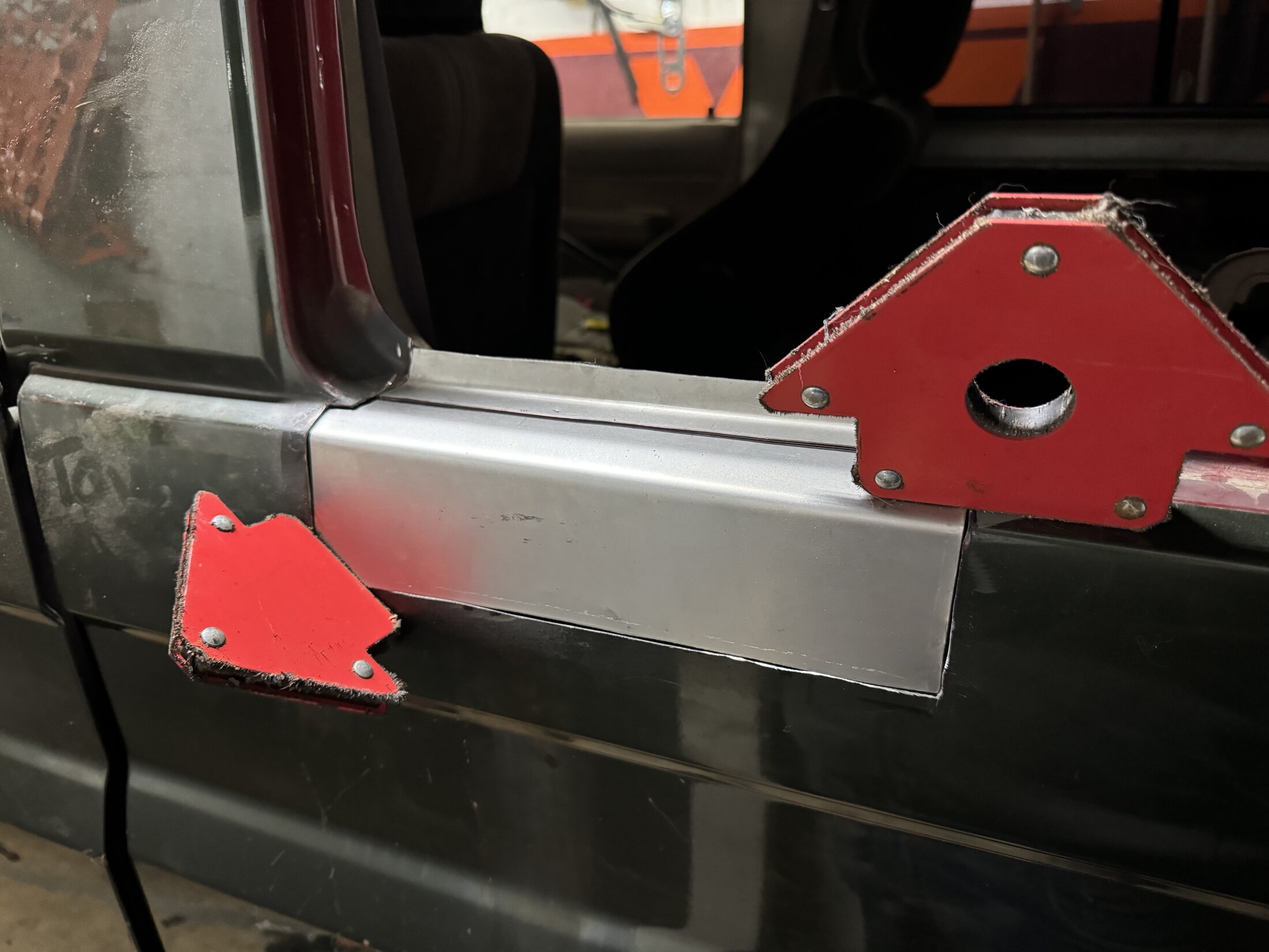

week 2 of ownership I was mostly out of town celebrating our 10 year anniversary. When I got back I pulled the back left window and started cutting out the rust hole there. It annoyed me to look at.
I got a full sheet of 18 gauge sheet metal and started making patches. window was first and only place I’m going to body work well, it’s not prefect but I spent a while getting it straight and body lines are close.

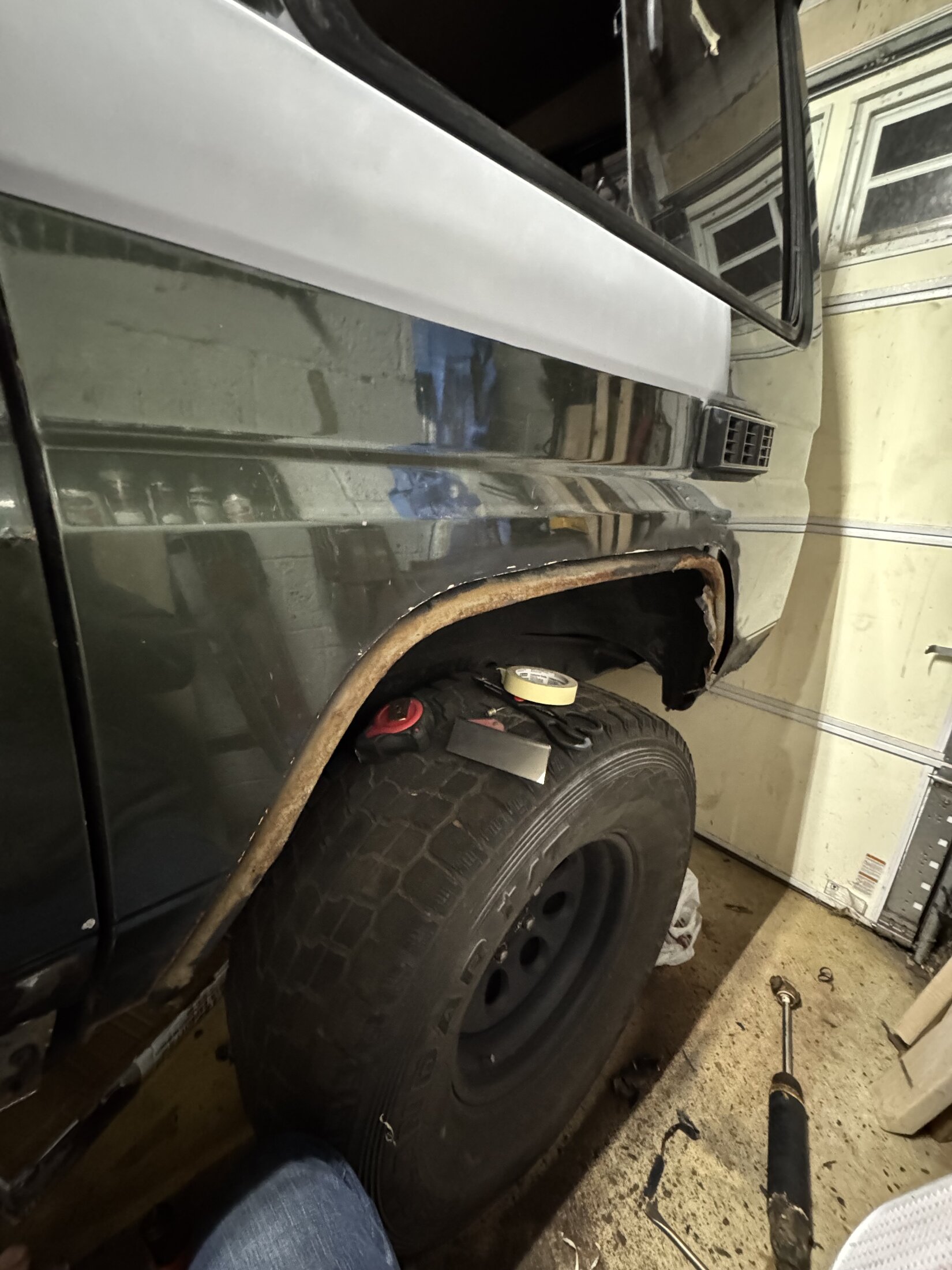

It was basically rinse and repeat of find rust, cut out rust, replace with new metal. Quarter, rocker, radiator support, b pillar,
I haven’t bought any patch panels so far. I did go buy a small sheet metal brake and a set of shrinker stretchers to help make parts. I also got 2 cans of weld thru primer. And has worn out a bunch of flap disc and wire wheels.
Luckily the frame is great it was undercoated a few times. The body got bad especially because it had no mudflaps and they never treated rust once it started, and the seam sealer started to fail.

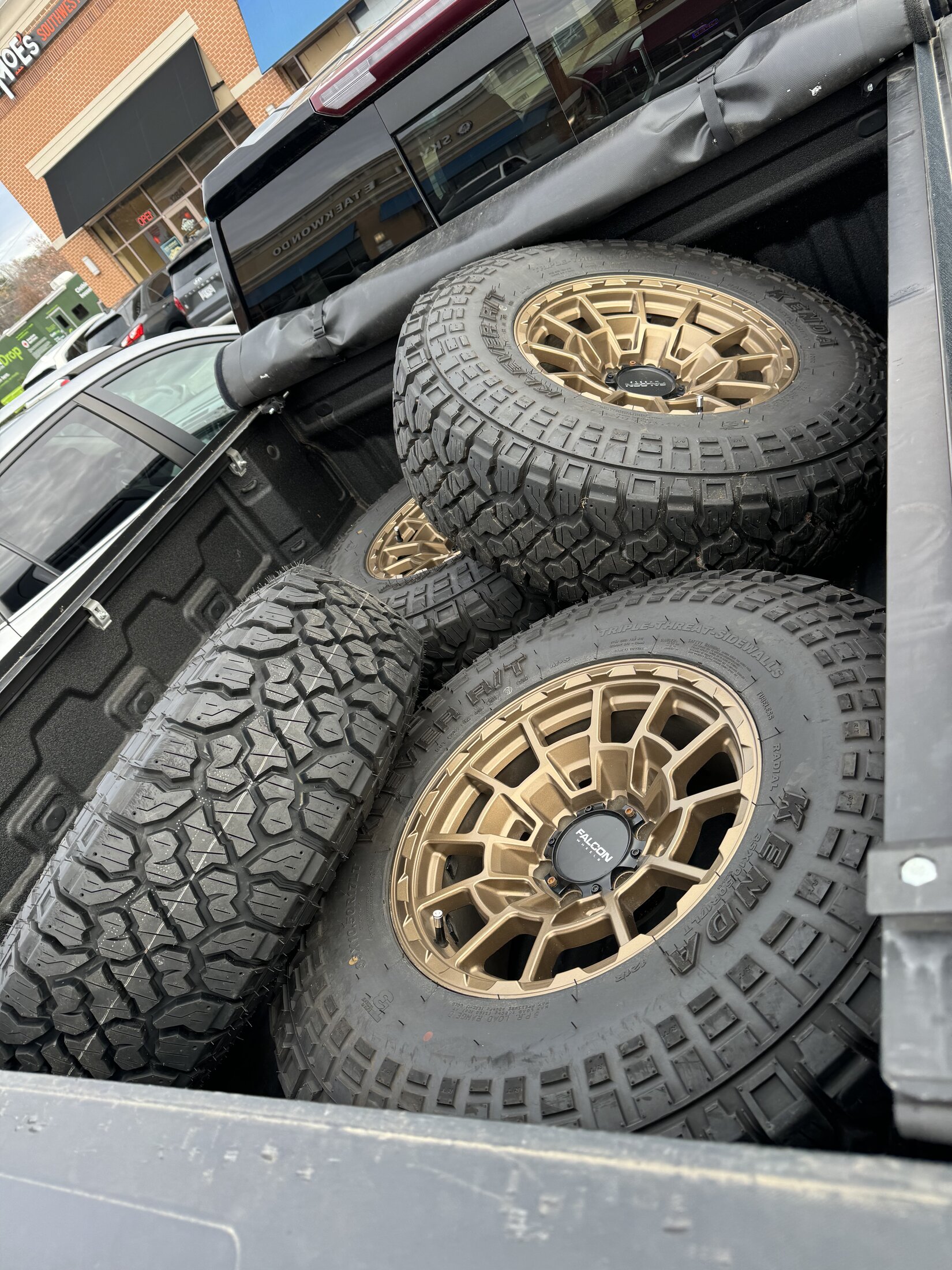

After a few weeks of rust removal and welding I was getting burnt out. I can only work 8PM-10PM most days, was getting repetitive . I’d kept an eye out for some used 35s and a decent deal came up in some Toyota Reps in bright bronze with like new Kenda Kleavers, we met on a decent price for a set of 5.

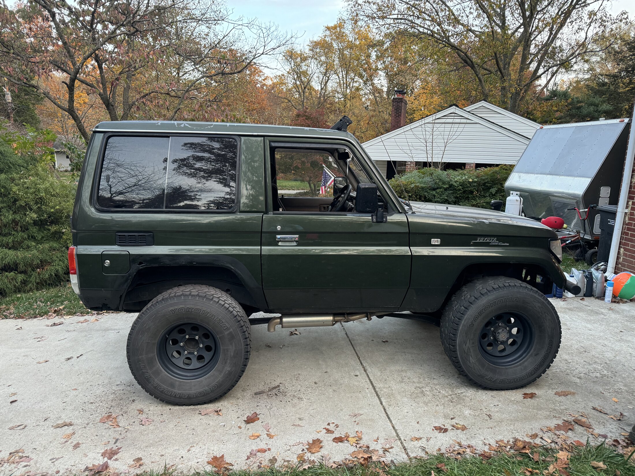

New tires are 17 10.5 (35 skinnies). The truck actually tucked the 315s it had once I removed the spacers but they then rubbed bad on the arms. So this is a good compromise. Poor guy selling them had a 470 and got in a bad wreck and totaled it, wheels were not damaged.
I also got some blacked out LED headlights as the stock lights had been conveyed to halogens and the heat destroyed the housings. I threw on the wheels and headlights for a preview and to motivate me, it worked!

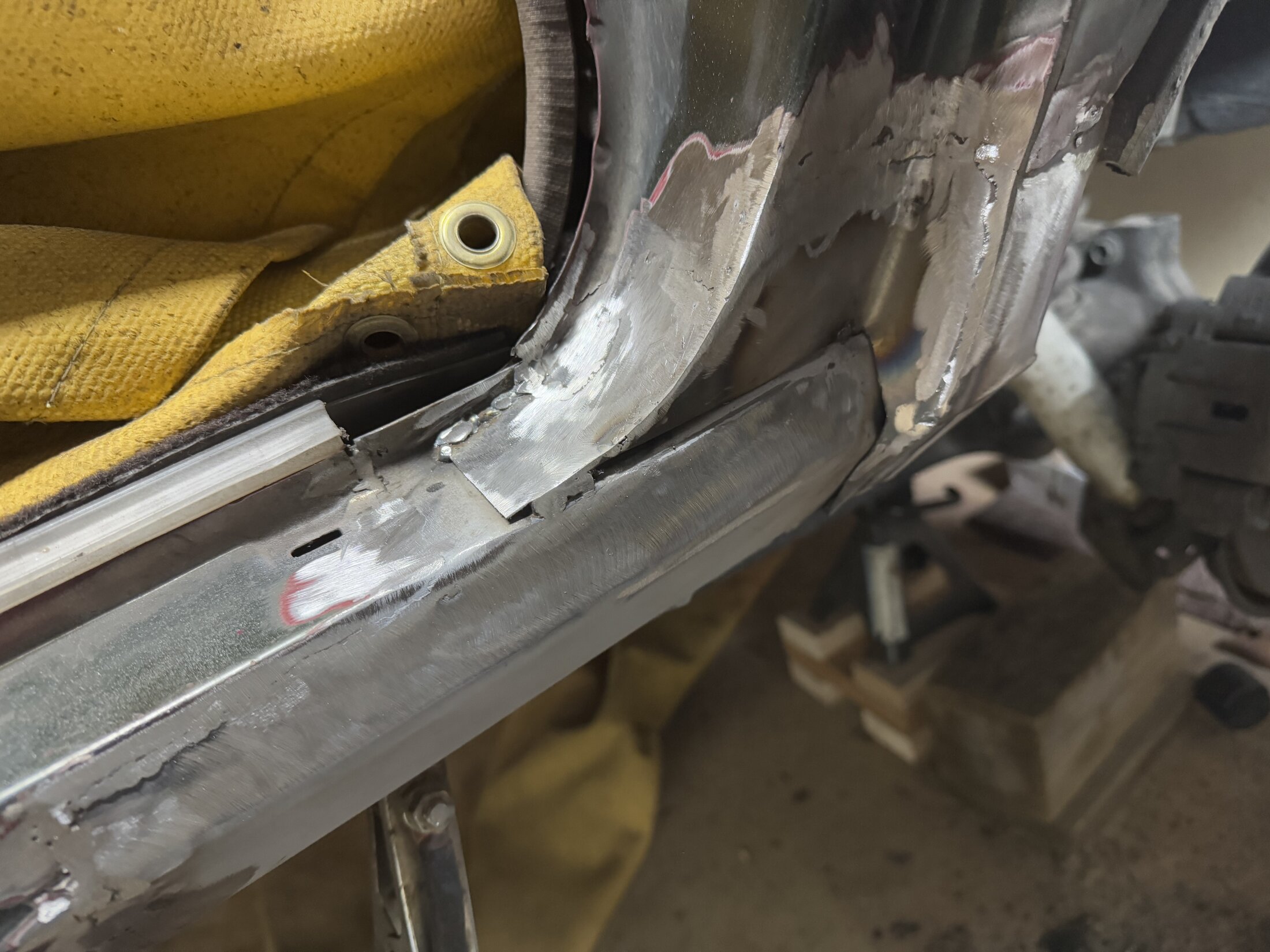

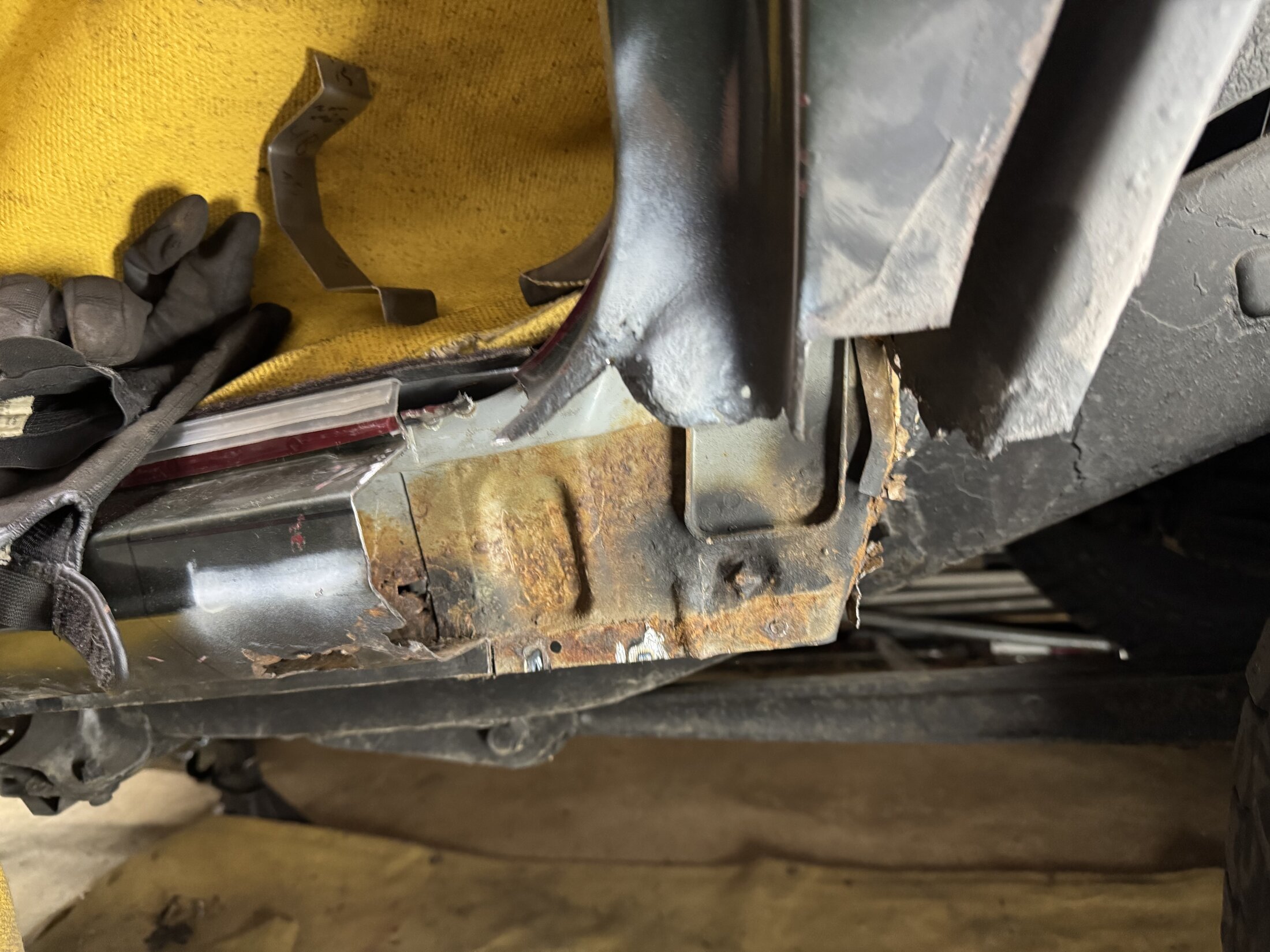

With new motivation I tackled the worst areas of rust. The rocker and B pillar and wheel well lip. I ended up making about 5 parts that get welded, spot welded, or seam sealed in. My buddy has a nice Prado 4 door and sent me pictures of how it should look and what is seam sealed vs welded. It’s going pretty well. I’m close to wrapping up the left (passenger) side.

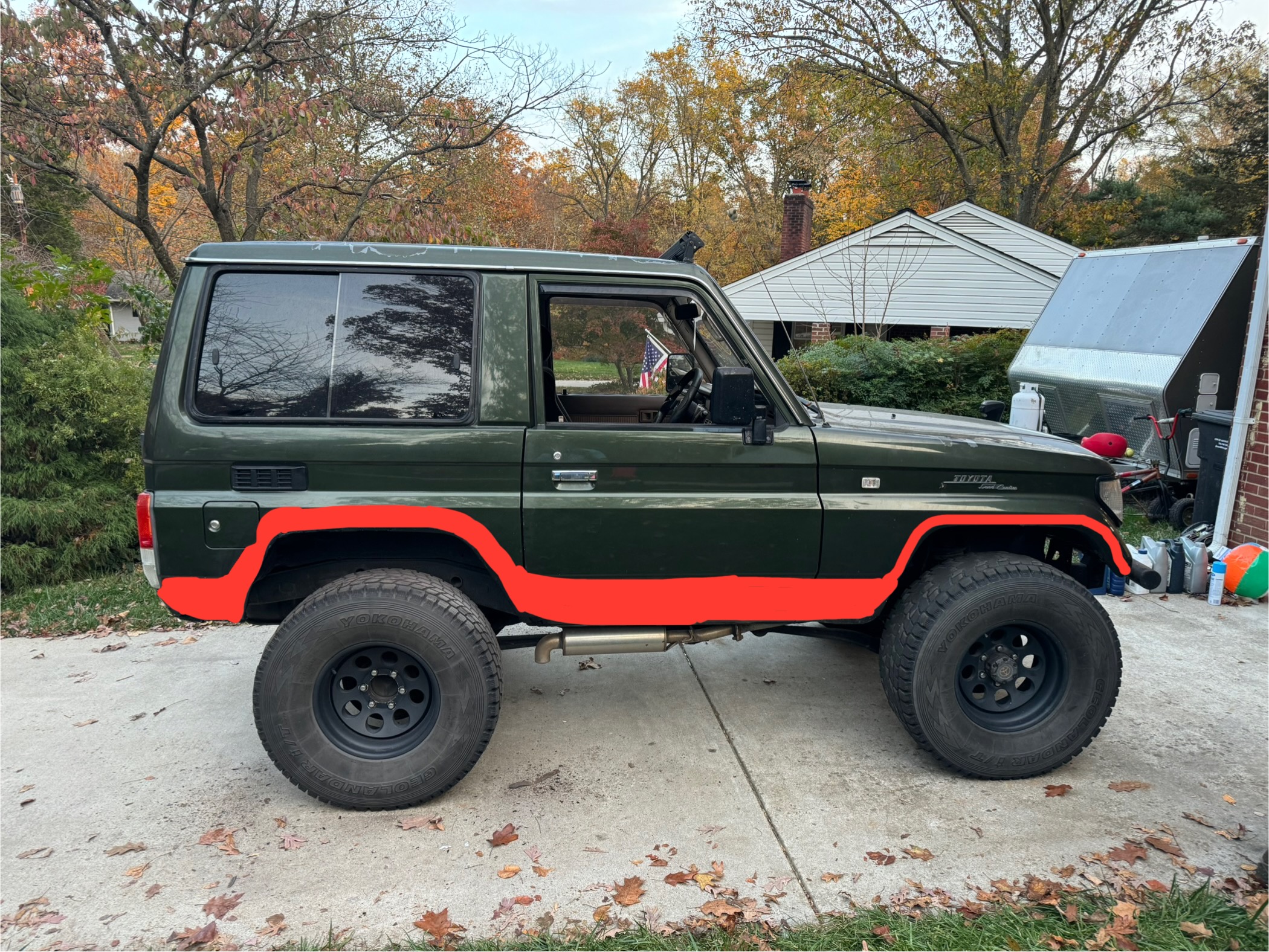

I think the plan is to get to tint-able bedliner and do a 4 inch swath of the rear quarters (up to the body line) and do the bottom of the doors and a 2.5 inch swath over the fenders (to body line). I’ll tint it the body color, kind of a metallic dark forest green (it was red originally). This will keep me from having to bodywork and paint the whole bottom of the body.

Red area roughly shows what I want to do in dark green bedliner. This is the area I’m replacing metal and I think I can make it look OK by using the body lines the break it up.

Inner rocker on left side was pretty good. I patched one area. The rocker to B pillar and quarter area was weird to fix. I didn’t know how to really go about fixing it. A friend with a 78 sent me a pic of his and I tried to copy. It appears it all just spot welded and seam sealed together so that’s how I went about it
