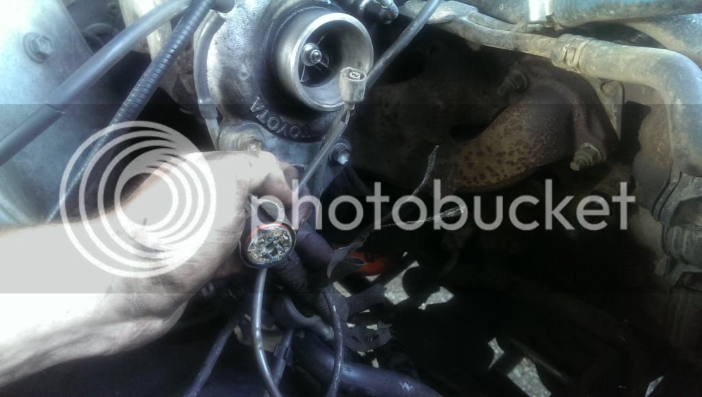

So I just pulled my alternator out so I can take it to the shop tommorow for a rebuild I found some extra wires..
Anyone know what the one single wire plus and the 2 cut wires are for?

I would really appreciate that GTS. I am wondering if those wires are contributing to my warning lights acting up. Like maybe they need to be grounds? Or maybe they are touching together and causing problems. I don't have AC anymore as the PO cut it all out. (kinda wish I had it but now i have a big Volvo inter cooler that will fit just right)

OK, so the wire right in front of the turbo inlet in your picture is (as someone said) the A/C clutch wire.
The two wires lower down by the exh manifold (in your picture) on mine connect to what looks like the oil pressure sender? near the back bottom of the block, right by the bell housing on the exhaust side of the engine.
