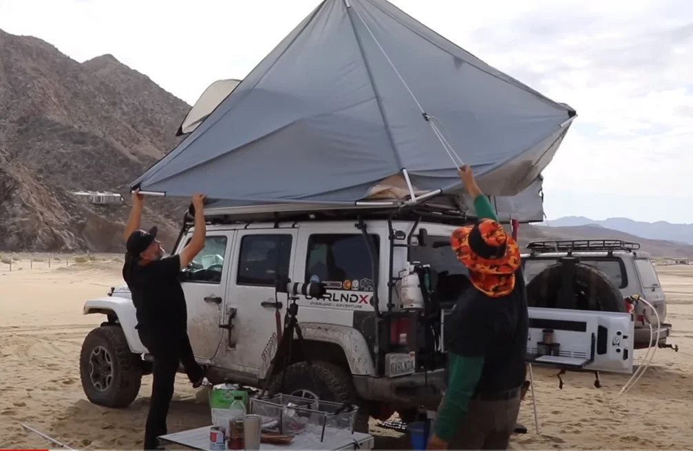

Looks nice.. and I have not used it; but from what I can see, I would be worried about it folding over with a breeze. Doesn't seem to have any tie downs.
I think it would need to be a calm weather day when used.
Like this:

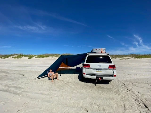

Most of the places people go camping and off-roading are subject to wind - mountains, beach, etc. I've been in regular RV parks where its been a beautiful day and the wind kicks up and everyone's awnings from cheap Winnebagos to top end Airstreams wind up looking like hang-gliding accidents. Expensive awnings are expensive (and heavy) for a reason - they are better suited to these potential conditions. Also, the good ones like Alu-cab's shadow awn deploy and pack up quickly. The draw back as you have zeroed in on is cost and weight.
I have the Alu-cab, but for a day on the beach I usually go with a Kelty Noah's tarp affixed to the roof rack and staked down with ground grabba sand anchors. This makes for a nice shady area on the leeward side of the truck out of the blowing sand making an otherwise miserable beach day workable.

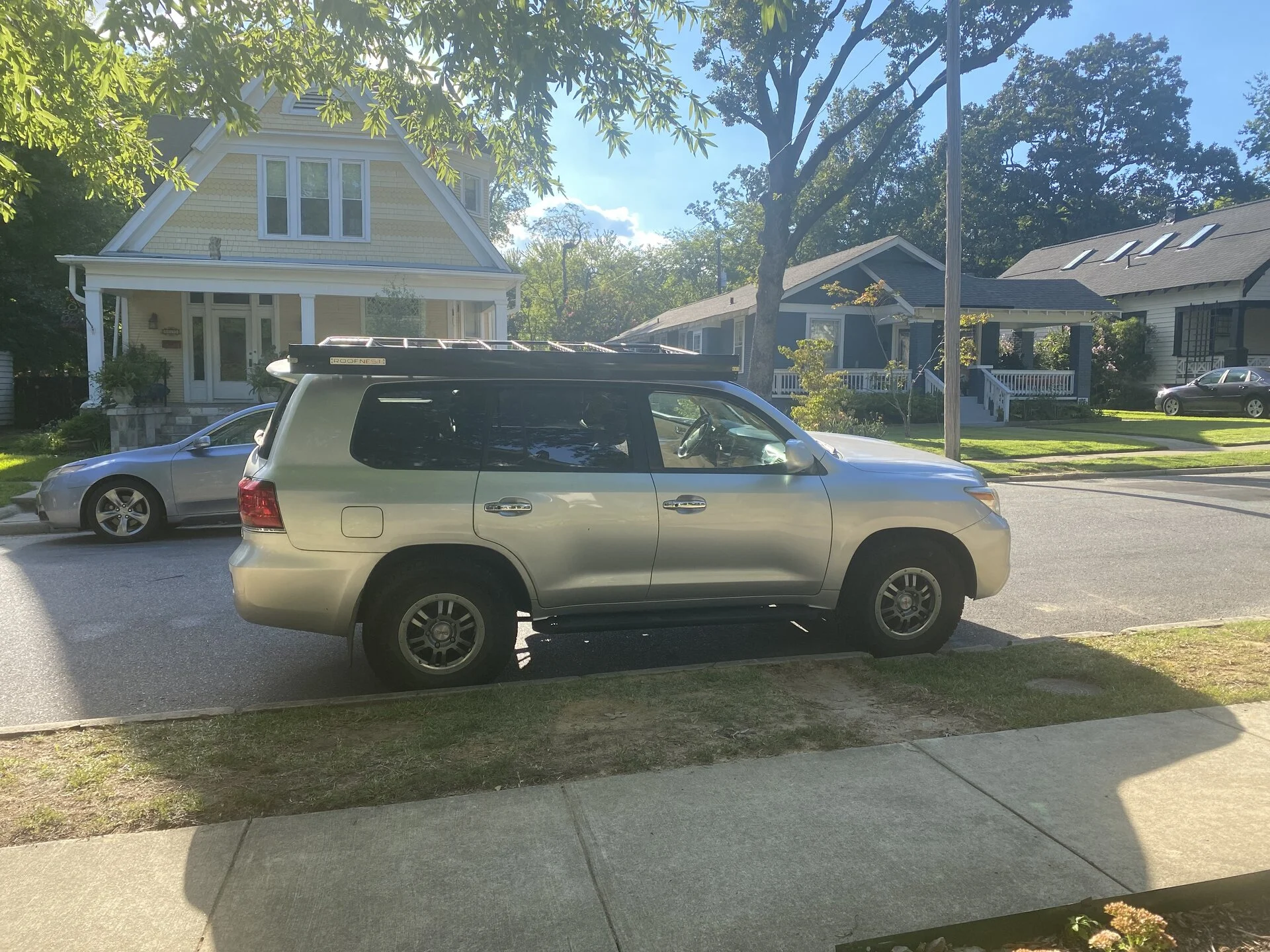

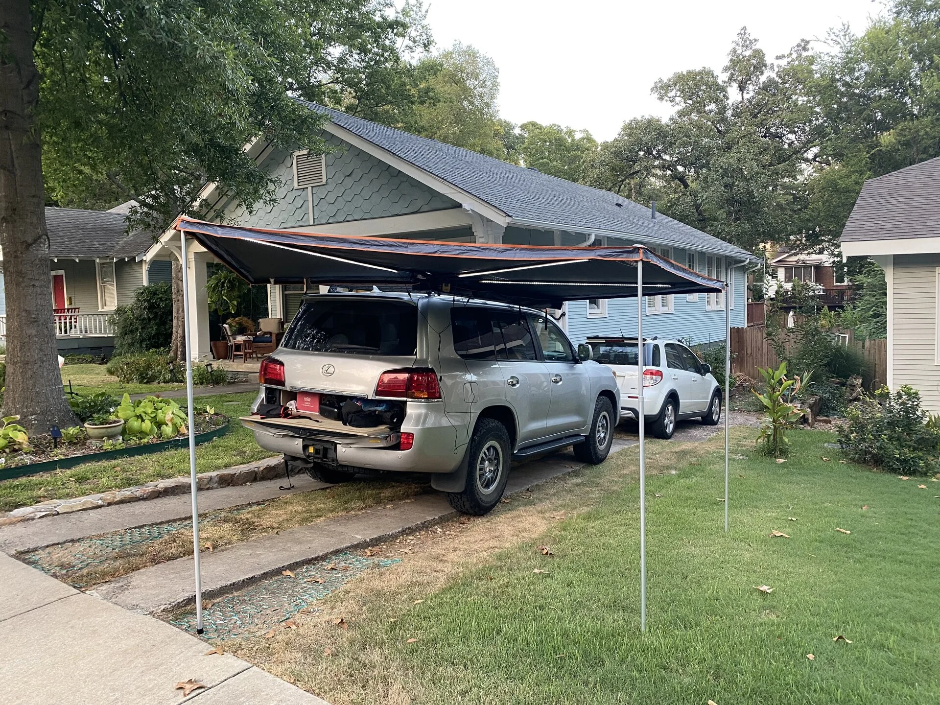

I have a Litewing XL. I haven't used mine yet, and only had it installed temporarily. I will say with what little I've used it, I'm not super impressed. It feels pretty flimsy up on the rack. This may have to do with being the XL model and not the standard length. Also, I was using 2 Gamiviti rack recievers to mount it, based on weight should be fine, but the length of the awning and the flimsiness of the metal structure that holds the awning made me not like it. I decided to go with a 3 point of contact system and ordered the Gamiviti rack arms and awning adapters. I haven't finished installing these yet, so don't have a good review of the awning with that mounting system.
I also have zero experience with other awnings to compare to the litewing, so maybe they are all similar. But seeing videos of buys hanging from the bush co, make me feel like it's considerably more stout (at 2-3x the weight).
It's also very concerning that there are no reviews anywhere for the awning. A few members of the Roofnest owners' group on FB will mention that they have them, but no reviews and if you try to post in that group for real life data, you never get any responses.
The awning does come with poles/tiedowns and built in lighting.
Here are the 2 pictures I have.

I've got the Roofnest Litewing XL installed now with the new mounting system. I'm much happier with how sturdy it's connected to the rack now, using 3 points of contact. Still need to see how it works in practice. Also, the door that flips open on the side is probably going to need to be modified to clear the hatch. Either that or the awning will need to be mounted higher than I think I want to.
Initial impressions have me thinking you definitely won't be using this awning without the poles. Just too much droop at the hinge area. Might be able to get away with only using one pole, but I'll have to play with it to see what works. I went back and looked at the ad copy since that seems to be all that's out there. The static images must be faked, as they show the awning somewhat defying gravity. In the promotional video it looks a little more realistic. I'll check how mine hangs verse that one and see if it droops considerably more.
